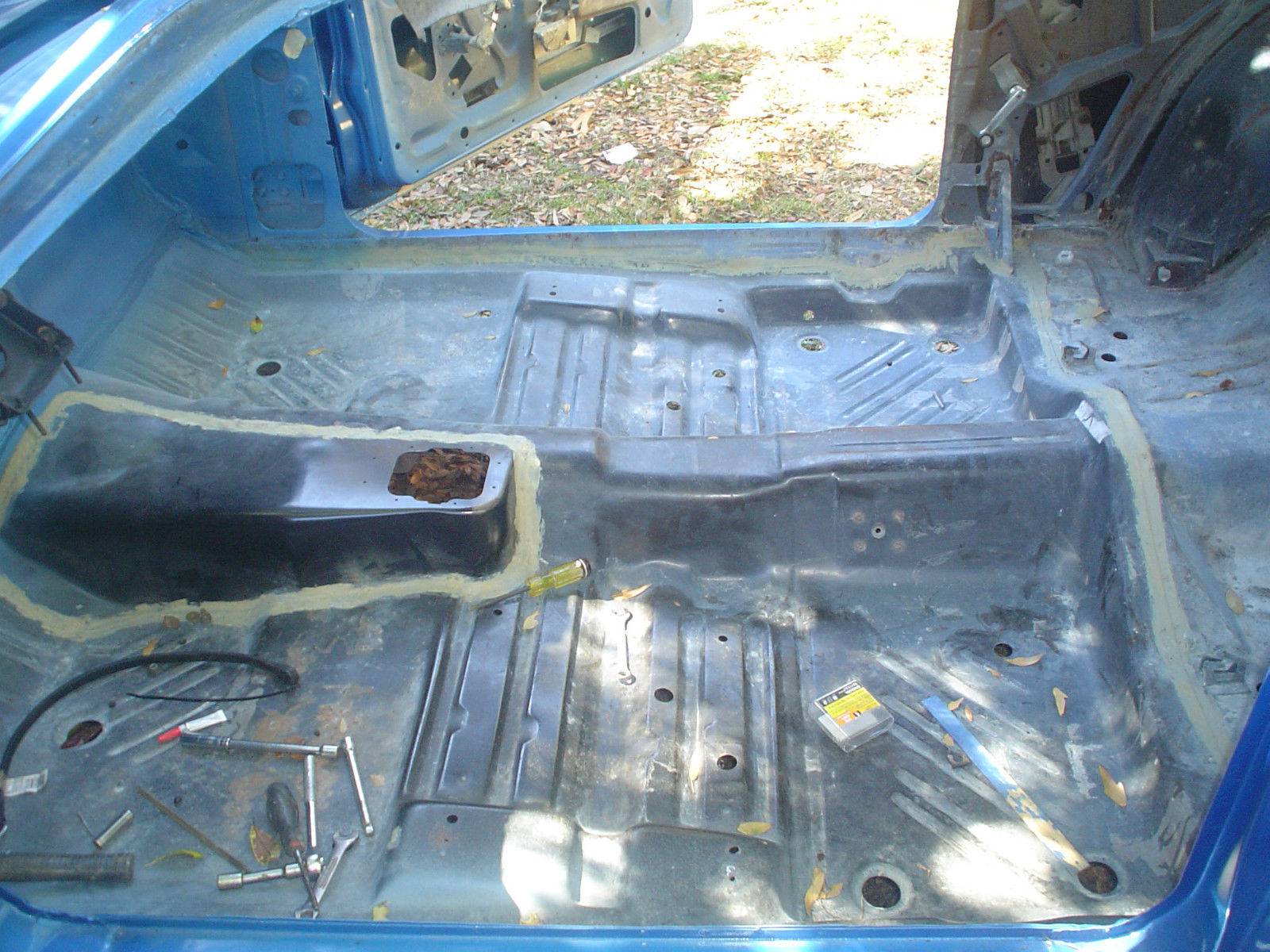

Does anyone know where the rear seatbelt outside anchor points are? I think 70 & 71 use a bracket mounted on the wheel well but where does a 73 go?

They are square nuts that are welded to the floor, I cut them out and rewelded them on my 73 bc I mini tubbed it. Obviously there are 4 of them, 2 near the wheel houses and 2 by the trans tunnel.
Challenger RTA
Oct 28, 2018
2,694
1,357
PA Flood city
Does this help?

Yes, thank you very much
Hey Quiny do you have any pictures of the rear seat belt retractor anchor holes are ? The body guy who replaced my floor pan must of forgot to replace the nut for the rear seat belt retractor closest to the rear wheel .
