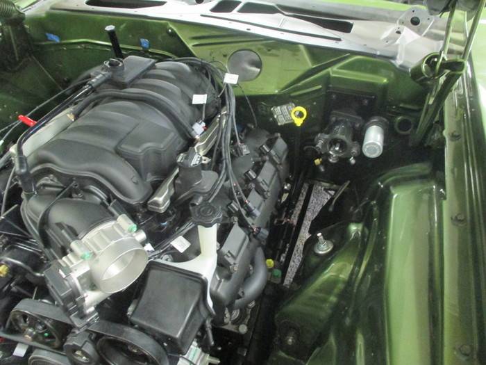

My SRT 6.4 engine had the dipstick in the pan, which has been changed. I knocked the plug outta the block[left side] for access to the replacement oil pan.....
Which dipstick works well for this conversion? I have custom built headers, if that's any concern. Does a truck or Jeep have the left side dipstick? I can re-bend the tube if needed.
Thanks, mike.

Thanks. I'm wondering if there's a factory one for the left side? I'm doing a "factory" look to my install, if possible.

I ordered a new 6.4 RAM dipstick. I re-bent the tube, re-located/welded the bracket, and powdercoated it... to make it fit around the custom headers. It looks like it came that way.
