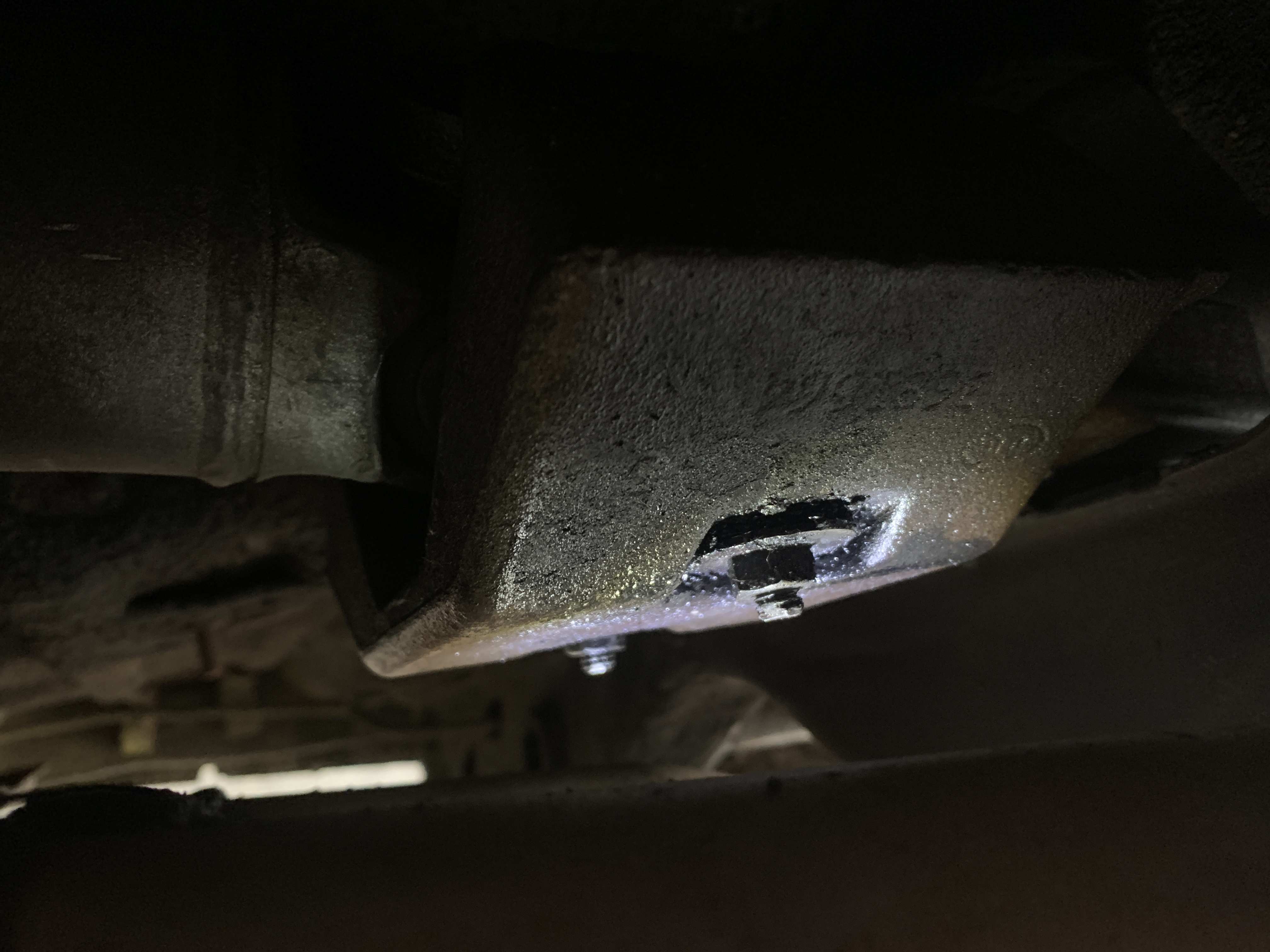

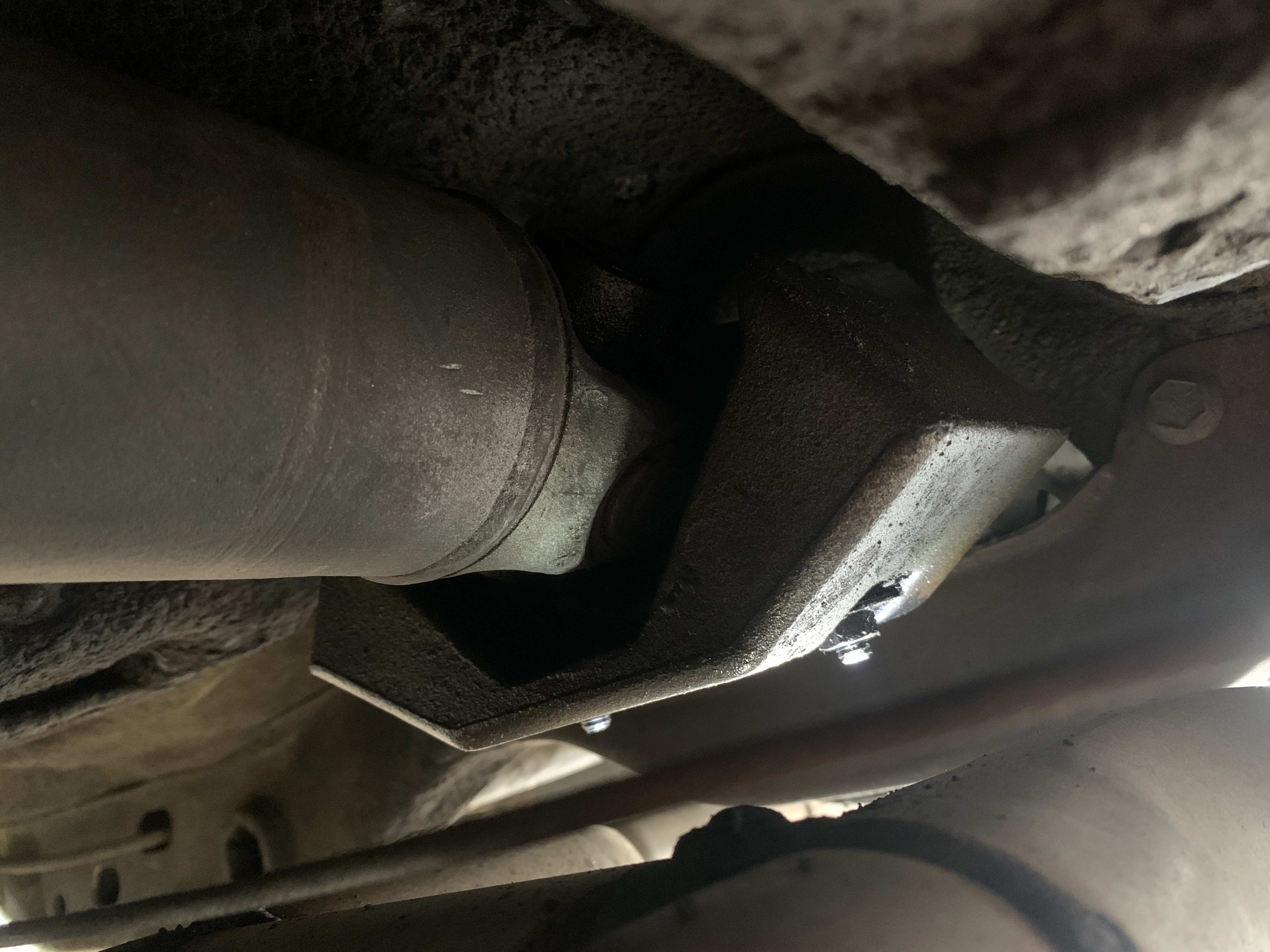

Hi All, sorry for the delay, the 3 pics show a “support”? Below the yoke area. This is the loose part. I looked in service manuals however can’t locate.

It's a vibration dampener, kinda like the harmonic balancer on the front of the engine. Personally this is the first one I've seen on an A, B or E body. Usually only see them on luxury cars, trucks and vans. Then again, most people probably removed them before I came along on muscle cars if they had them. It probably weighs 5 to 10 pounds! If you remove it and don't notice any new vibrations, I wouldn't bother putting it back on!

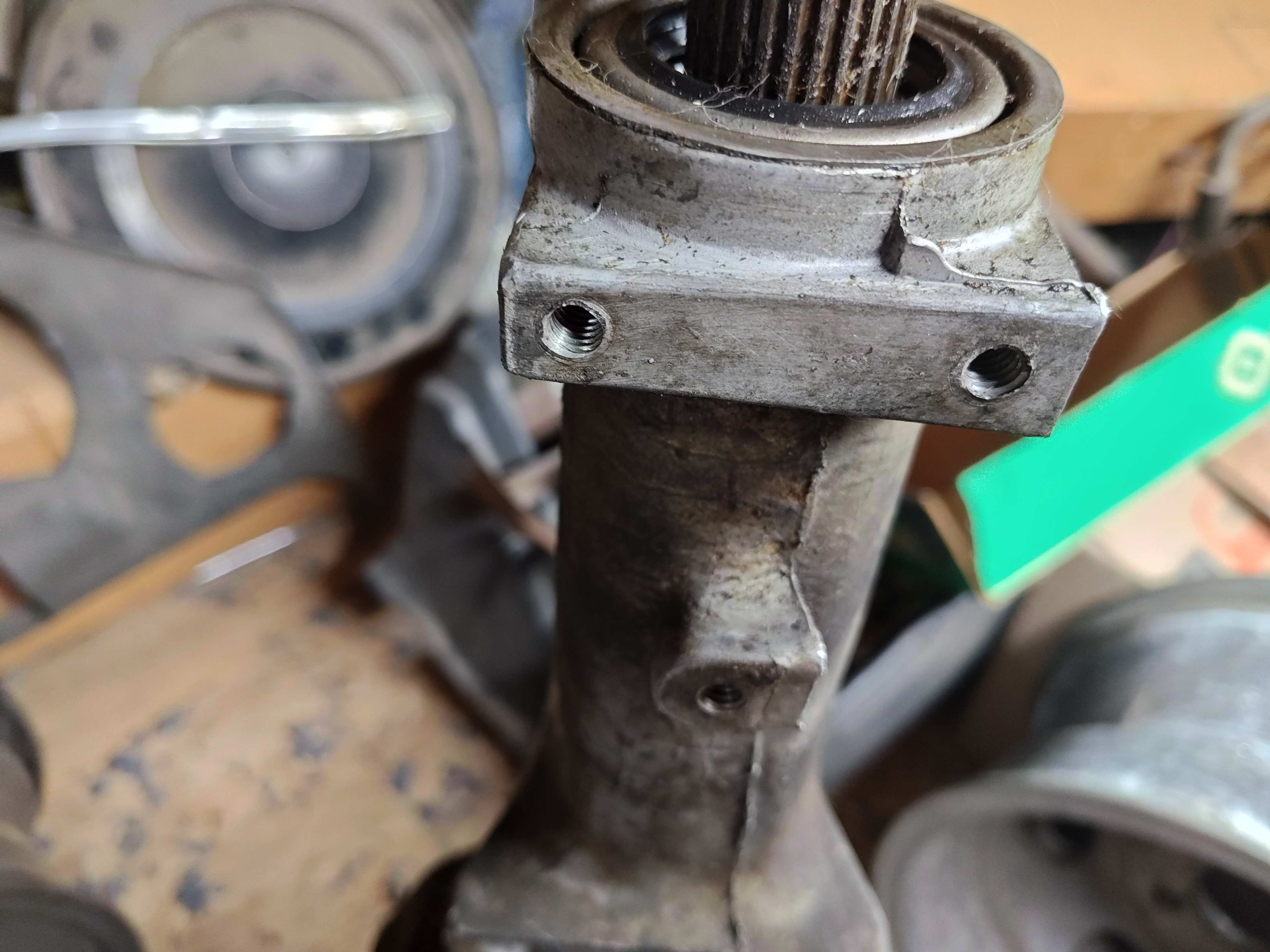

The tail has a boss near the dust shield/rear shaft seal. That boss is drilled and tapped on ones that have the dampener.

I forgot to post this picture. I checked my generous stash of automatic transmissions and it seems all the 904 tail housings have the boss pictured below. None of my ten or so 727 tail housing have holes. So maybe it's a 904 thing?

518 tail shaft is different altogether. It has the two holes similar to the 904, plus two holes sticking out. on ears and the three holes the mount for the cross member mounts to.
