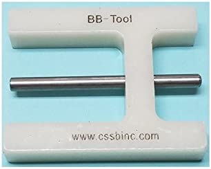

That being said, a problem that was mentioned and may need to be checked is the brake booster rod to master cylinder piston clearance. I thought mine was okay but when checked it was almost 1/4" gap between the booster rod and the piston. I ended up buying one of the better tools HERE. Adjusting the brake booster rod to about .020" made a serious pedal feel difference.
Not saying yours is excessive but something else to consider if you continue to have issues.

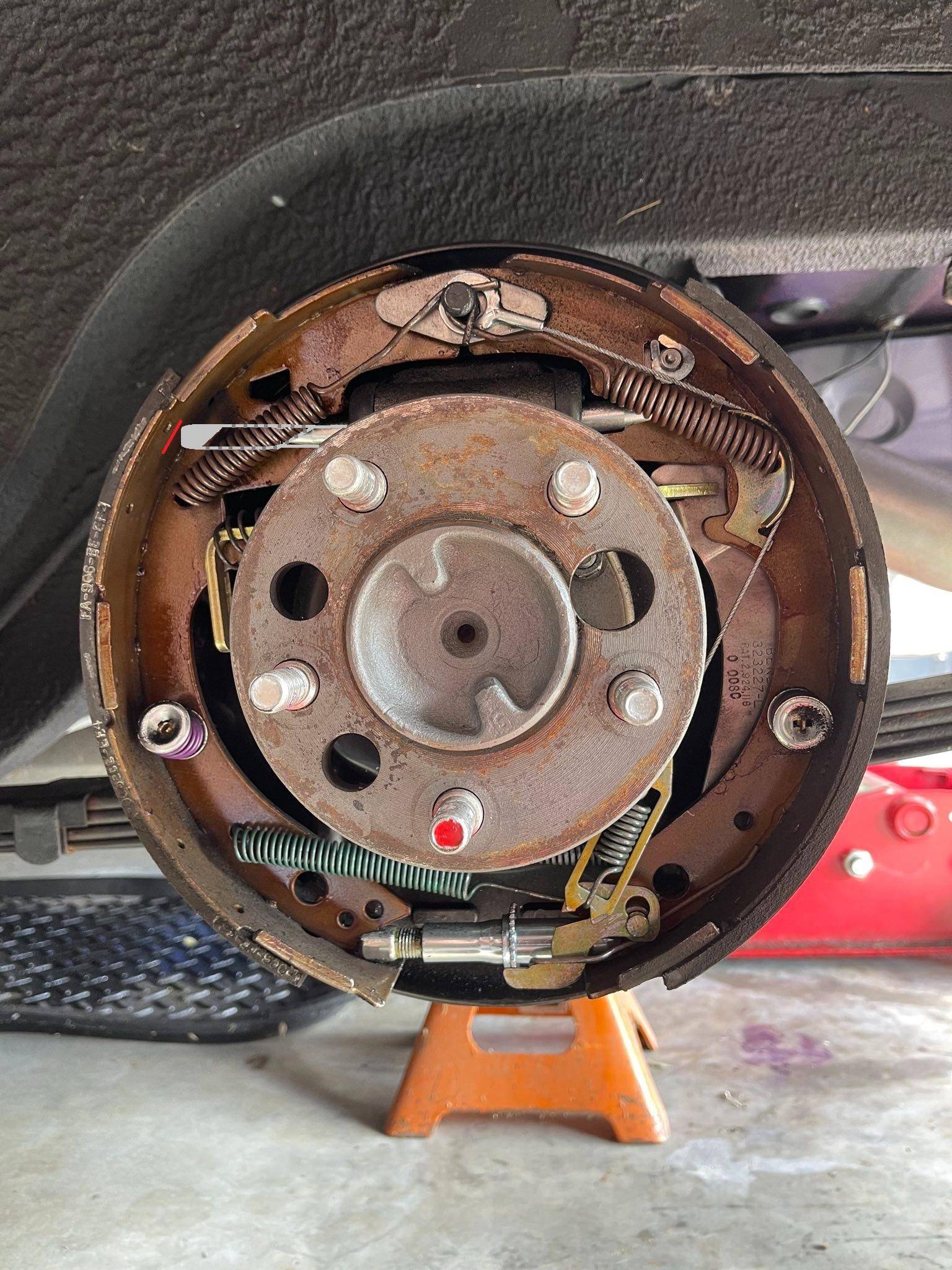

I had a mushy pedal after I finished my Cuda's restoration. I theorized it was due to a lot of different things. Big cam/low vacuum, air in brake system, bad master cylinder, etc.
After actually troubleshooting and checking the rear brake shoes, I found that the driver side rear wheel cylinder pin had come out of the shoe and was not expanding the brake shoes. The pin was extending over to the curved metal portion of the shoe and the spring was holding it in place under spring tension. This simulated a mushy pedal as the wheel cylinder piston was expanding with no resistance. After adjusting the shoes outward and putting the cylinder pin back in place, the pedal was solid.
In troubleshooting, I was always told "visual first". Certainly held true for the problem above so I agree with Gary on checking your rear brake shoe adjustment as well.
BELOW: A picture of my actual rear drum brakes after I put the pin back in place.
Marked up to show where the cylinder pin was hitting the RED line area and slipping down under the spring tension.
