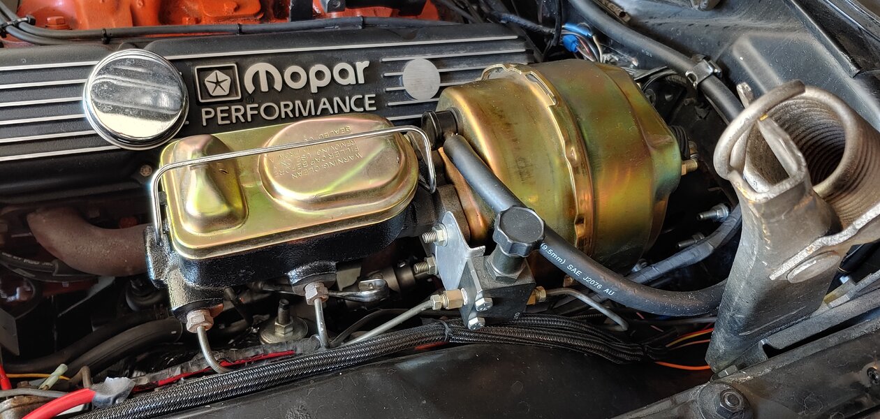

rklein71
Feb 27, 2015
1,165
529
Amarillo Texas

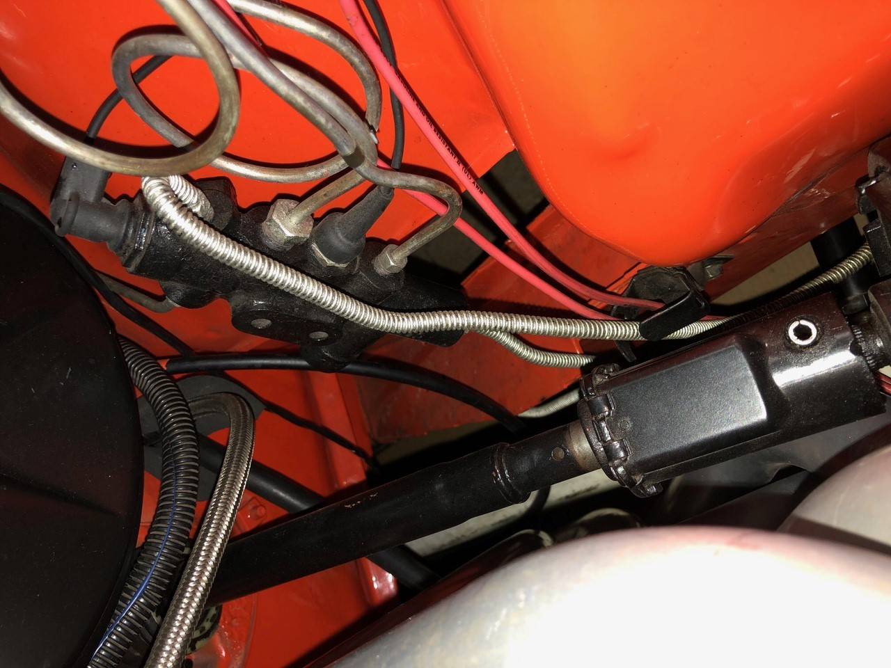

This is where I put mine, below master cylinder to kind of hide it but still accessible from the top. I made a bracket to stabilize the proportioning valve after the picture was taken.

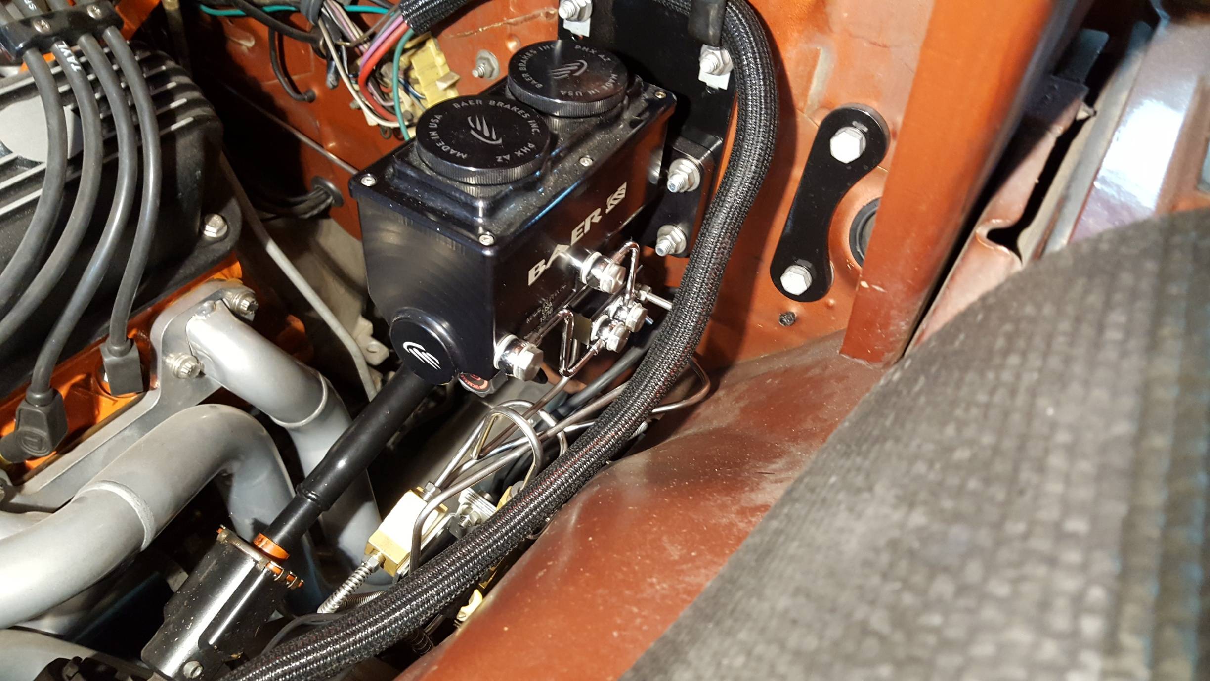

DaveBob
Jul 24, 2020
71
43
The factory proportioning valve is on a frame rail, below and forward of the driver's seat. I replumbed the system, as part of a four wheel disc conversion, and used a solid line front to back to eliminate the valve and replace it with line clamp. I then added an adjustable proportioning valve below the master cylinder, thanks to the design of the master cylinder I used. The Baer master cylinder has a mounting location for their valve, just below the cylinder. Then, the trick is custom fabricating the lines that fit, don't leak and tie the new and old parts together.

Badfishy
Mar 6, 2021
14
Florida
Rod
Hi rklein71, it looks as if you have an adjustable prop valve in addition to the prop valve built into the distribution block? Did you “gut” the block, or running both? Curious to know if this combo works well?
I’ve got rear brake lock-up after changing to a modern aluminum Mopar master cylinder (same bore as original) and braided brake lines. Looking to simply add the adjustable valve without gutting the stock valve.
Thanks!
rklein71
Feb 27, 2015
1,165
529
Amarillo Texas
Thanks!
I did not gut the internals of the distribution block. Honestly, I have not had a chance to really play with the proportioning valve I installed. I basically have it wide open for now so it isn't functioning. I wish I could be more help. I have been building a shop the last six months and just have too busy to really work on my Barracuda.

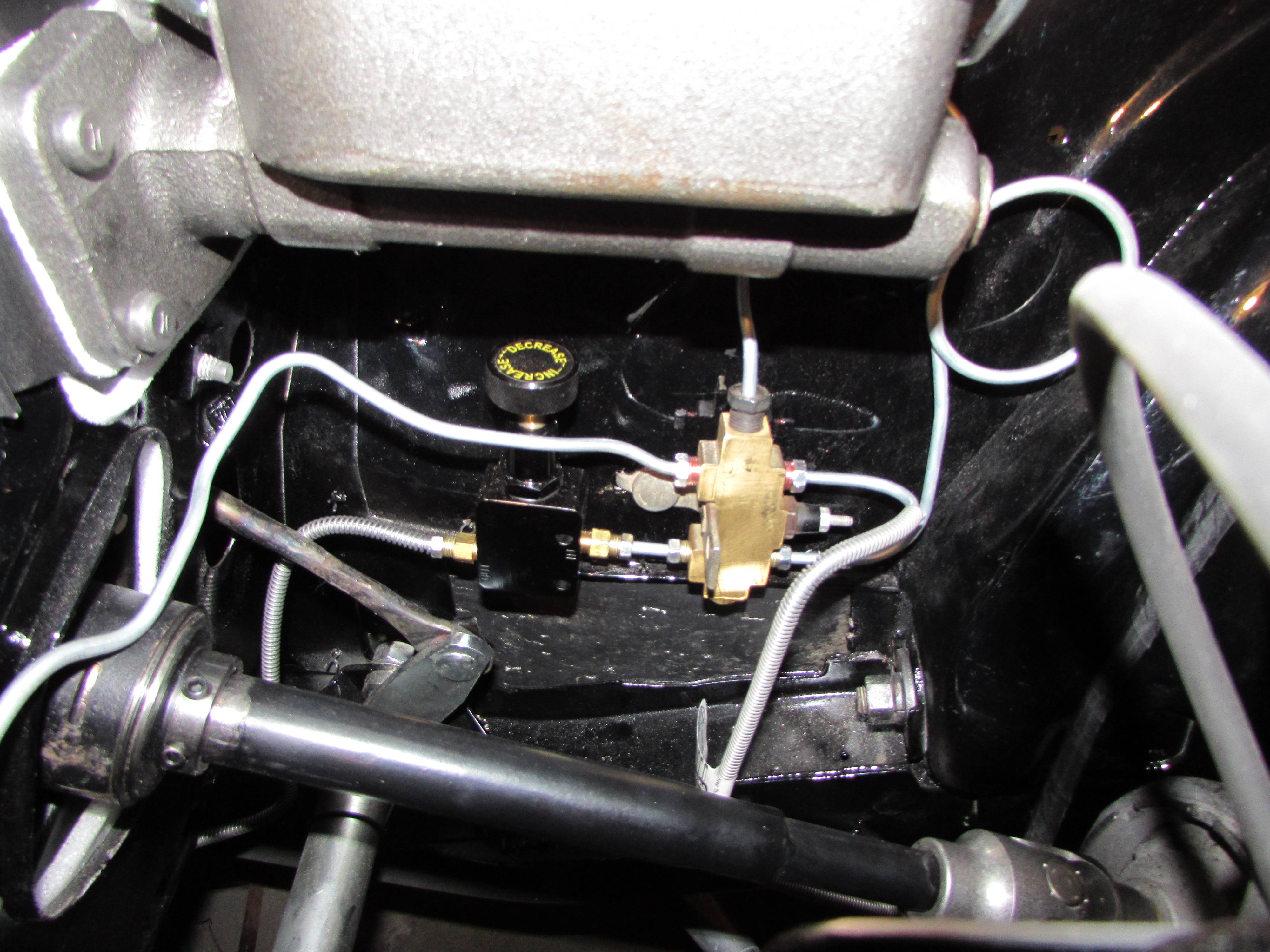

Iguana
Nov 27, 2020
47
17
Auburn, ca

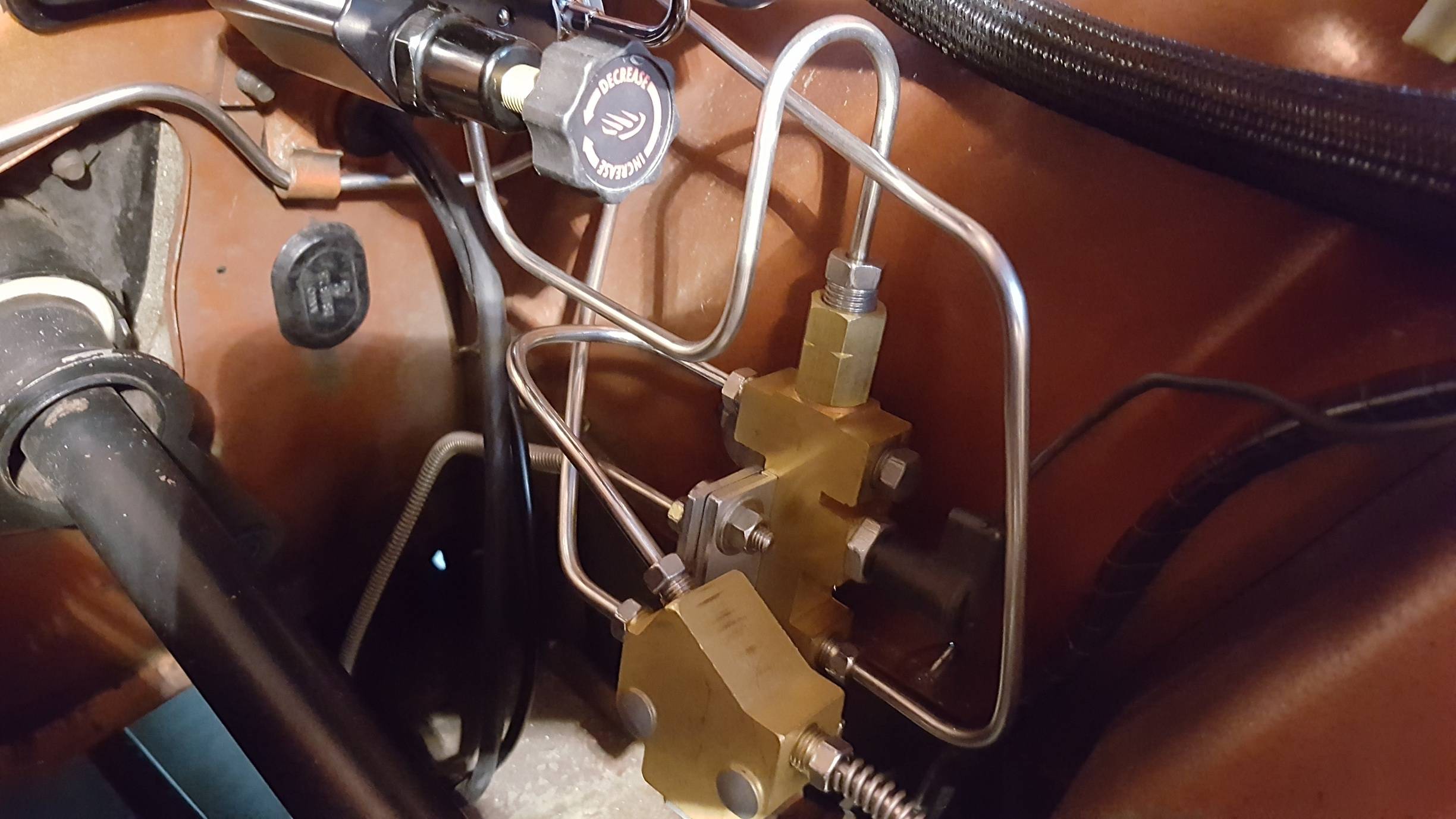

Here is where mine ended up on my 72.

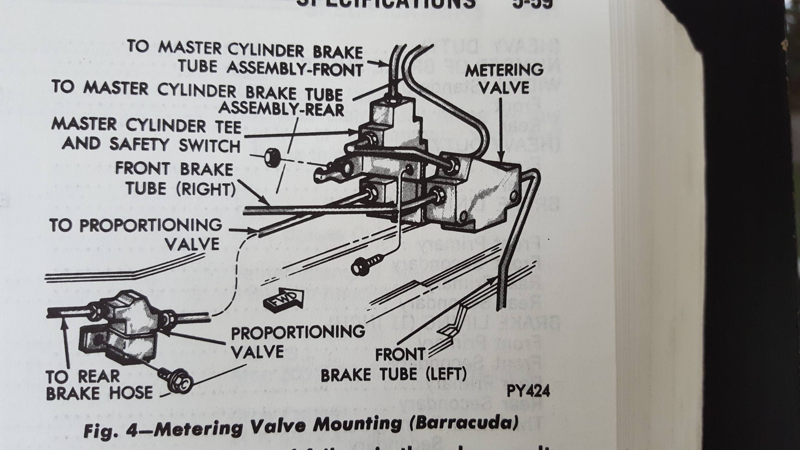

Badfishy
Have a look at what DaveBob posted.
A metering valve, distribution block and a proportioning valve are not the same thing and do different functions.
The factory service manual describes what they do better than I can.
