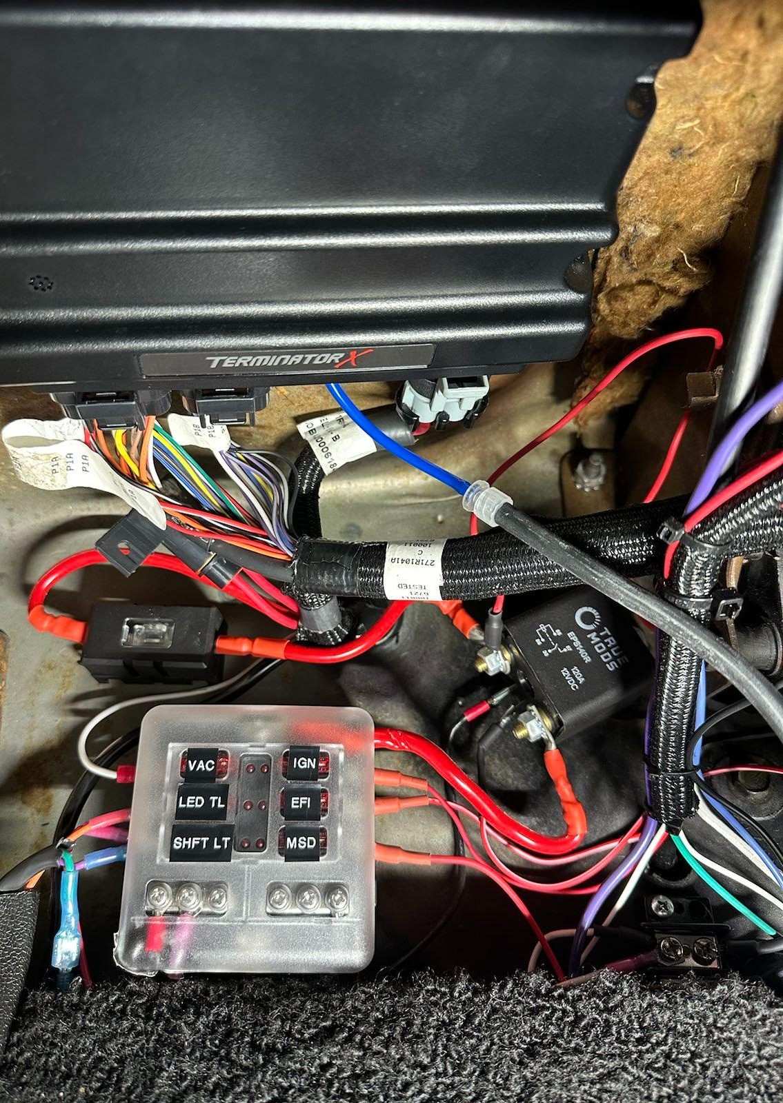

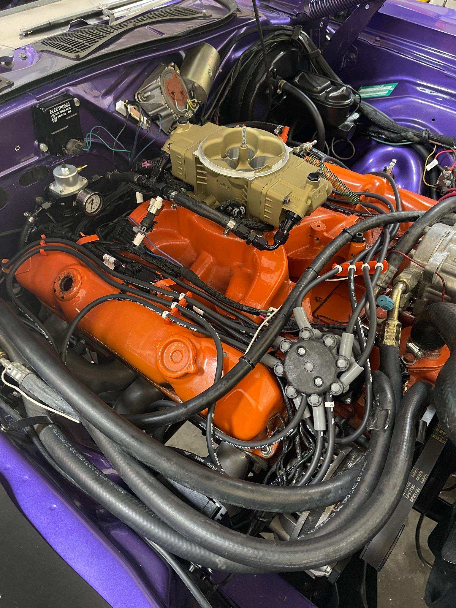

I totally agree with @Sal C about the Terminator X Stealth. Mounting the ECU under the dash is ideal. No RFI issues when ECU is remotely mounted with clean power.
Picture below is my auxiliary switched power fuse panel which supplies power to the EFI and other accessories plus an engine shot.
VAC - electric brake vacuum pump (hidden under battery tray)
LED TL - Digi-tails LED taillights
SHFT LT - MSD Shift Light (on steering column)
IGN - Hyperspark Ignition Box (interior at firewall above driveshaft tunnel)
EFI - Terminator ECU Box (directly above Aux Power
MSD - Tachometer Adapter to factory Rallye tachometer
