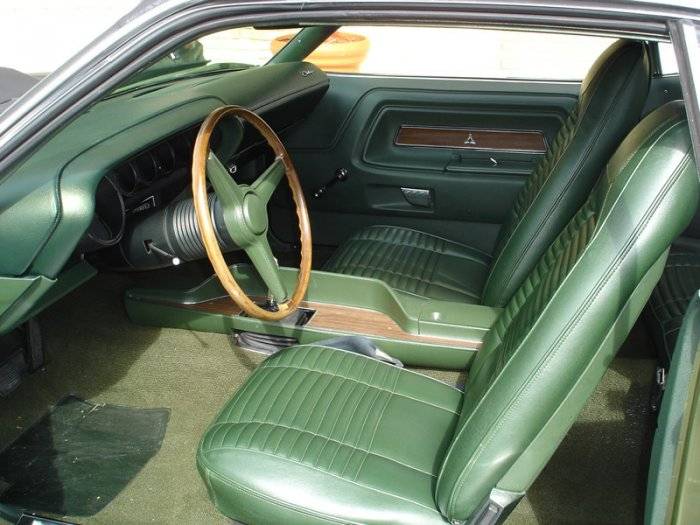

On the 70 Challenger RT, the green interior would have green colored dash pad, with the metal frame painted, and steering column in a subdued green color.

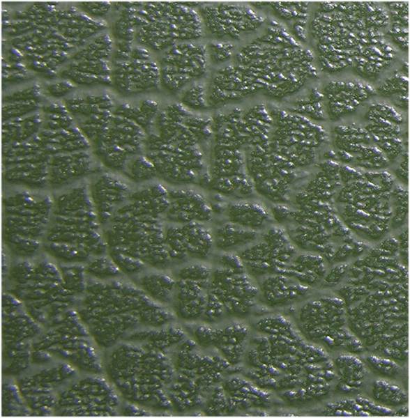

Legendary does sell a green vinyl top for the Challenger.
70/74 CUDA & 71/73 CHALLENGER VINYL TOP - GREEN BOAR
VTL1BJ13
$282.00
