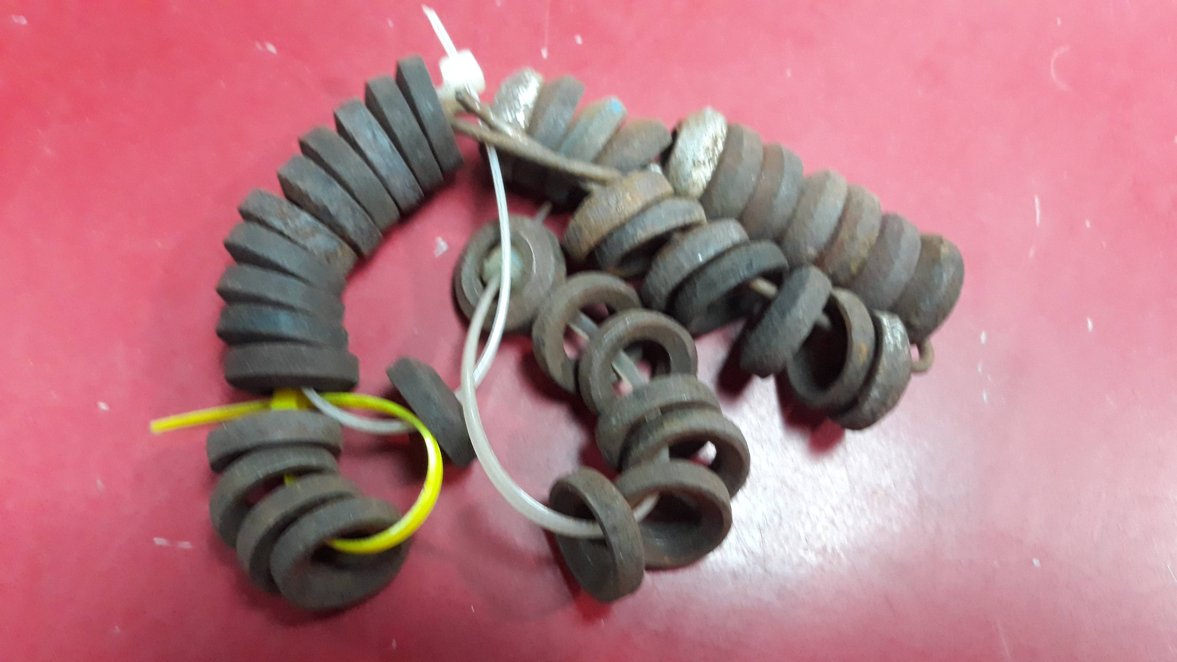

What is the purpose of the conical washers used on the exhaust manifold? Are they supposed to be on all bolts and studs? Can I use regular flat washers or lock washers? When I bought my engine it didn't have exhaust manifolds. I saw the washers in the service manuals. Thanks

I don't know the answer ,but if it comes down to you needing some I know who has a bunch !
