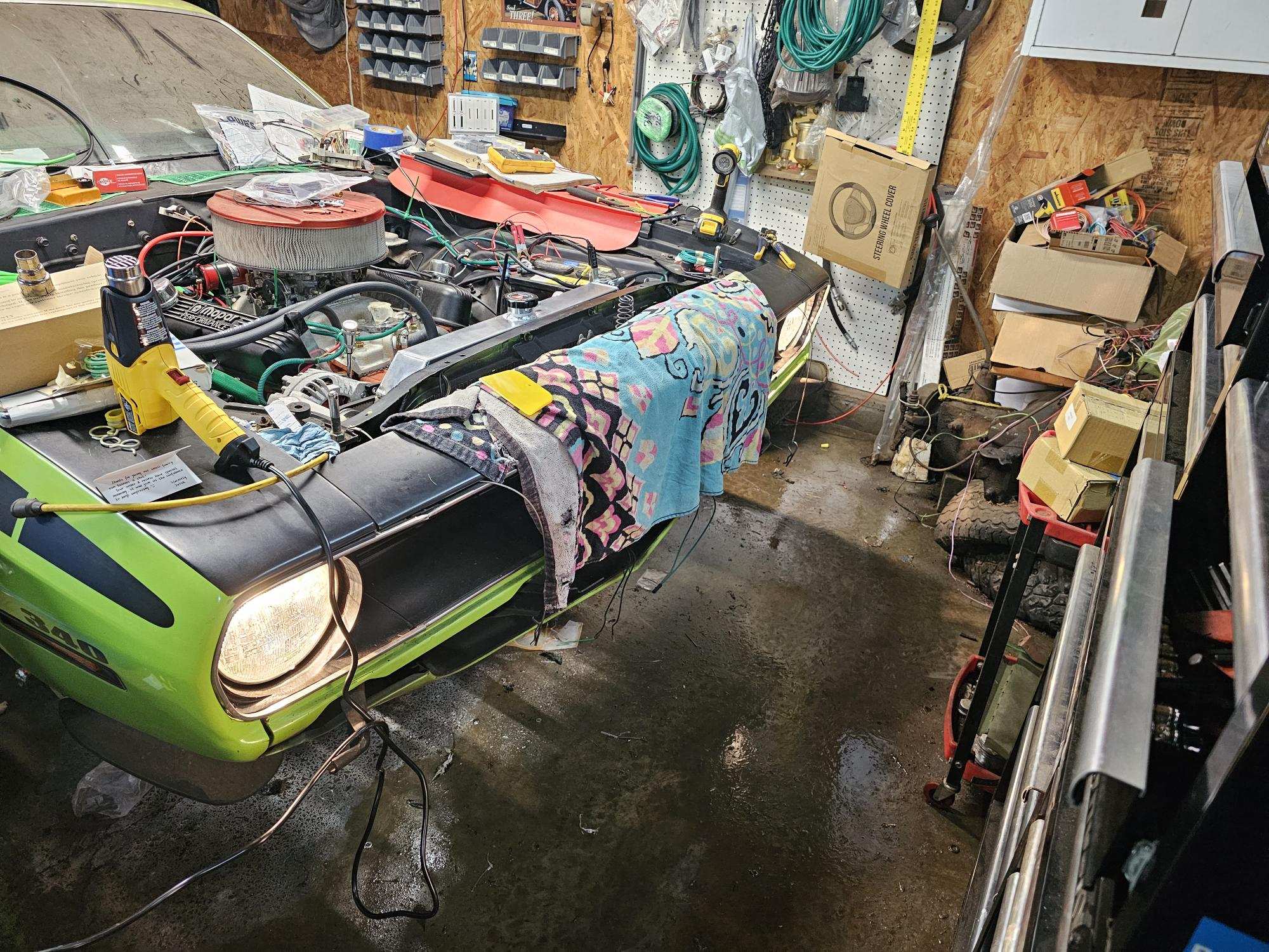

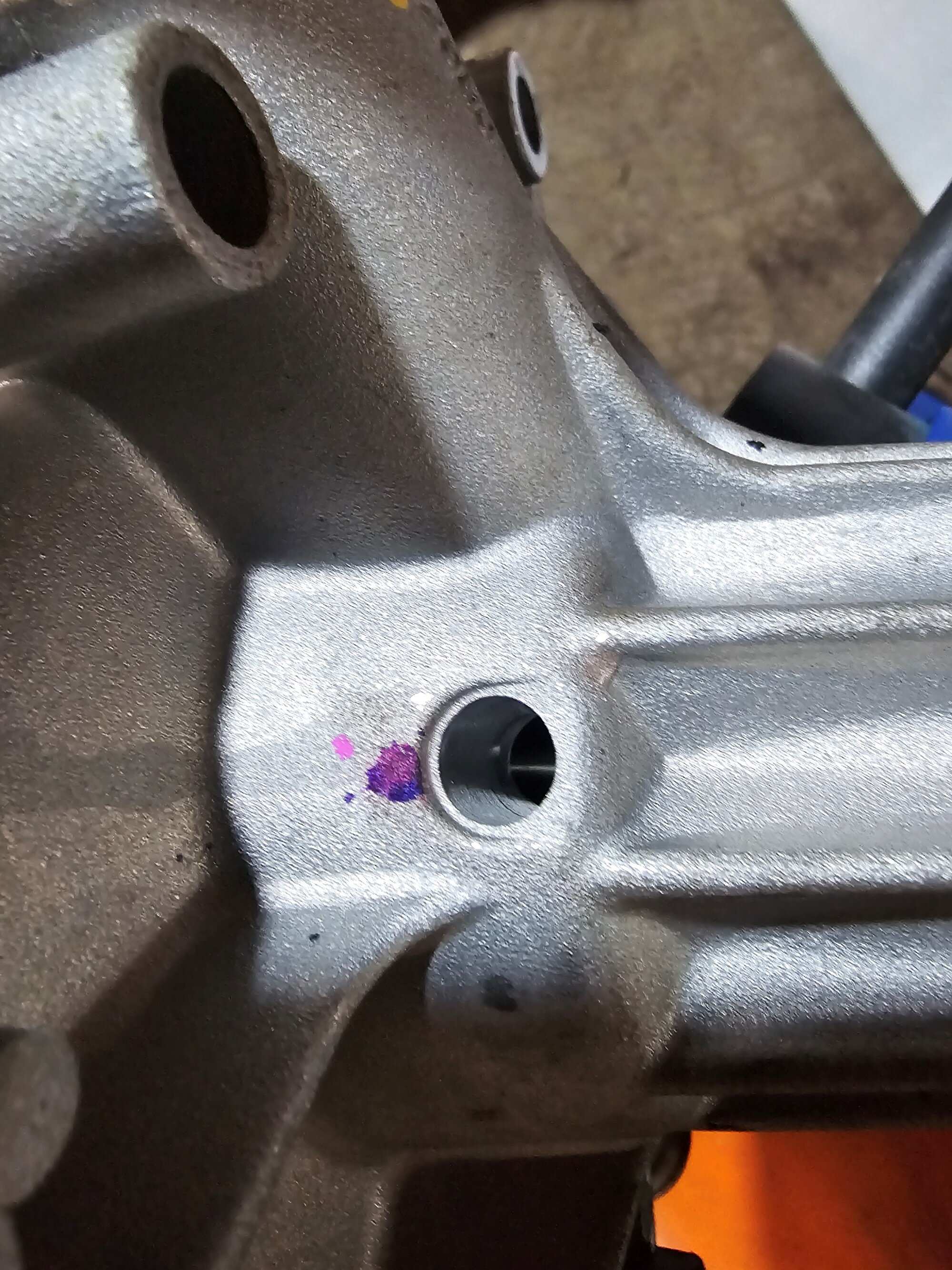

I kinda slacked a little from updates so instead of reviving a year old thread started part 2. I have completed the main wiring and circuit tested what I have for now. I was ready to test fire the engine and had just primed the fuel system when a dropped tool had me notice a coolant leak. It came from the brand new water pump weep hole so necessitated a replacement before continuing. I finished the replacement today and hope to start the engine tomorrow. Lots of work to go including tidying the spaghetti but the tunnel light is brighter. The wet floor is a result of recent non stop rain and 100% humidity.

Lights work - half the battle! May I be so bold and ask you remove a few things from the fenders before cranking that bad boy up?

That picture was taken during circuit testing. The fenders are cleaner now. You don't enjoy a game of dodge the flying tool???

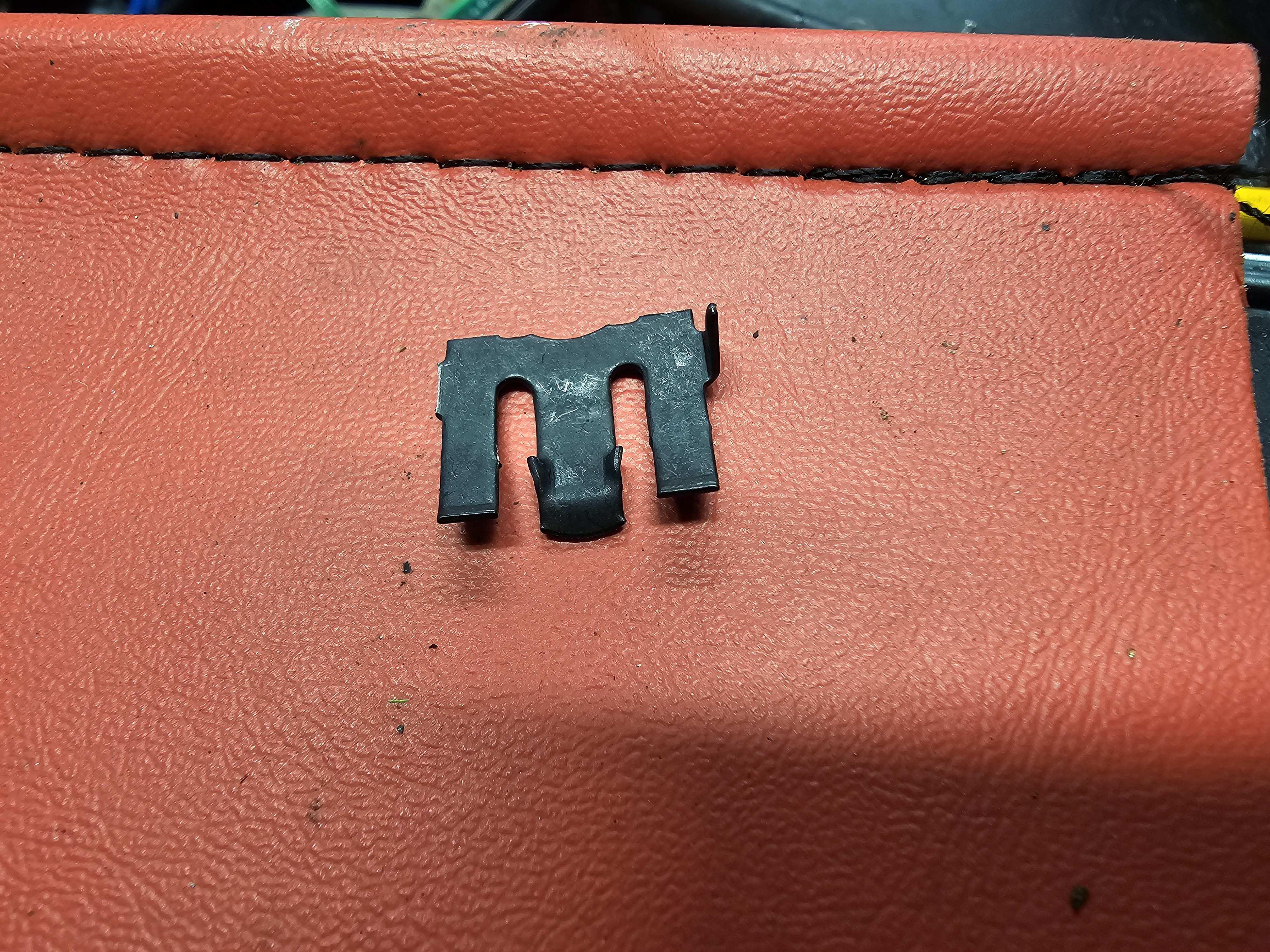

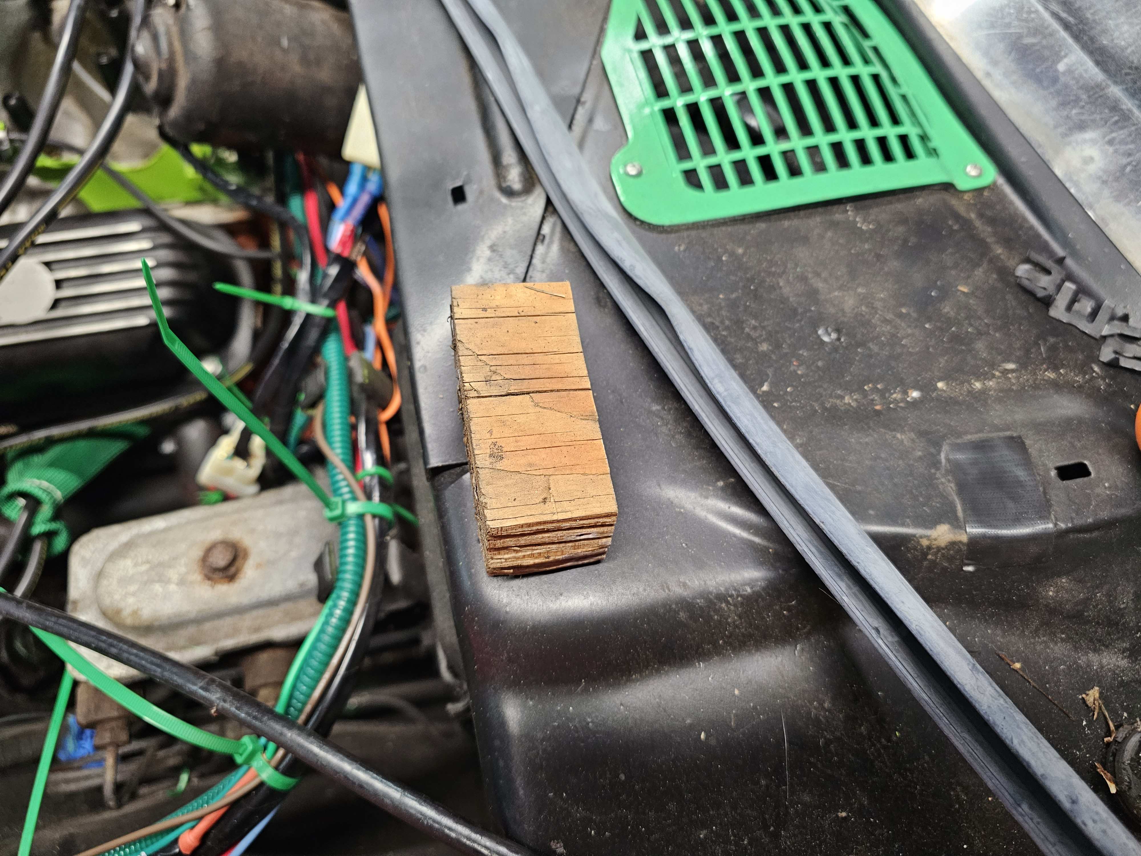

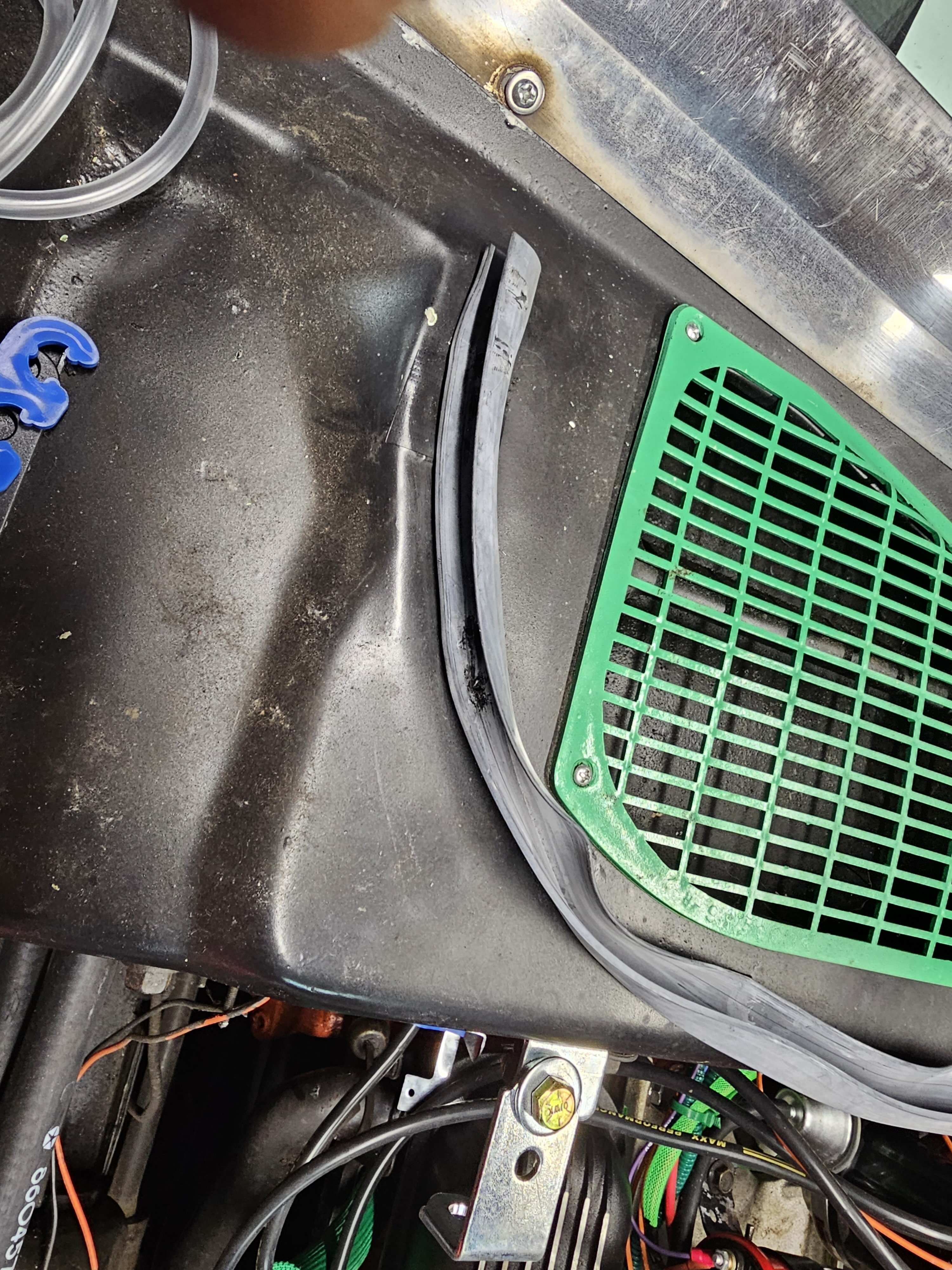

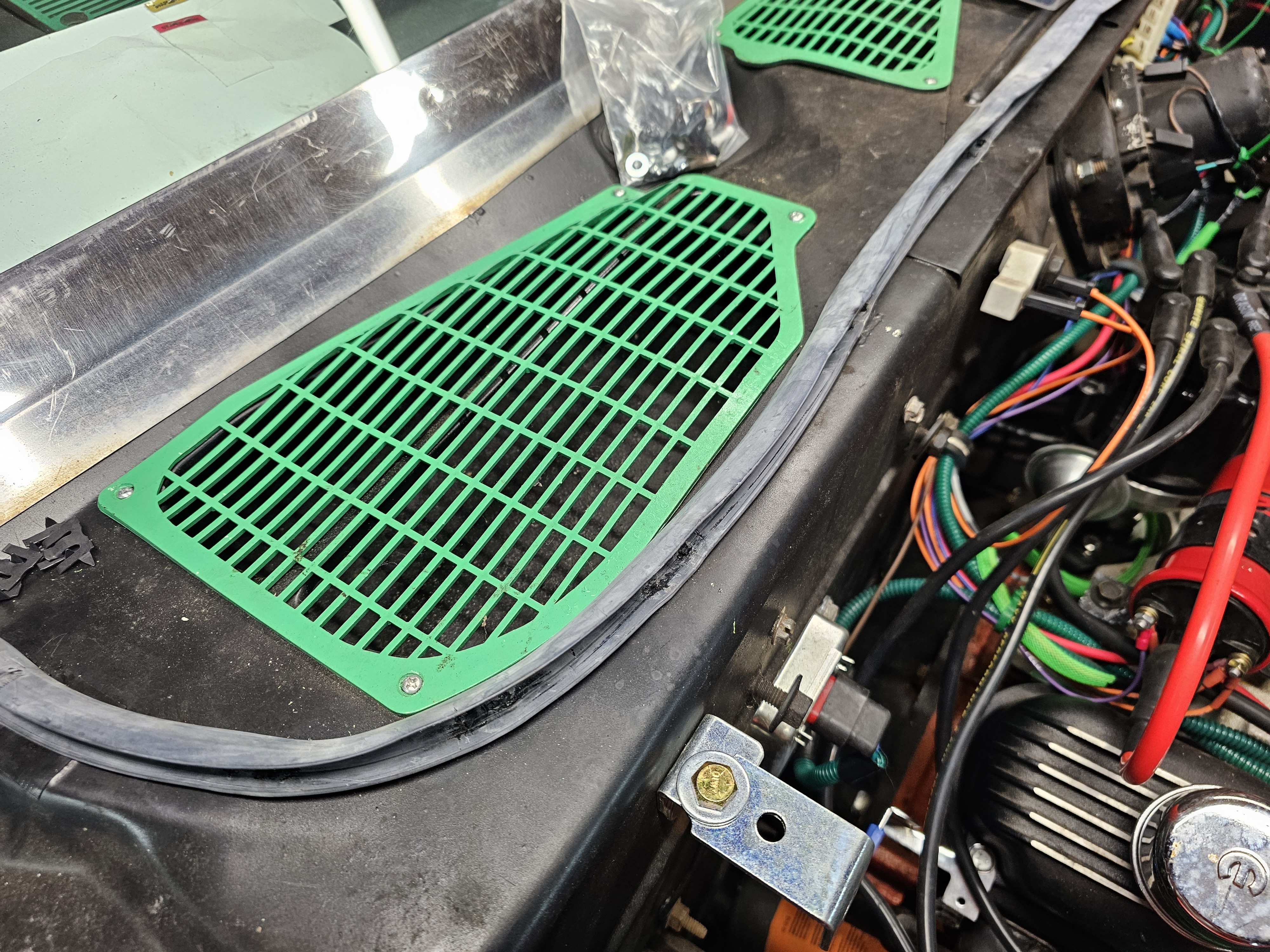

Cowl seal arrived. I didn't know the clips were loose. A pain to install but I used a piece of wood to set the rubber then a fat punch to set the "tabs". 2 tabs broke so I used 2 spares I happen to have but save yourself the trouble and get the one with the clips installed.

I'm confused on the seal, what needs to happen?
Set rubber with wood? Then a punch?
thestuntboy
Oct 19, 2019
41
16
N.E. CT
Nice! Getting there
The clips which are seperate have upright prongs/tabs. I used the wood to push through the seal without damaging it then the punch to push over the tabs to hold the seal. The tabs can break off but I had spares.You are better off buying the seal with clips already installed on the seal.

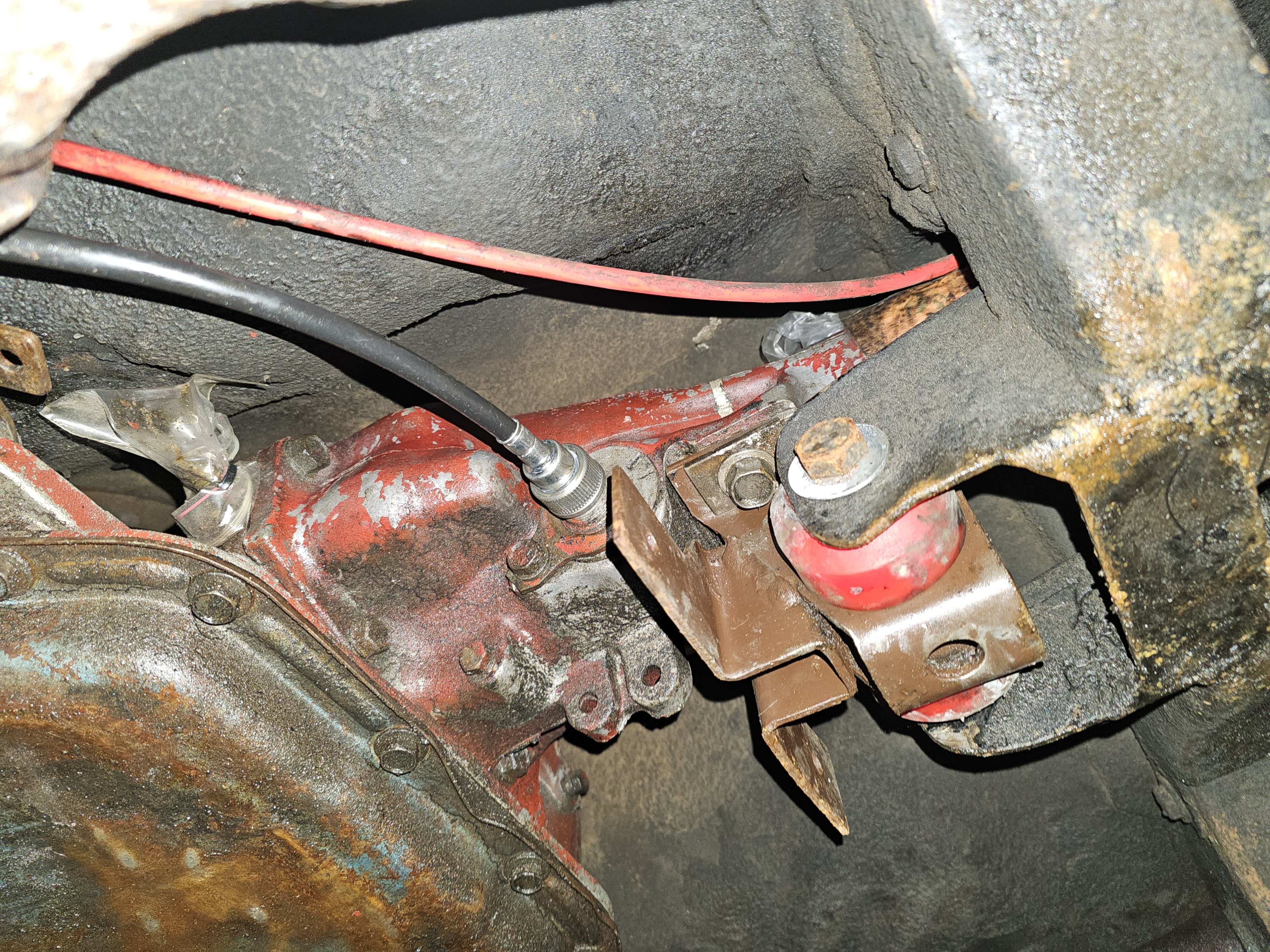

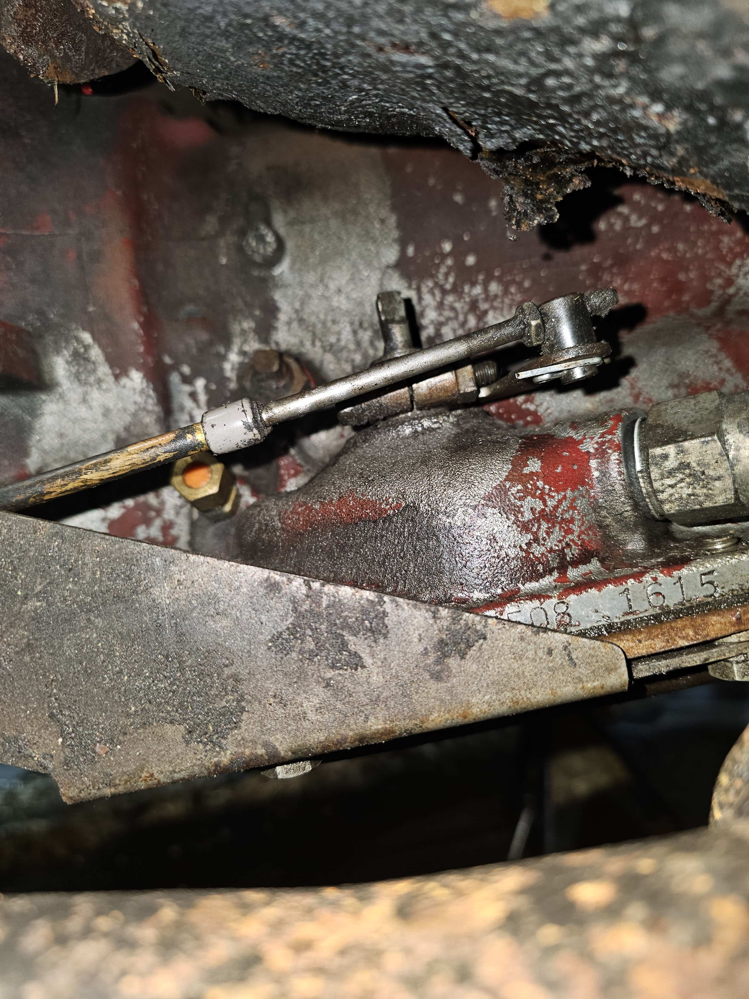

Installed shifter cable , speedo cable, left header pipe. Tight spaces and I have to come up with a viable way to prevent the exhaust from cooking everything. Still looking for the driveshaft but I have a trip coming up so it can wait.
