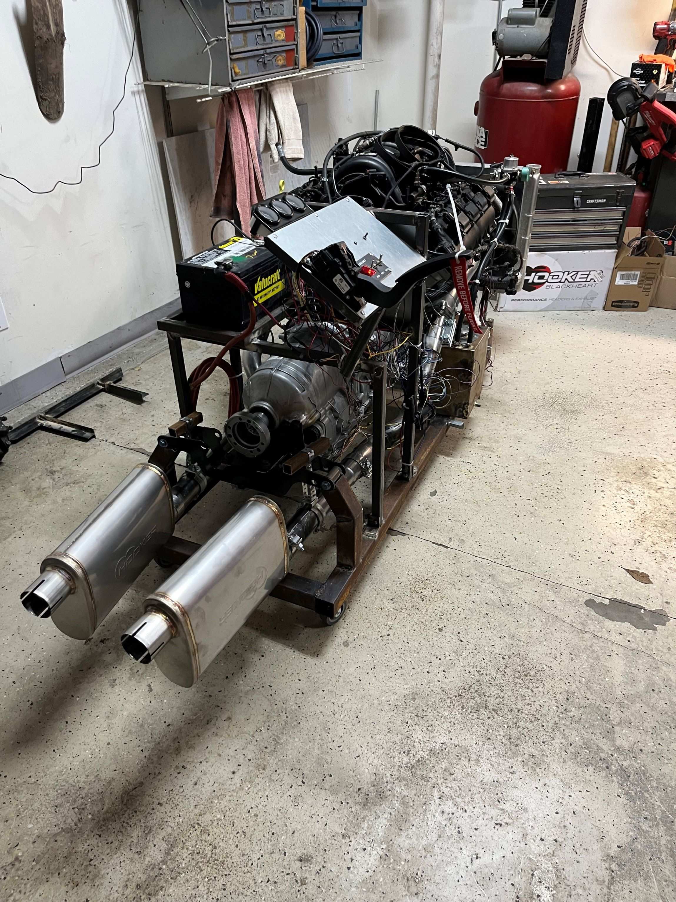

Meanwhile.... At home working on the 5.7L hemi swap
So while the car was at the body shop, i've been working on sorting out the stock ECM and wiring harness for the 5.7L swap. Now have the engine run stand fully populated and ready to start. Having a bit of an issue working out the ECM programming and wiring, but getting close. Update. Engine starts, runs and throttle works like a champ. Now on to integrating it into the car (when the car comes back home).
