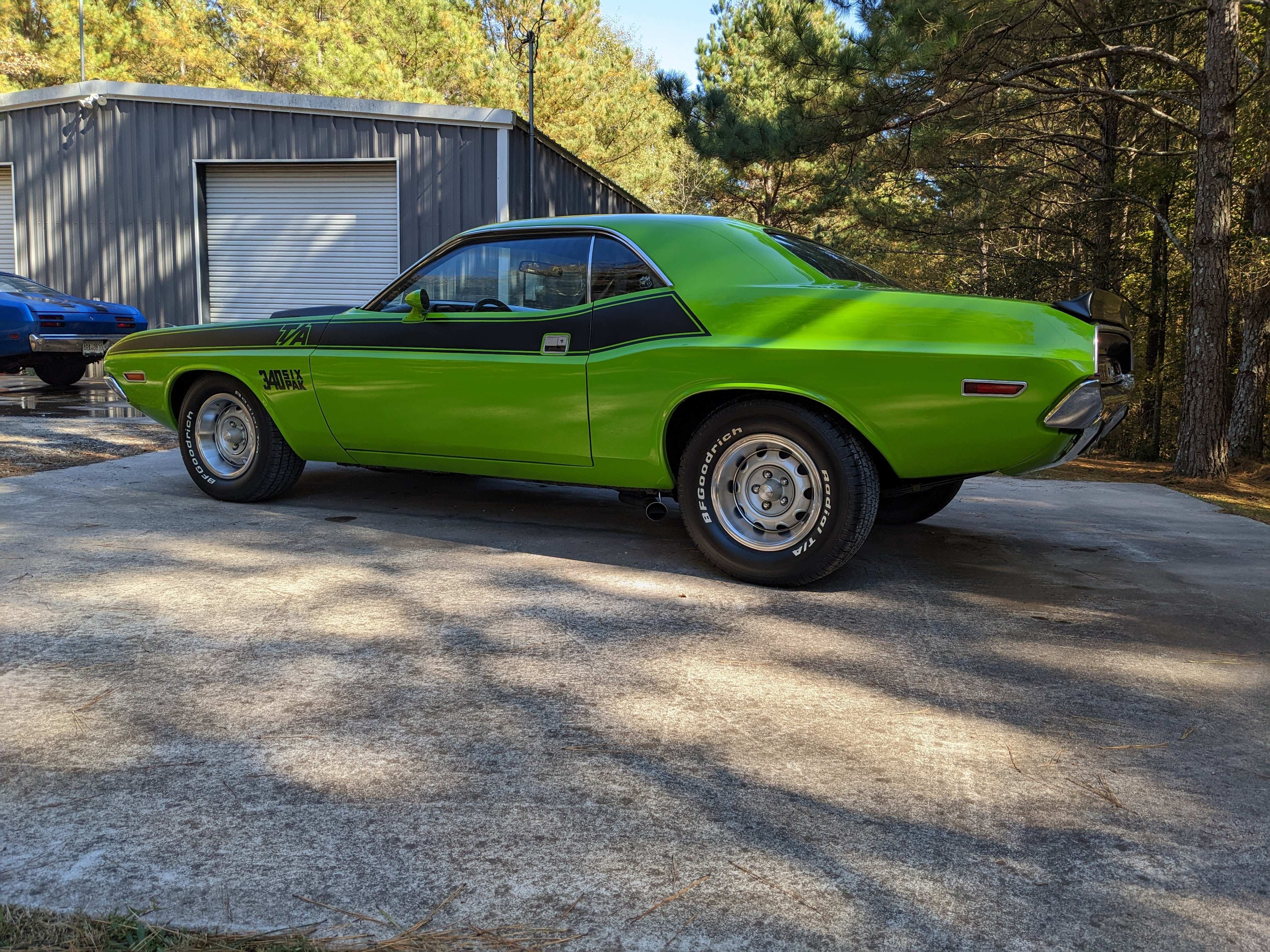

I have added Pro-Comp 13120 leafs to the rear leaf springs in place of mid-length leaf on two cars with good success. Both lifted about one inch. It could vary depending on the current spring condition.
My original T/A springs had lost a bit, so I added the Pro-Comp leaves to restore it's rear height. Handling seems the same. Adding them for the mid-length spring, I was able to keep the lowest leaf with the factory part numbers.

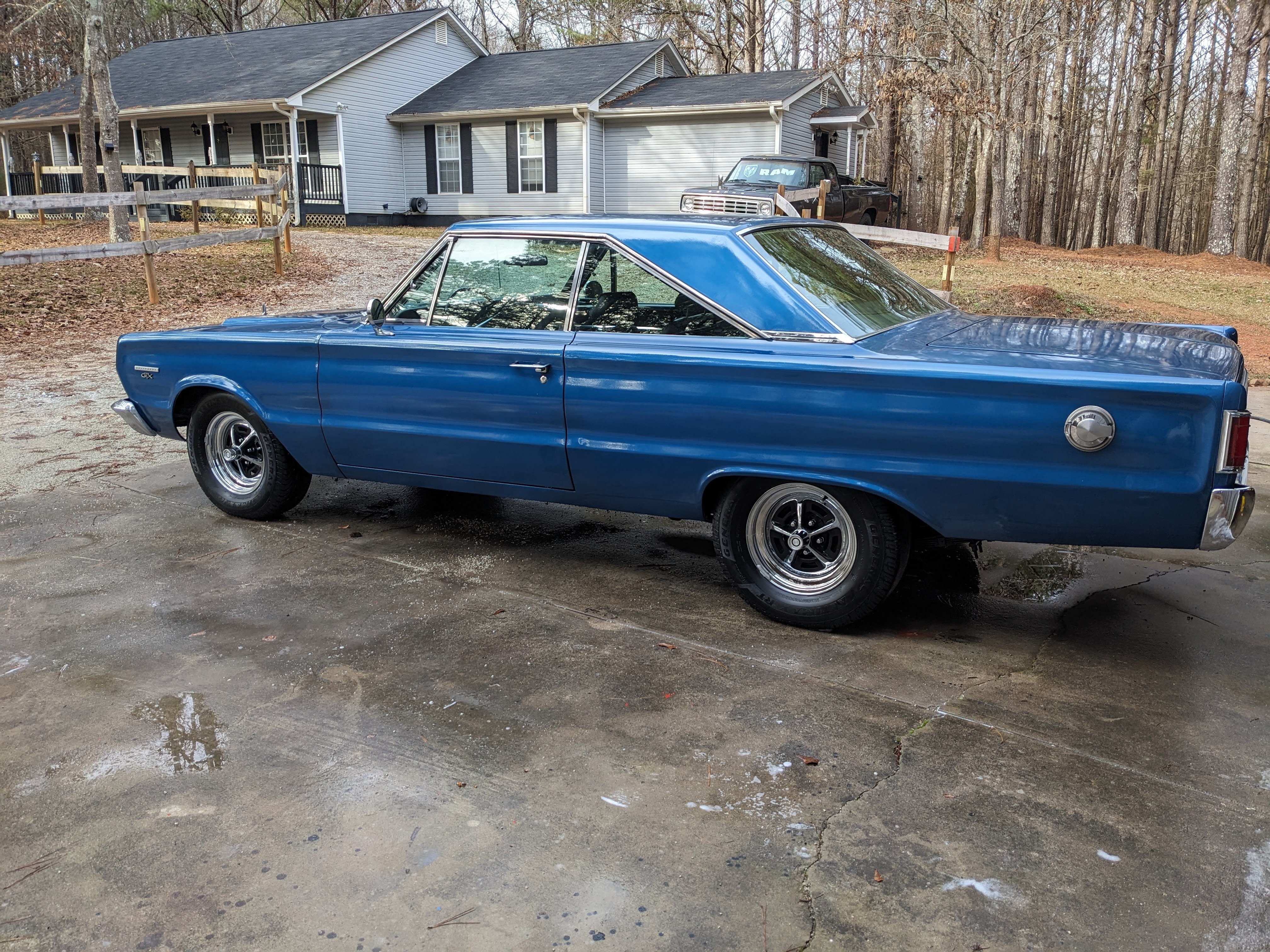

My GTX was sitting at factory height plus a little with new springs from General Spring. Those were specified as +1" already, but I wanted a little more rake and height to better show the wheels in its short fender openings:

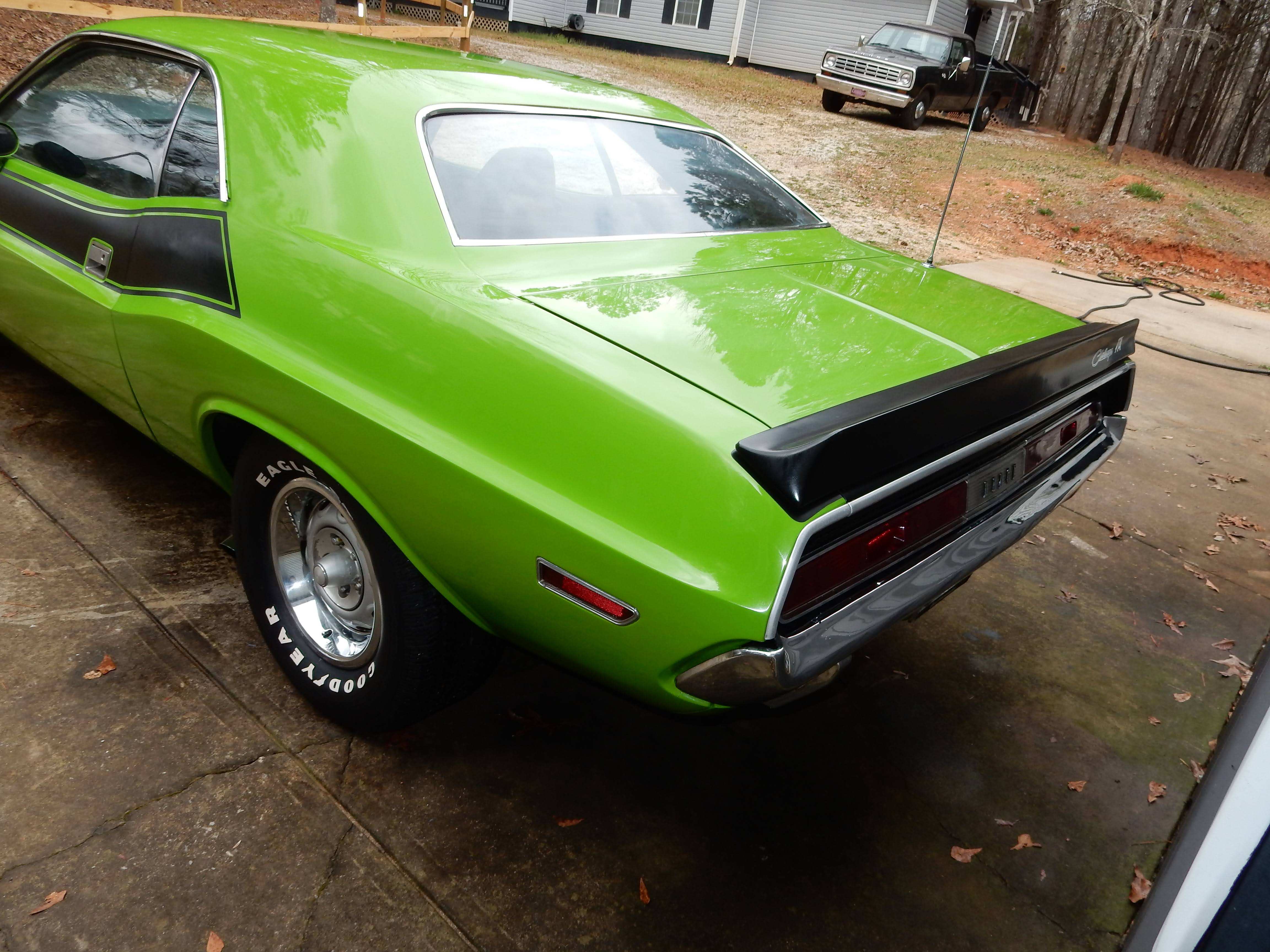

You have a close up pic of the rear window in the TA?
It seems to be tucked down? I don't see the chrome trim?
