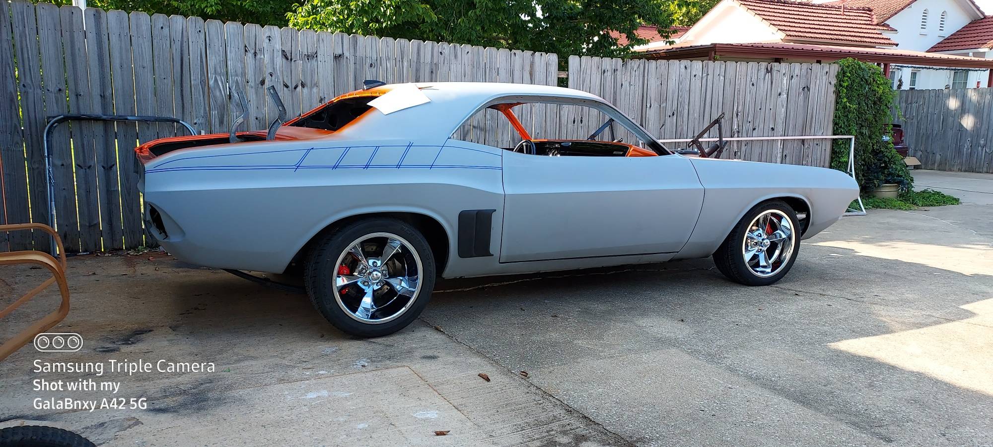

Just put some Voxx Old School rims and new tires on my build. Put 245/40/17 General G Max up front and 275/40/17 GMax tires out back. No rub and decent clearance all around...and I have it lowered 3" from stock susp. with lowering block. Rims are 17/8" on front 0 offset 4,5" BS; Rears are 17/9.5" with 6 offset and 5.5" BS. No need to roll fenders.
