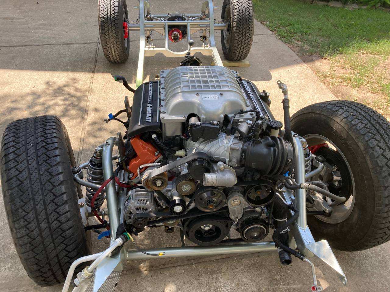

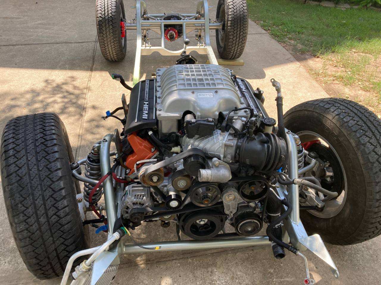

Sorry if this is a repeat quest. Has anyone used the 17x9 Cast Rallye wheels and the recommended 275/40-17 tires per Classic Industries on all four wheel locations for a stock Cuda car? I have Jeep JK rollers on now, but need tires and wheels to drop body on Schwartz Chassis. Thanks for help. Hellcat1.JPEG

Thanks for response. Schwartz told me that wheel hubs were in stock location and if wheels and tires worked on stock bodies, I would be OK.
I would however gain more space in backspacing since no leaf springs involved and remove stock shock towers.
I pretty sure the 17x9 Cast Rallye wheels and the recommended 275/40-17 would work in rear, but unsure about the front (rubbing outer wheel wells when turning.
I could go with the 17X8 in front but was wanting the forums opinion to give me a bit of direction before making another big investment.

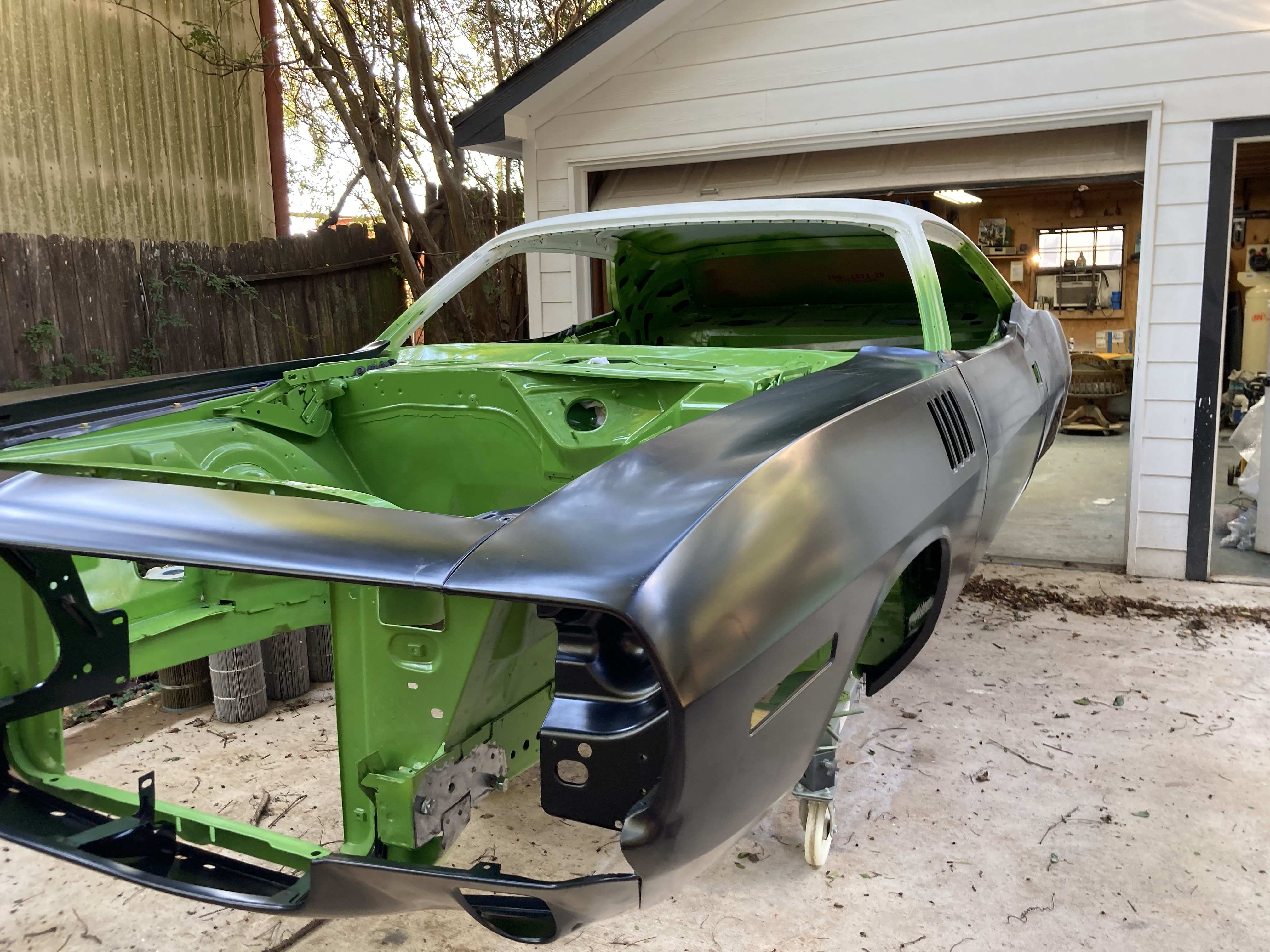

I've been working on body for 1 year and 10 months. So
much rust!
I replaced just about everything accept frame rails, roof, inner front fenders & interior structures in roof area.

I bought the 17 X 9 cast Rallye wheels and they look great, but I put on cheap narrow used rollers until I get body down on frame and painted. I had a lot of work to do on chassis and engine. Frab up transmission mount, installing Schwarts intercooler header (because of clearance on firewall), some wiring in the intercooler area. Not going to be able to get to when engine in engine bay.
To use a Schwarts chassis and hellcat engine, you need special Stainless-Steel headers ($2500:mad:). A very difficult task to install. I had to get wife with little hands to help. Still listening to whining about nails and scratches. Ready to put on chassis, waiting to use body lift at body shop. A lot of cutting and welding to get chassis and body attached plus transmission tunnel for 6 speed manual trans.
I'm hoping in another month or so to have body on frame.
I didn't tub the rear as I'm new to such drastic metal replacement that I had to do on this project and was worried about reference points on inner tubs not being there.
Body shop wants to roll fenders to make an additional 1/2" tire width, then measure for best fit. Overall, I think everything is going to work out fine on wheels.
