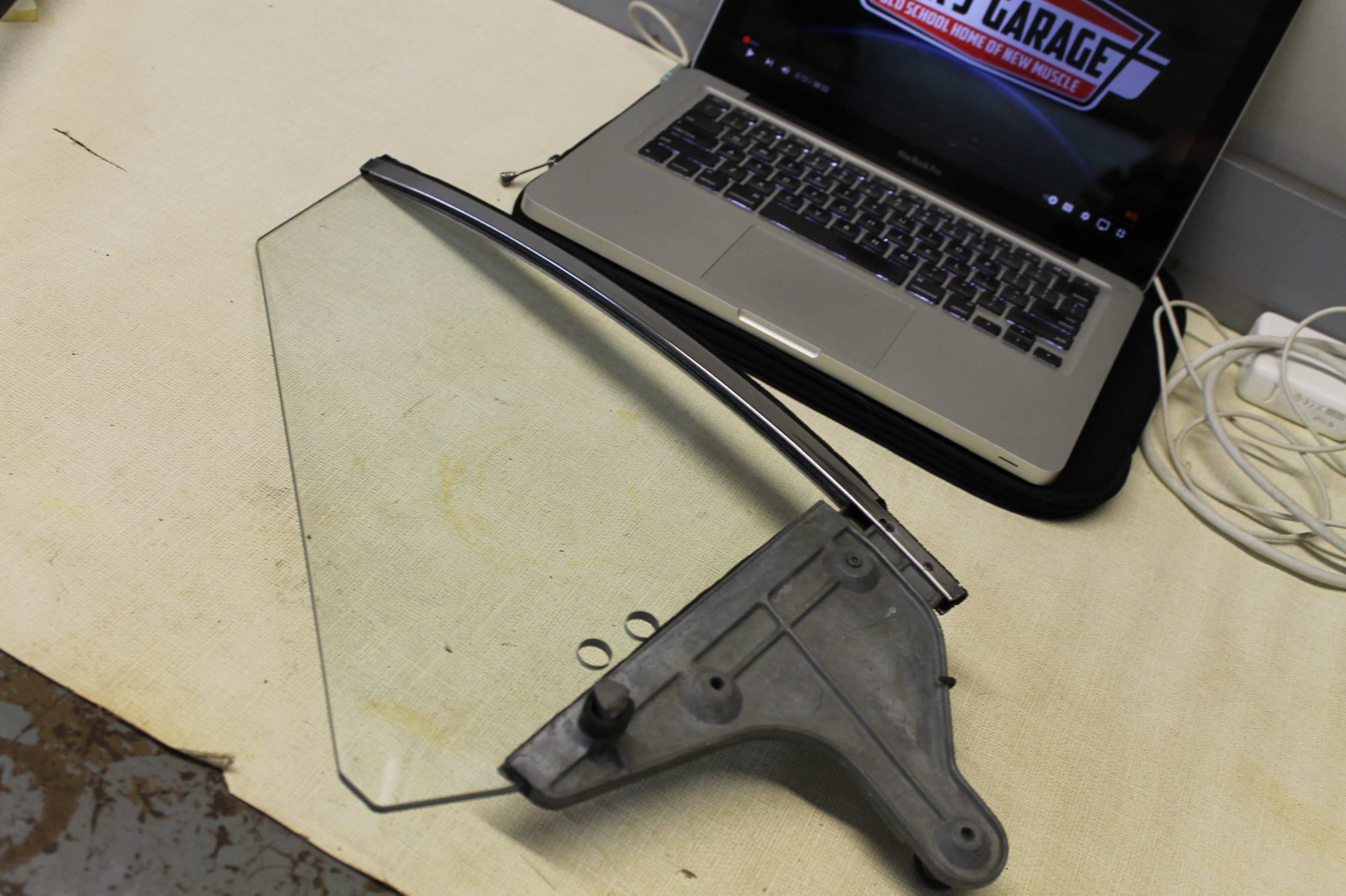

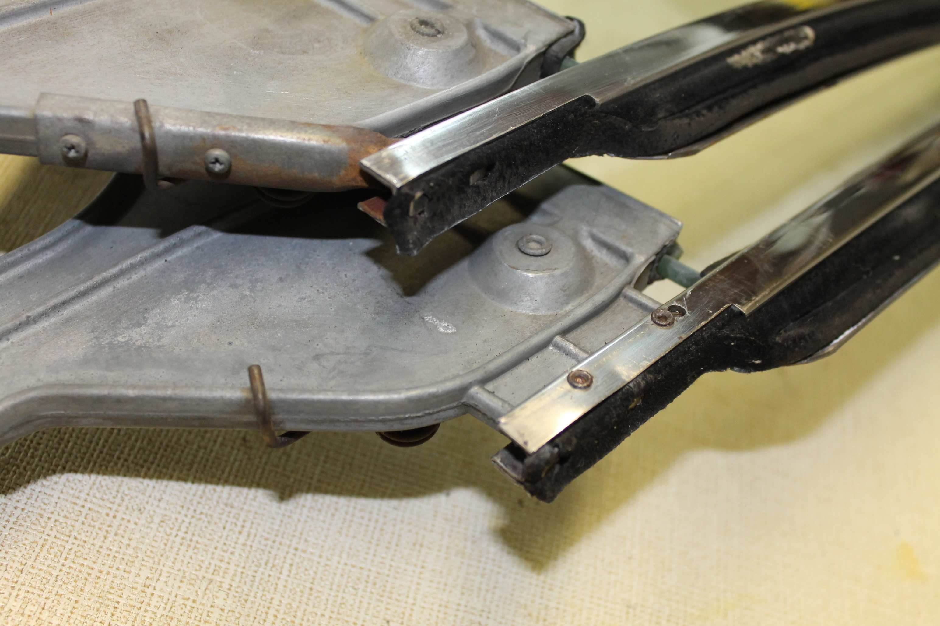

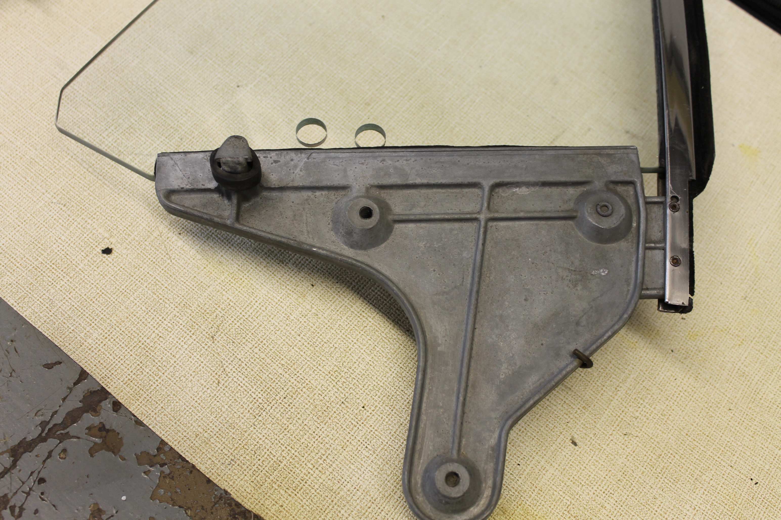

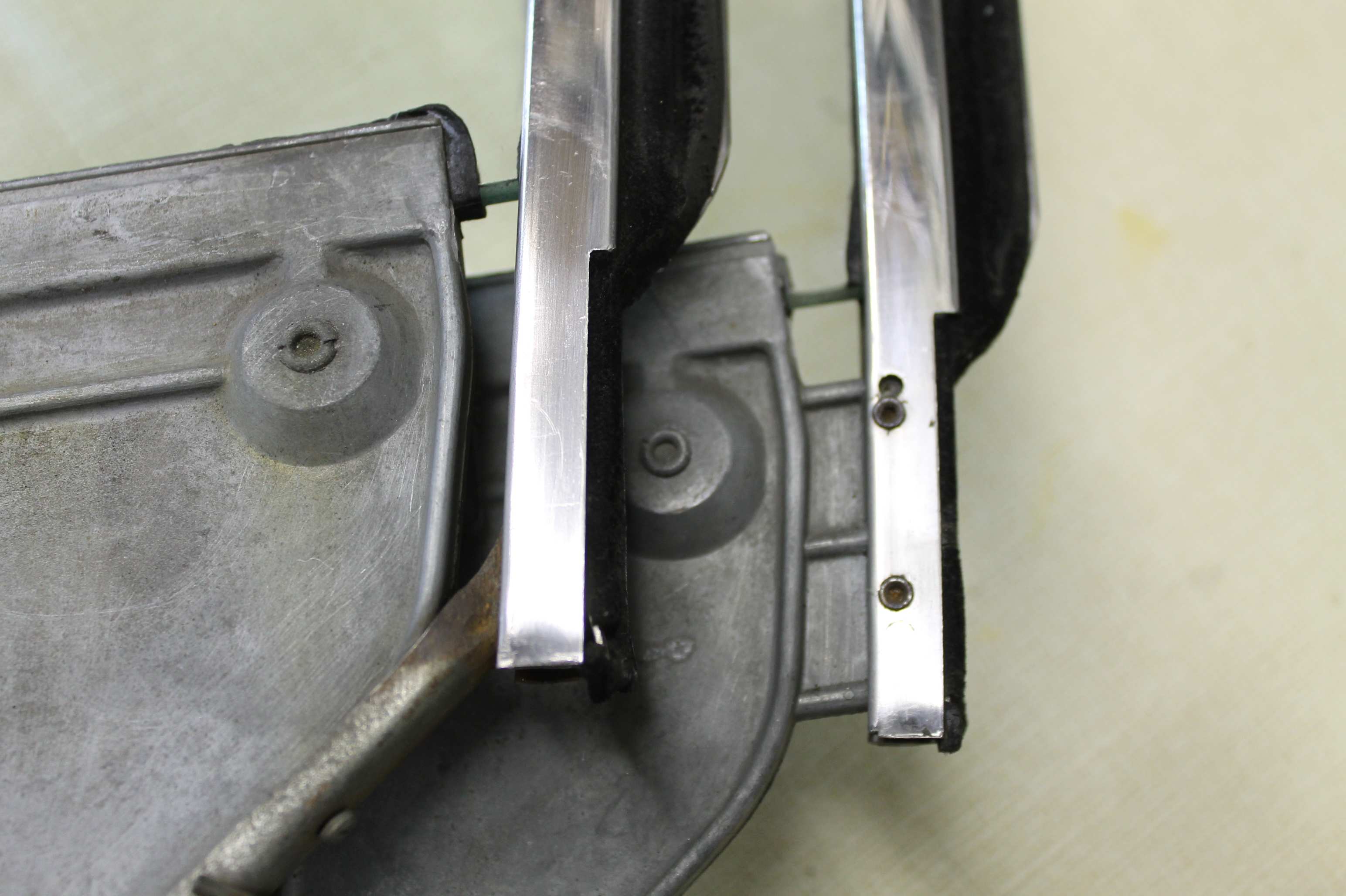

Hello All, I haven't posted here as of yet. I mostly post on B-bodies Only as I am working on my 1968 Charger. I do have two 1970 Cuda hardtops but no longer any convertibles and will get to them in the future. I found some convertible glass in my old parts and would like to find a new home for them.Here is my question, on the 70-71 rear quarter glass I have two different styles of stainless weather strip retainers. I searched the archives and found some interesting information on identifying hard top vs. convertible measurements. I am sure that these are convertible however, before I advertise them as I do not need them I would like to be positive in my description. The one with the riveted stainless to the boss is Cast # 3499346 and one with the screwed extended arm is 3505704. Is it a difference in years or a change in production? Both look like they accept the same weatherstrip. I checked some hardtop glass and they share both of these differences. I have both right and left sides but opted to just showing the right. Any help would be appreciated. Thanks. Kocan

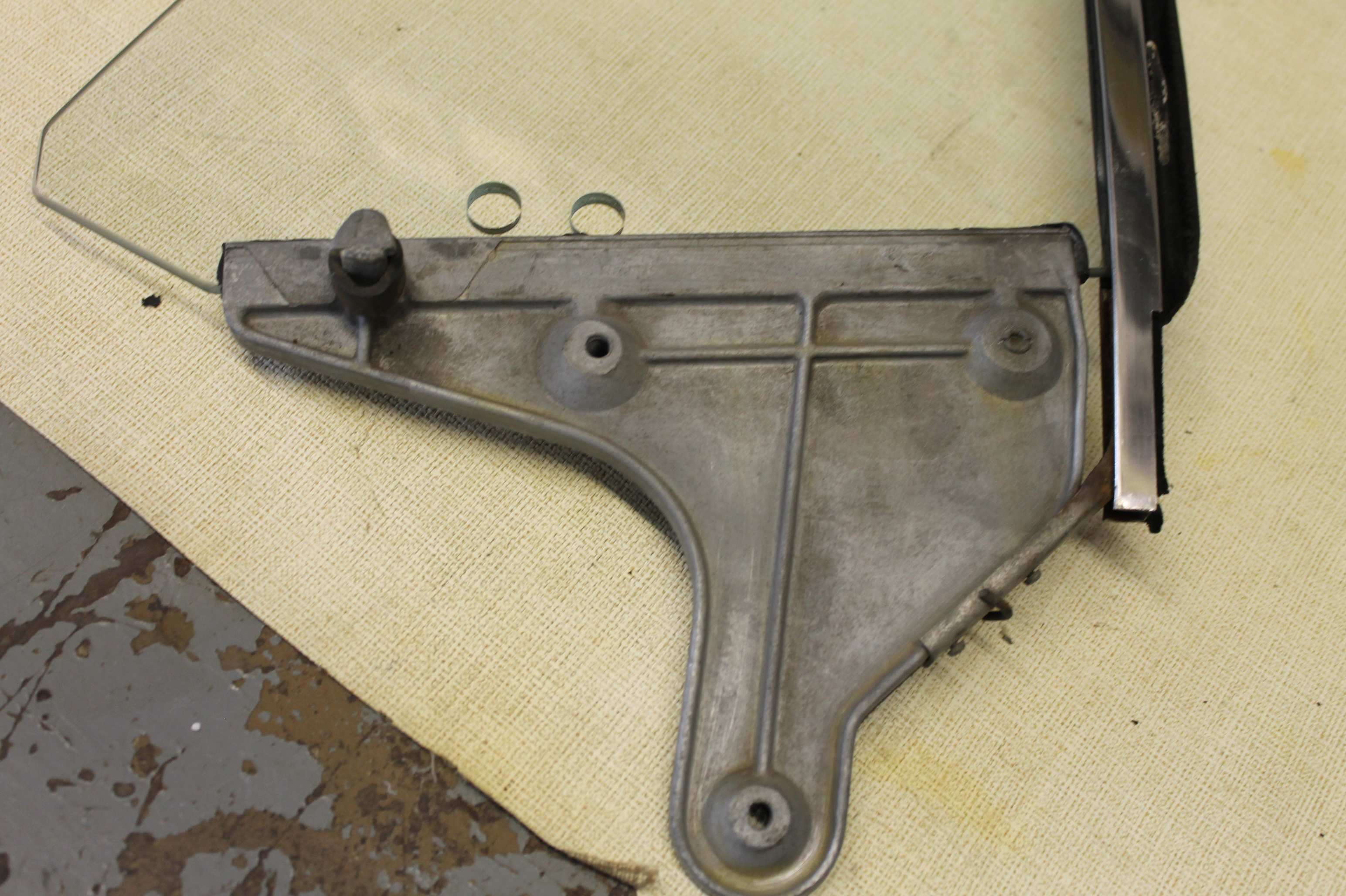

This is a rear quarter glass from my !970 Barracuda convertible (March 1970 build). I bought the car 1979 and the only glass I ever replaced was the windshield. This is all I can offer.

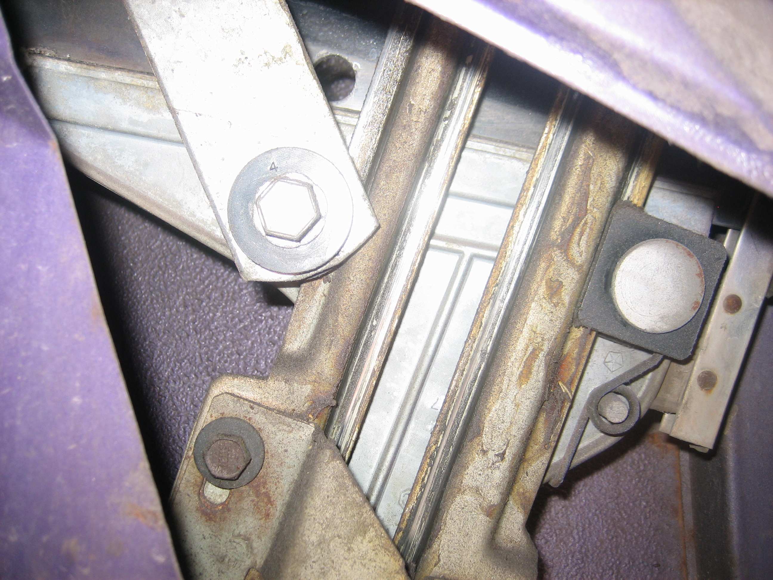

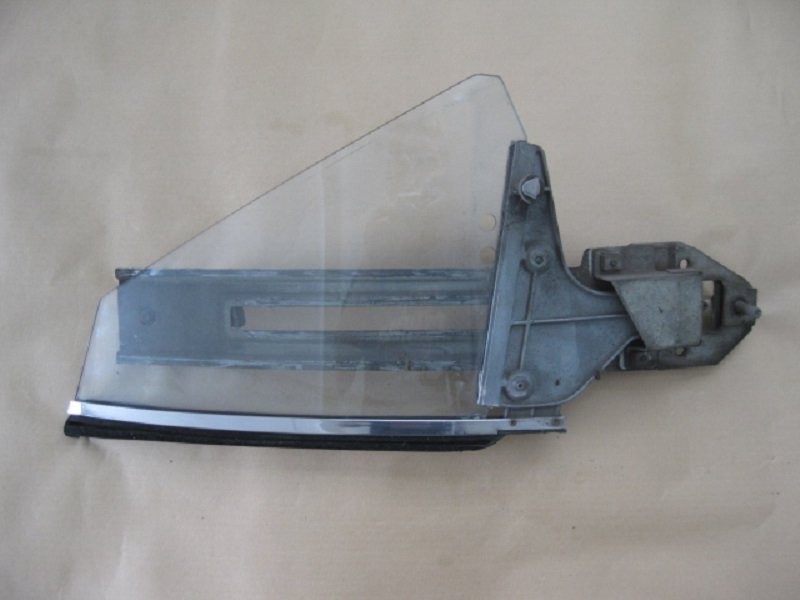

For what its worth, the glass in my '71 Challenger vert is of the riveted construction, just like the pics from EW1BH27 above. My door tag indicates AUG '70 build - however, there are a lot of 1970 parts on the car from new. Are Challenger and 'Cuda vert 1/4 window assemblies the same?
@Michael Kocan - where on the 1/4 window castings are part numbers located? My glass is in the car but the trim panels are not installed, so maybe with a mirror or something, I can read the part numbers.....
