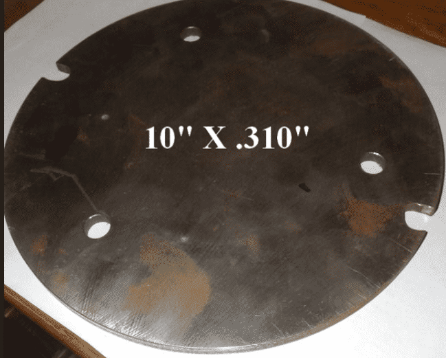

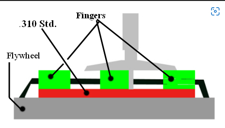

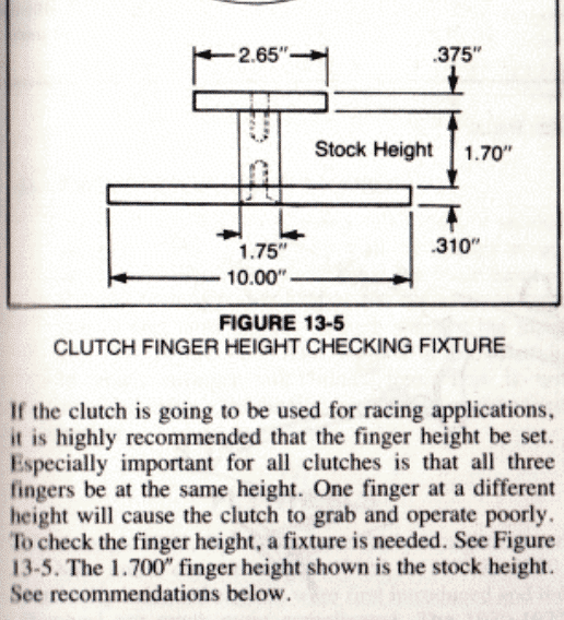

The Mopar Performance book offers fixture dimensions for checking clutch cover finger height. Unfortunately, they don't explain how to use.
I had a disc ground that I use as a standard in place of the disc. Then I measure with a depth mic across two fingers down to it.
