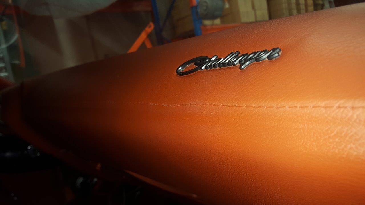

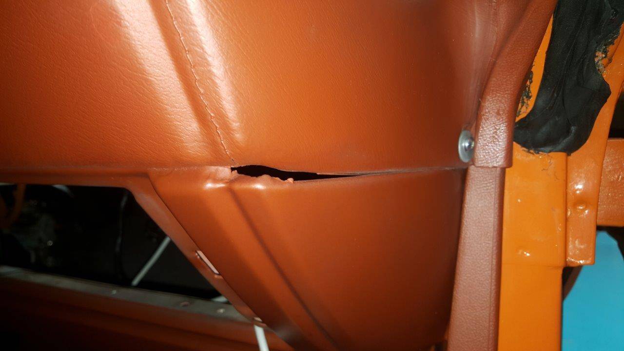

I had Dash Pad pros do a steel TA dash quoted around 4 weeks wasn't ready for 10 when i received you could see right through the burnt orange to the black underneath had to respray .
Also had some bad dimples that i had to drill a small hole behind & pump out with silicone bit like an implant.
The stitch line was all wavy & vinyl was pulled too tight see pic of dash end.
Also had to dig out a heap of foam to fit the rallye light bezel.
I would use Just dashes next time
