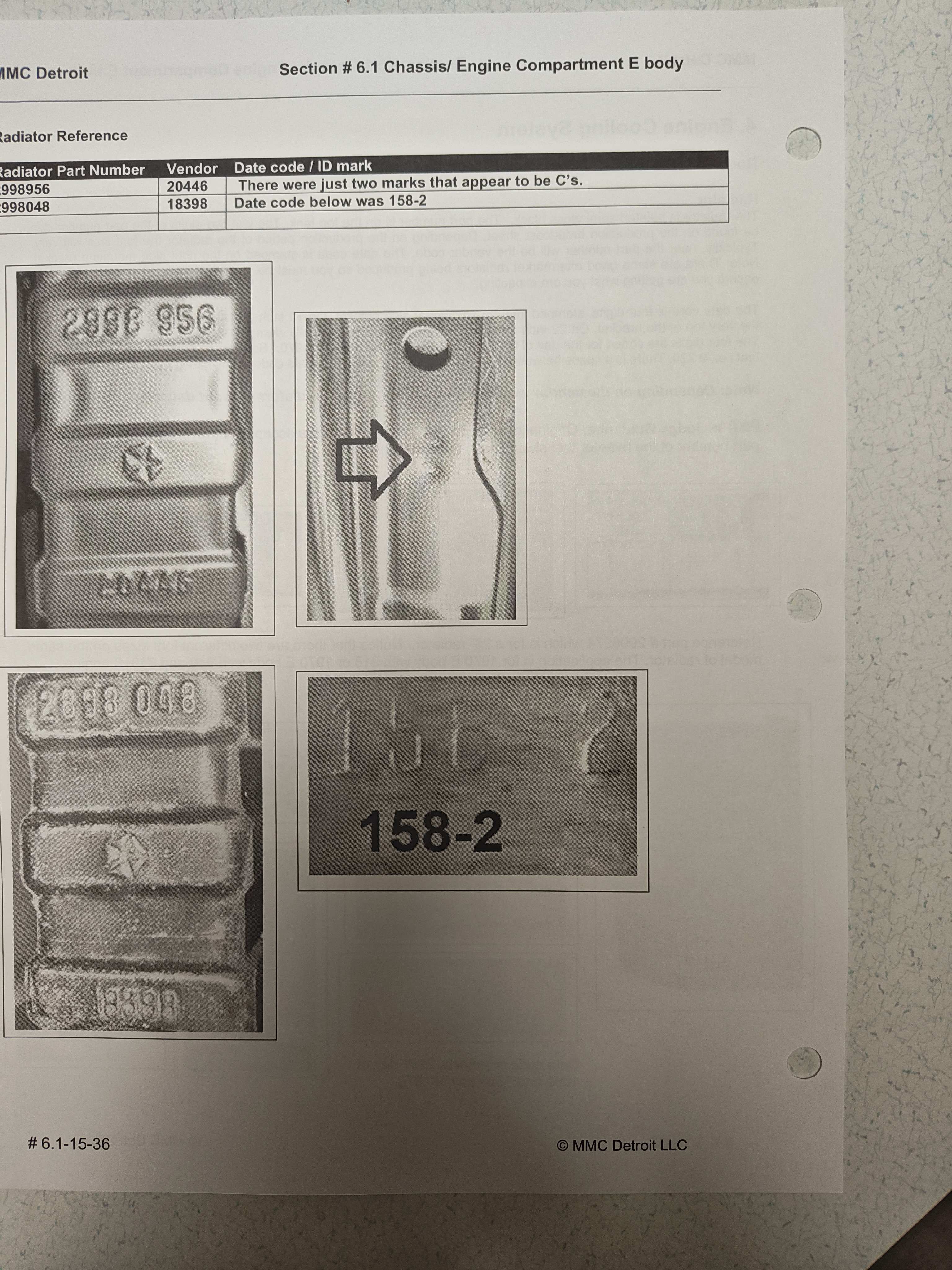

Oct 25, 2024 #1 K KennyCuda Well-Known Member Joined Aug 3, 2020 Messages 404 Reaction score 54 Was wondering just to the left of the radiator cap ( towards passenger side) stamped into the radiator is 5 numbers mine are 18398 what do those number mean?
Oct 25, 2024 #2 Xcudame Well-Known Member Joined May 27, 2023 Messages 1,969 Reaction score 1,439 Location Southeast Arizona Vender part number. See attached page from the Master Restoration and Judging Guidelines 1970-74 E Body.
Oct 25, 2024 #3 K KennyCuda Well-Known Member Joined Aug 3, 2020 Messages 404 Reaction score 54 thanks-- where was the date code stamped drivers side or passenger side on the outside of the mount or inside. Can it be seen when mounted?

Oct 25, 2024 #4 Xcudame Well-Known Member Joined May 27, 2023 Messages 1,969 Reaction score 1,439 Location Southeast Arizona The date code is on the passenger side frame towards the engine side. You might be able to see it in the car is it's not covered by the fan shroud.
Oct 25, 2024 #5 K KennyCuda Well-Known Member Joined Aug 3, 2020 Messages 404 Reaction score 54 great info thanks for the help--- what manual is that from Last edited: Oct 25, 2024
Oct 27, 2024 #6 Xcudame Well-Known Member Joined May 27, 2023 Messages 1,969 Reaction score 1,439 Location Southeast Arizona Dodge and Plymouth E body (Challenger and Barracuda) 1970-74 Reference Manual: Restoration and Judging (JME 1.1 ) shop.mmcdetroit.com Get one! It's worth every penny!
