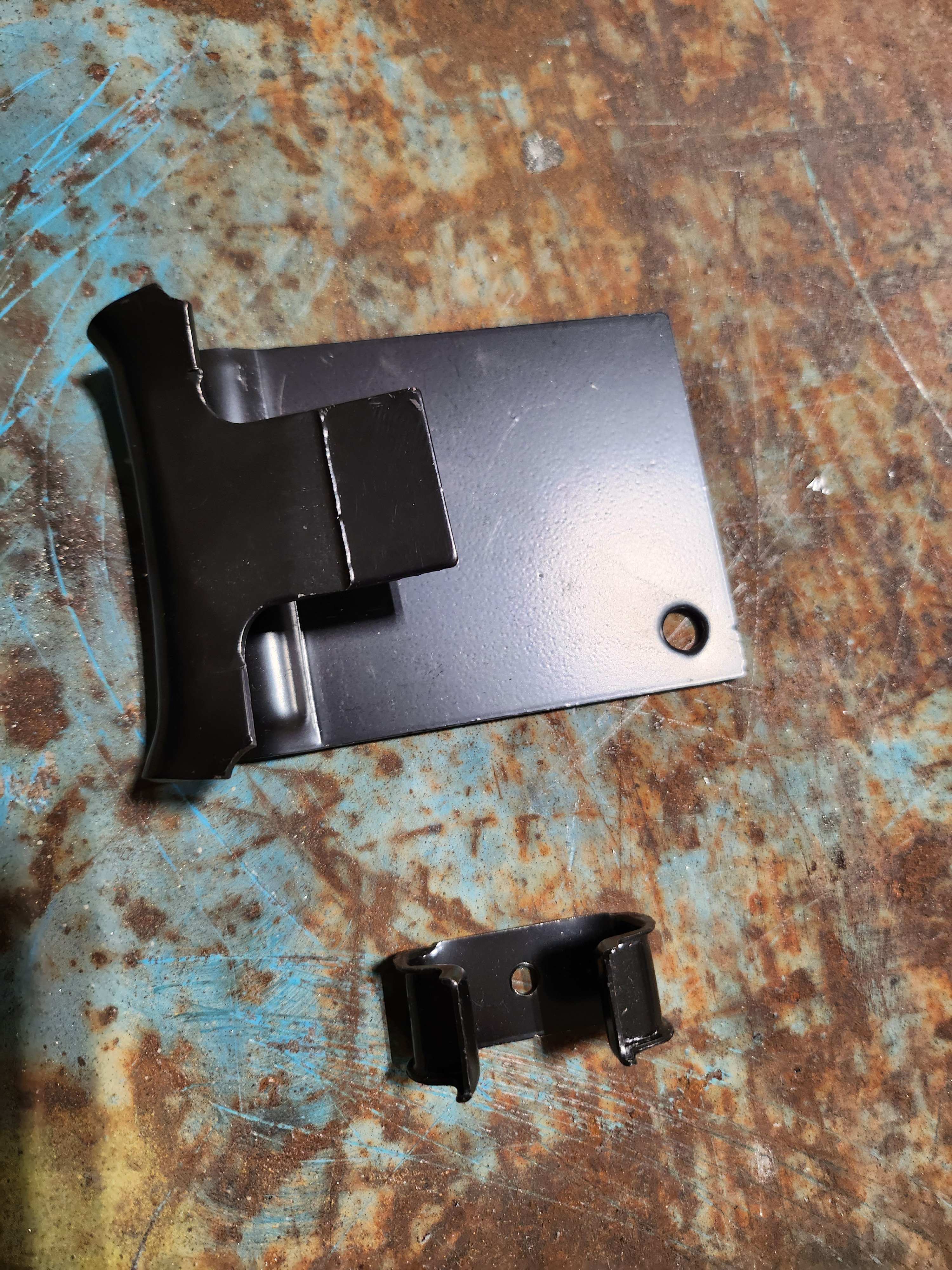

welding in a new floor pan, and I'm at the point of the e brake cable tensioner bracket and cable holder clip location, welded to the drivers side floor pan, mine was already gone before removing old pan. any pics would be greatly appreciated, thanks in advance

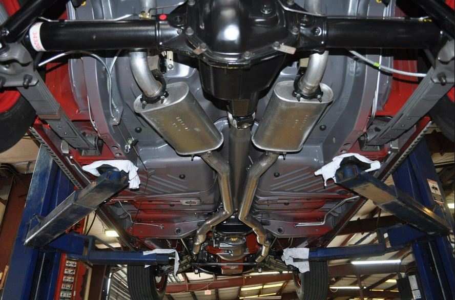

Not my car but this is a pic I saved for reference, hope it helps-

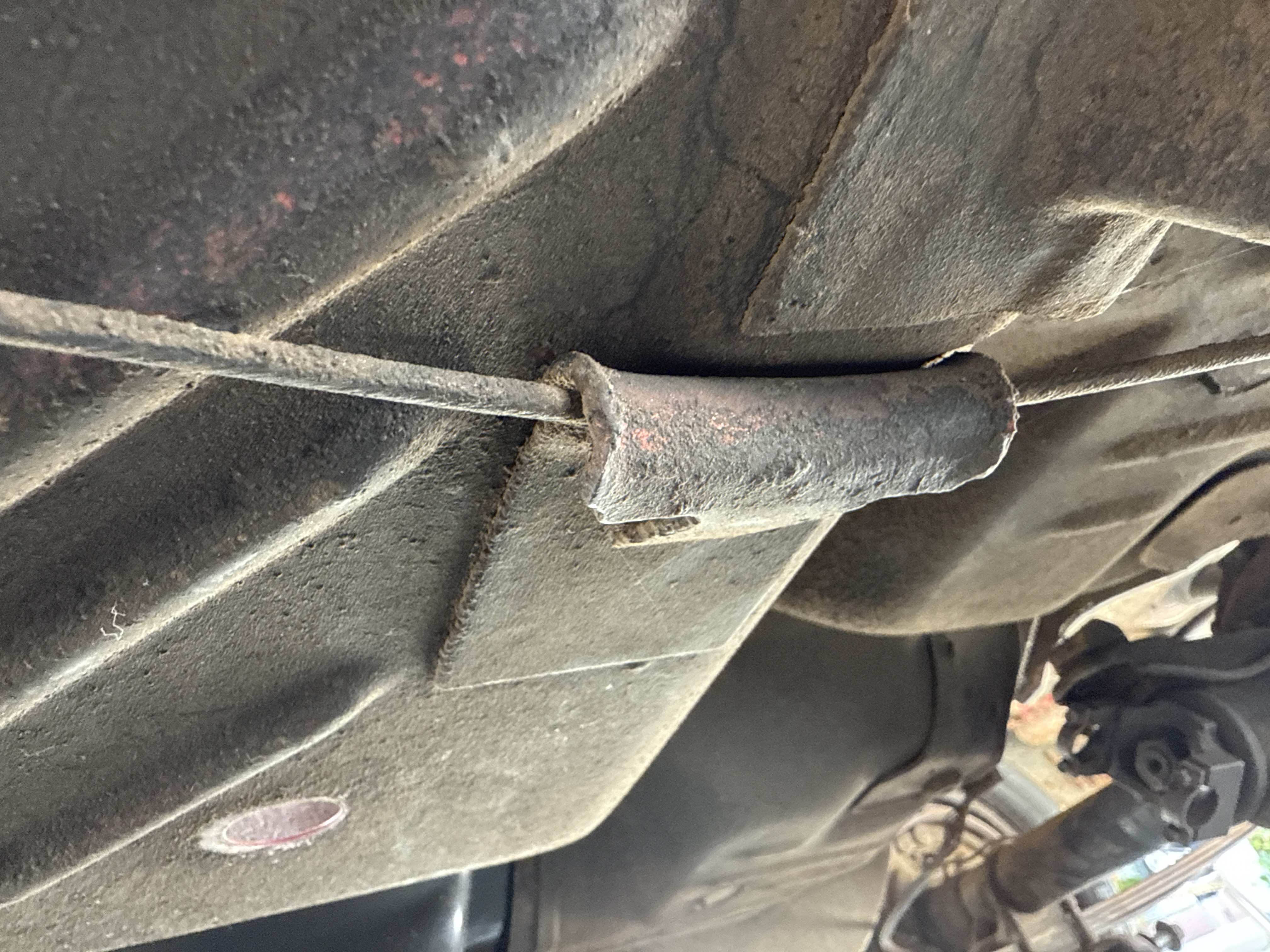

interesting, mine had a piece of metal for the cable guide welded to a patch panel coveing
the front of the floor pan, in your pic the bracket is welded to the back floor pan. no sign of anything being welded to my rear pan. these are the line guides that came with the amd package thinking the smaller one will not be used.
EV2RTSE
Dec 13, 2013
397
260

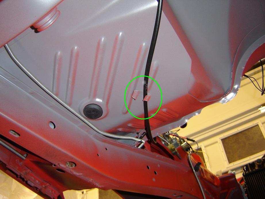

The bottom clip in your pic installs to the front floor pan but it's for the speedometer cable. I think this is from the same car.

thanks that will work, I'll have to get under there and take a closer look at that rear pan in my car thanks again.
