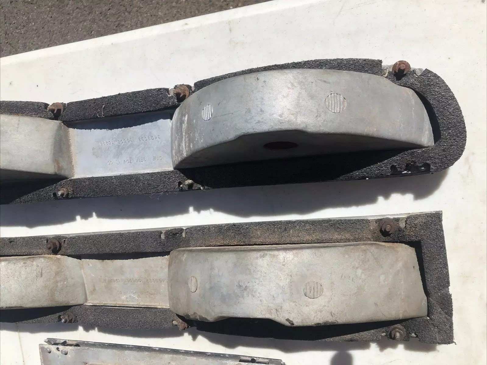

Regarding tail light lens replacement; you need to pull out the housing units by removing the nuts on the housing studs inside the trunk. Once removed, gently remove the foam seal and disassemble to remove the broken lens. Pic of back of unit showing studs
