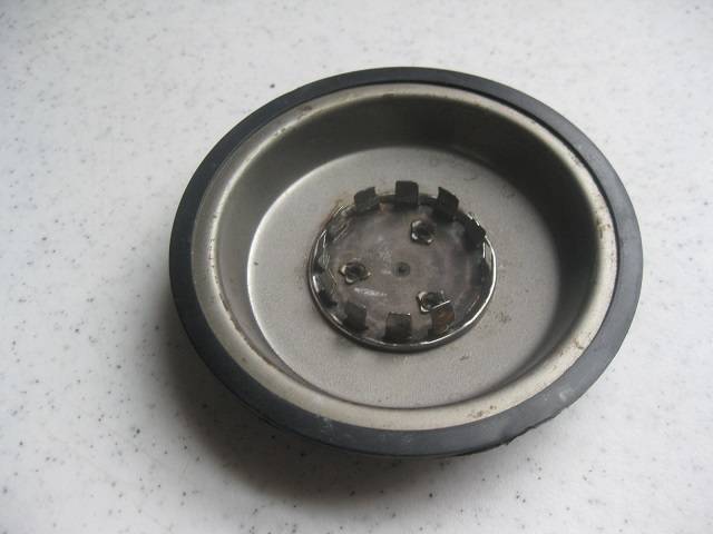

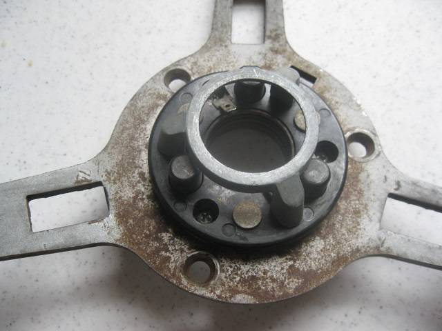

Pull straight up, no twisting needed. It's held on with several spring tabs and very tight. One of the tabs is broken off on mine in the picture. It just presses on the center ring of the actual button (2nd pic)
