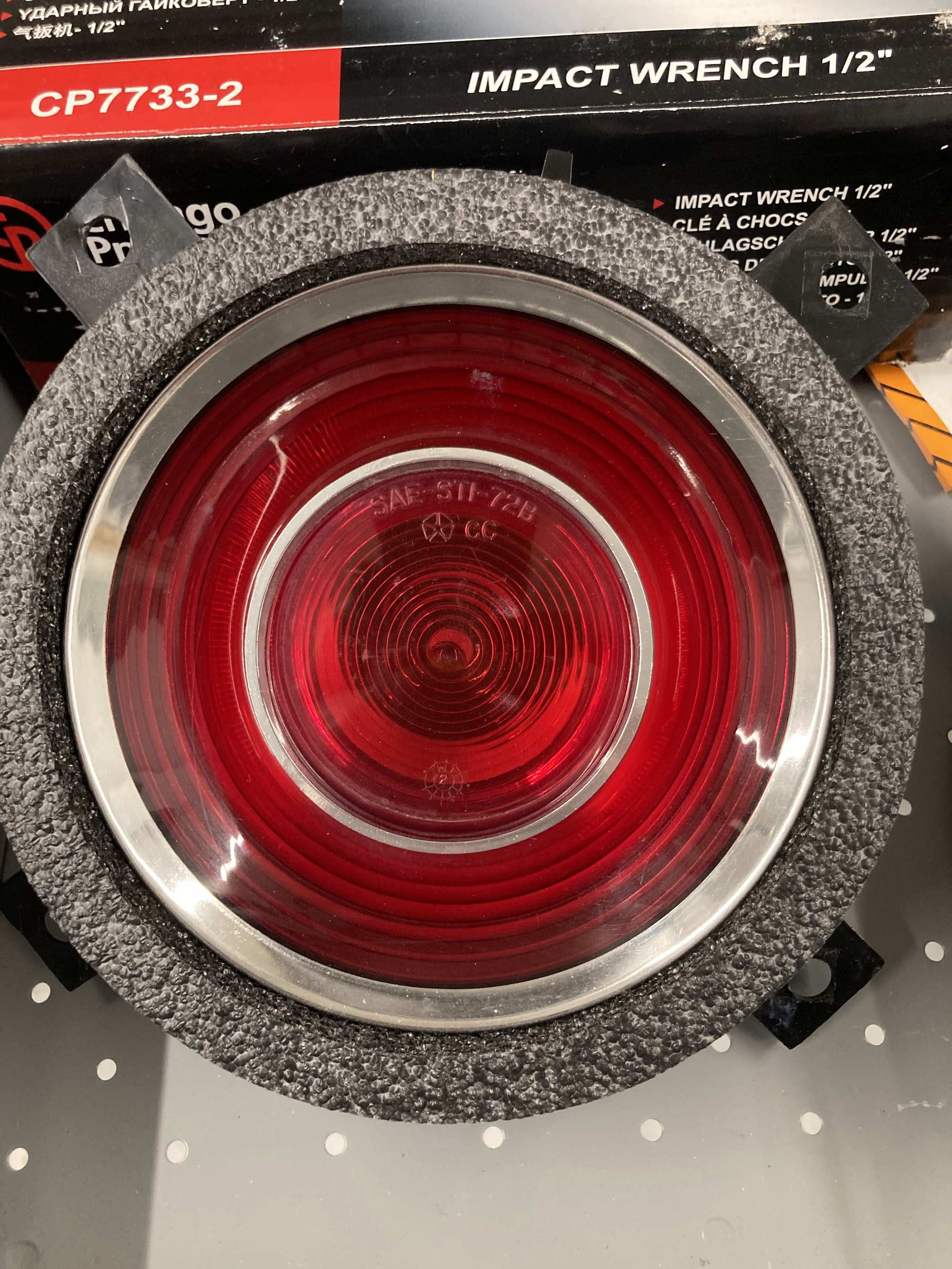

Does anyone have any suggestions on how to attach the round stainless trim rings to the tail lights? The adhesive that was inside the trim rings looked like contact cement but I could not really tell since they are 50 years old and crusty. When I cleaned the glue out with Acetone, the adhesive seemed to get slightly tacky.

I applied the epoxy to the trim ring, attached the trim ring to the tail light and held it in place with masking tape. I cleaned up the excess after the epoxy set up a little but well before it was fully cured.

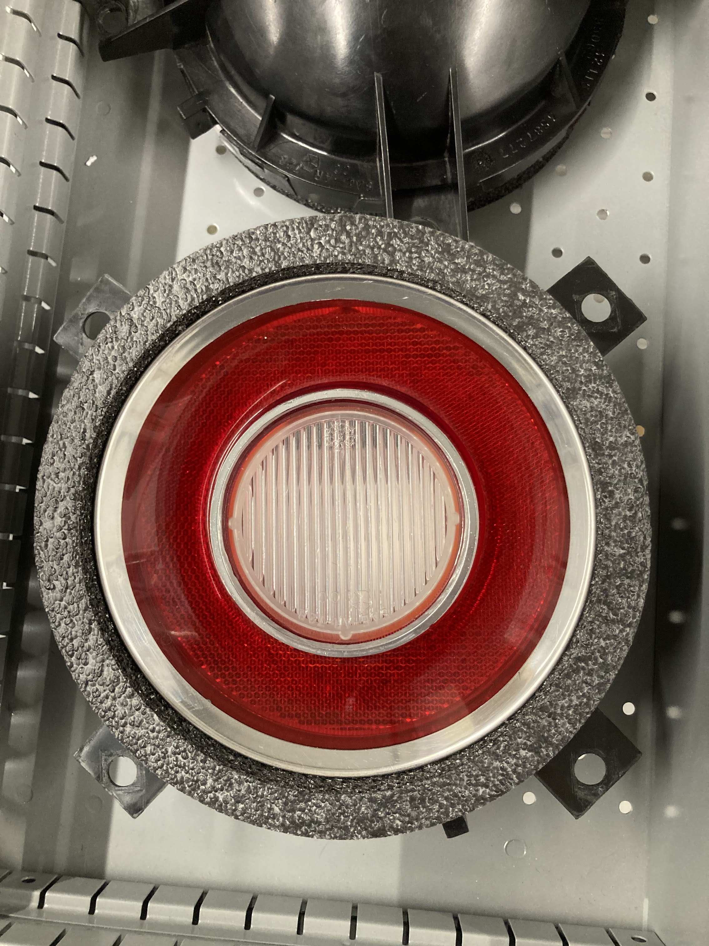

@David DiMartino I used JB weld 2 part epoxy and the trim rings feel as though they are on solid. I could not pull one off. Thanks for the info. The taillights look awesome once again. I used a chrome paint stick, I bought from amazon, to refinish the inner painted circle. IMG_6560.jpgIMG_6561.jpg
