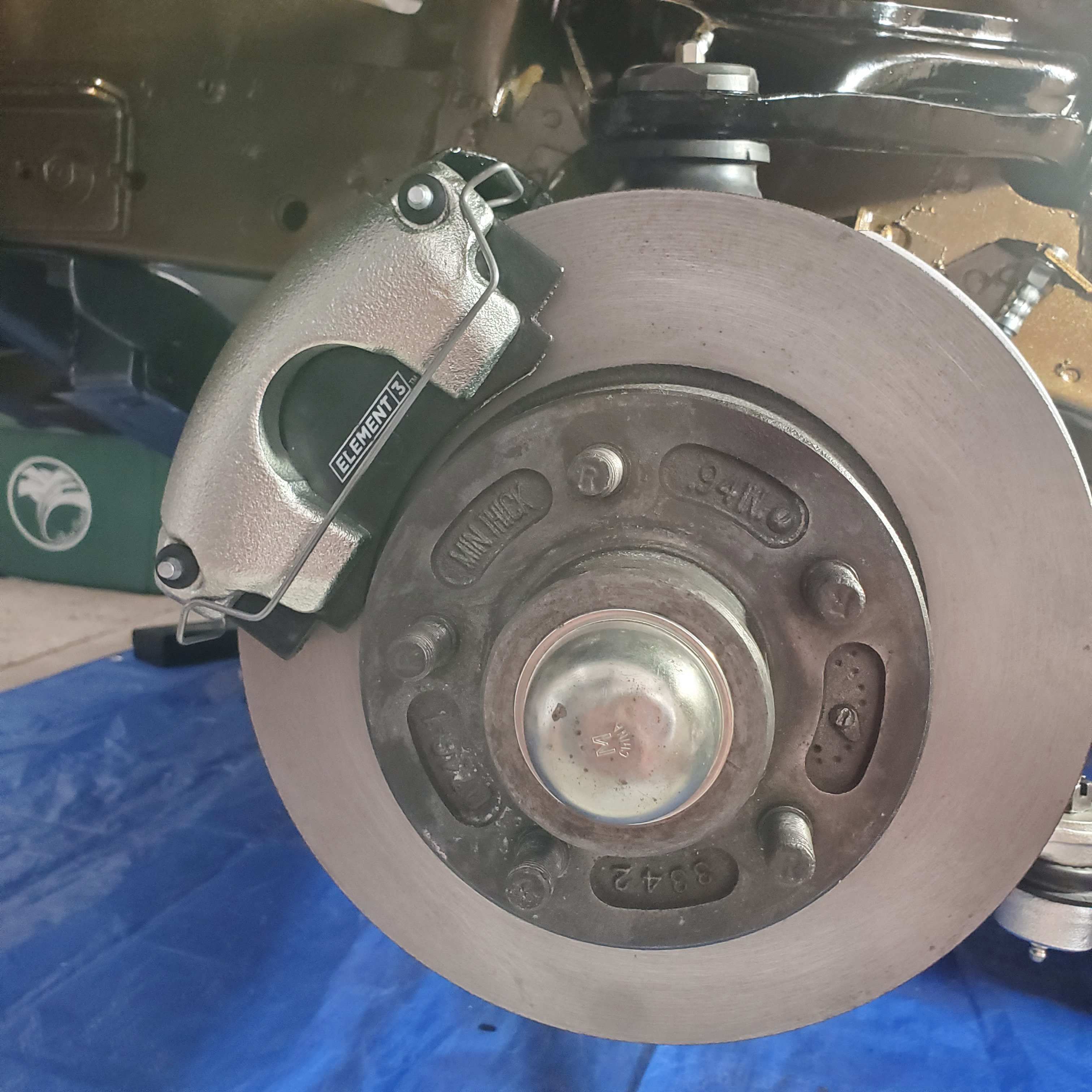

Putting together whole front end. want to make sure of location of calipers. they are either forward or back. Want to make sure i dont have the spindles backwards. I do have the stock replacement brake lines from inline tube Is this picture correct? its about the only thing i could find. Picture has calipers forward

The brake line is located behind the spindle on the chassis , feeds through behind the spindle to the caliper which is on the front side

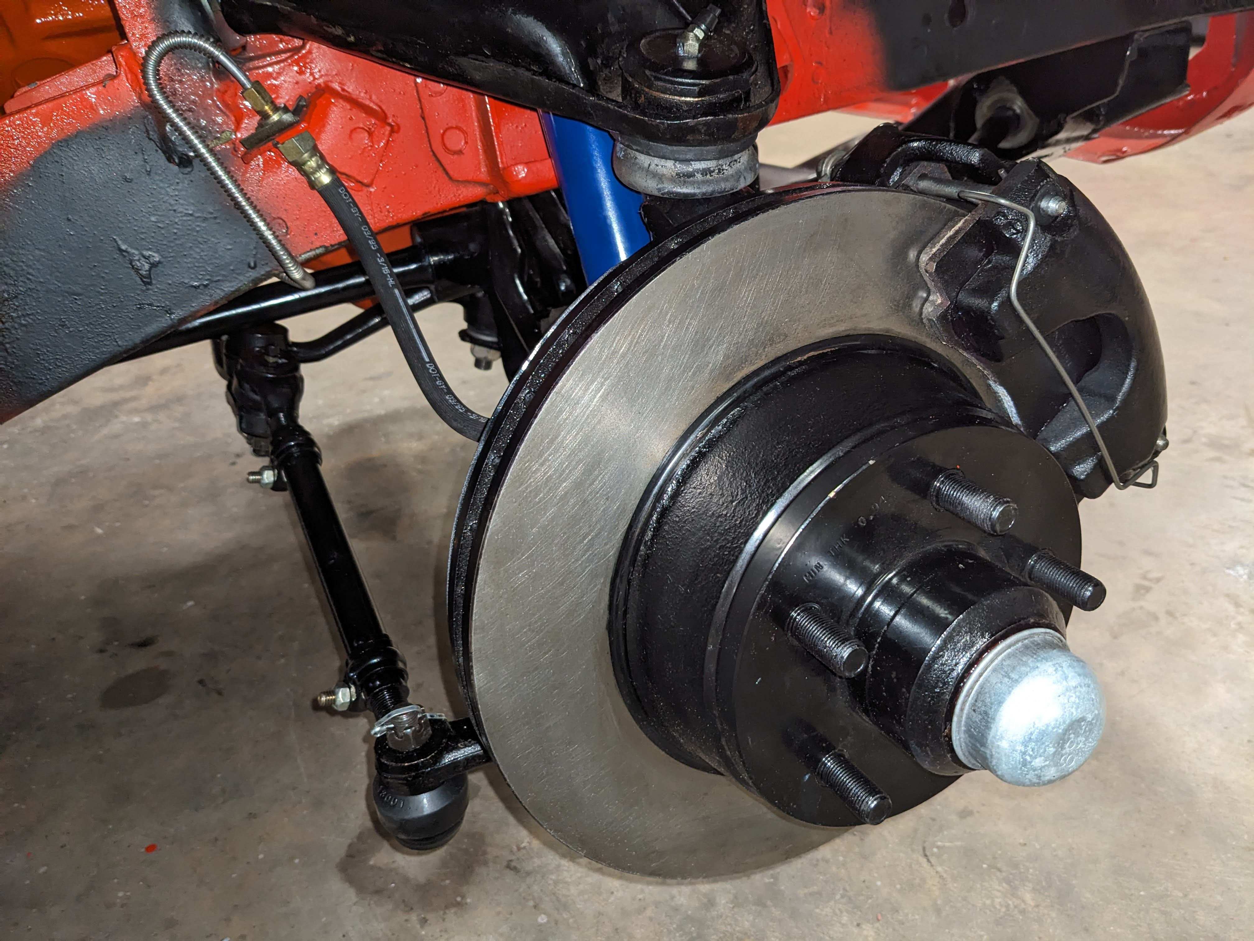

Yes, as noted, forward of the spindle/knuckle, opposite of the brake hose to metal line attachment.
Passenger side:
