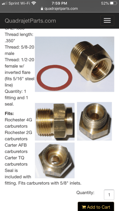

Thanks for the help. I think I’m going to do a stock 5/16 fuel line with a fitting I found that might work connecting it to the carb. It’s a 5/8”-20 x 1/2-20.

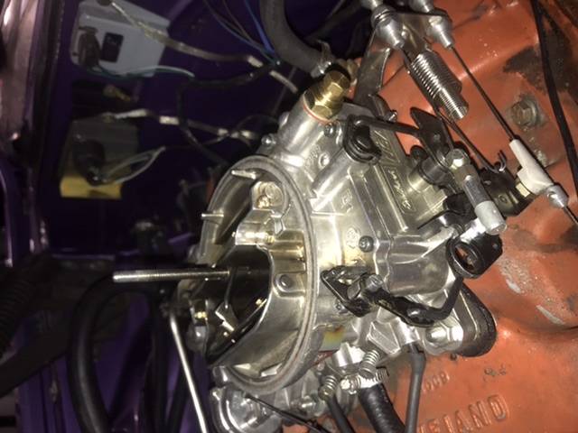

I like the AVS 800. It is easy to tune. I do think I’m running a little rich. I’m waiting for the welding shops to open so I can hook a wideband o2 sensor up and really dial in the carb. I do have a couple of things to note:
1) make sure your fuel pump isn’t pushing over 7 psi. I’m running a Carter 6.5 psi pump. Anything higher and fuel with definitely push past the needles.
2) It is a little finicky when cold if you don’t have the heat risers installed in exhaust manifold and intake. You will need to let it idle to at least 140 to 160 degrees before you try to drive or it will run like crap. With the risers installed, it wouldn’t take very long to get there.
3) I have also installed the Thompson Performance Powerblast Plate. It is really noticeable in throttle response.
To be honest though, I’m curious about trying the AVS 2 with powerblast plate. I hope this helps.

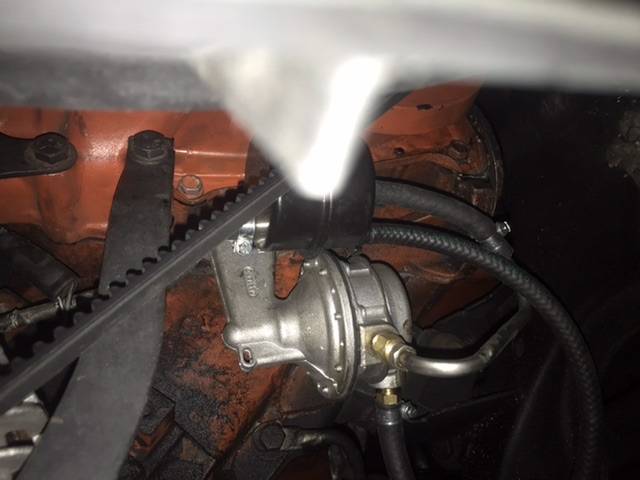

I was previously running an Edelbrock high pressure pump that was pushing over 12 psi. If you have a fuel pump that is below 7 psi, you’ll be fine. Edelbrocks don’t like more than 6 to 6.5 psi. I also have a vapor separator filter between the pump and carb that also returns fuel to the tank. Looks very stock. The Carter pump I listed seems to be highly recommended by guys running stock or very mild street 440s.

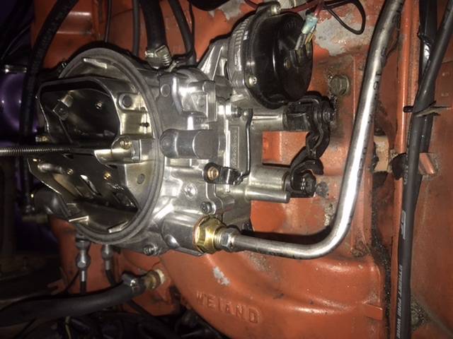

Yeah it should just be the carb to fuel line fitting. The carb should come with a plug for the driver's side fuel inlet.
