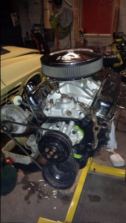

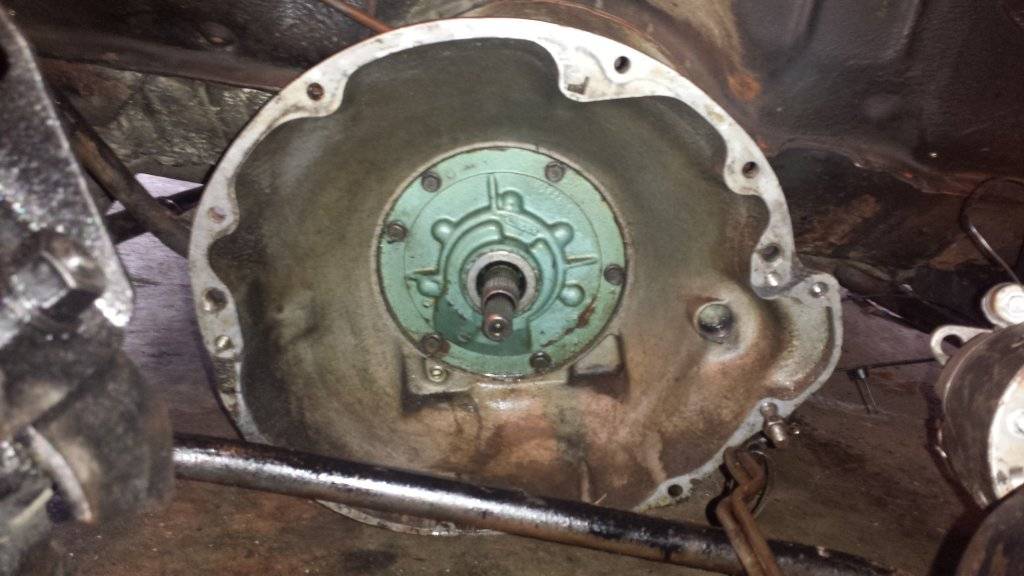

Hi everyone, I am replacing my 318 with a 360 I picked up and had a few questions. My car has the 904 trans and the 727 I got with the motor came out of a 89' dodge truck, the casting # on the trans is PK3898866 5638 7938. I cant seem to decipher this # as I don't know if this is original to the truck as the engine wasn't and if its equipped with OD and requires some kind of modification. I also have a few other questions.
Is the transmission mount the same.
When I get the 727 slip yoke are they all the same and will have any issues with the U joints
Anything else I am missing as I am not too educated in driveline parts.
Thanks in advance.
P.S. The bolt pattern on the bell housing seems to be of a 727 (see pic) from what I found on-line. It threw me off at first as I wasn't expecting to do all this, was I wrong just wondering. Thanks

I'm assuming that the engine and transmission in your pics was bolted together when you got them out of the truck? And that it is going into your Challenger?
Small and big block bellhousing patterns look very similar, and the angle of your pic makes it hard to be sure it is small block. If it was bolted up to the 360 in your other pic you should be fine. Overdrives didn't start until 1990 and were called A518's not A727s. The mostly hollow tail shaft housing of the 727 was replaced by a much larger housing that contains the over drive. Google search the two, the difference is very obvious.
If it is a 727 the main body will fit into the body of your car fine. If you have a slap stick shifter like most ebodies, you will need to track down an earlier passenger car 727 tail shaft housing and internal parking rod. The truck 727's will be missing the mounting boss for the bracket that holds the bottom of the floor shift rod, and the internal parking rods will not work if mismatched. (I know this because I went through the same thing, truck parking rod still attached to the valve body + passenger car tail housing = no park) You will also need a shorter drive shaft as the 727 is longer than the 904 you are replacing. The only difference I know of in yokes is the large vs small u joint. Transmission mounts are exactly the same.

Thank you very much for the information it's very helpful the picture of the transmission is the old one. I believe its at 904 its only 30 inches long. I got the 727 transmission with the engine I picked up and like I said it was out of the truck and I was going to mate them together and just put them in and shorten my driveshaft I know I have to get a new slip yoke for it and I'll check the connecting rod like you mentioned hopefully I can get this puppy fired up. Hopefully I'll get some time to try it out this week I'll let you know what happens thanks again appreciate it
