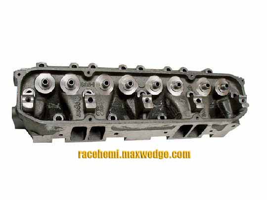

Hi there..l recently picked up a 69 ish year 383...the casting numbers in the heads seem to read they are off of a 1964 426 max max wedge...does that make any sense...l found that strange..any thoughts..??

what are the numbers?

I’d be willing to bet that they may look like 518s but are probably 516s.

I thought the same so l went and took a real hard look...l may have pop em off...that Being said...would they even work..??.. Look

I know the intake ports are huge/tall so without the rest of the appropriate max wedge parts they’re useless but valuable to the right person.

B/RB Big-Block Mopar Cylinder Head Casting Numbers
1406740 – 1958-1959, 361 B/RB-series big-block, 1.94/1.60 valves, HD, Truck
1737622 – 1958-1960, 350/361/383 B/RB-series big-block, 1.94/1.60 valves, 73.5cc
1737635 – 1958, 350/36, B/RB-series big-block, 1.94/1.60 valves, 73.5cc
1737637 – 1958-1959, 361 B/RB-series big-block, 1.94/1.60 valves
1844705 – 1958-1959, 350/361/383, B/RB-series big-block, 1.94/1.60 valves, 73.5cc
1851524 – 1958-1971, 350-413 B/RB-series big-block, Truck
2202594 – 1958-1971, 350-413 B/RB-series big-block, Truck
1944705 – 1958-1959, 361 B/RB-series big-block, 1.94/1.60 valves
1851509 – 1959, 361/383/413 B/RB-series big-block, 2.08/1.60 valves, HP
1737637 – 1960, 383 B/RB-series big-block, 1.94/1.60 valves
2264547 – 1960-1971, 361/413 B/RB-series big-block, Truck
2128521 – 1960-1961, 361/383/413 B/RB-series big-block, 2.08/1.60 valves, 73.5cc, 300F
2128522 – 1960-1961, 361/383, B/RB-series big-block, 1.94/1.60 valves, 73.5cc
2899913 – 1960-1971, 413 B/RB-series big-block, Truck
2206324 – 1961-1962, 361/383/413 B/RB-series big-block, 2.08/1.60 valves
2206924 – 1961-1962, 361/383/413 B/RB-series big-block, 2.08/1.60 valves, 73.5cc, 300H
2402286 – 1962, 413 B/RB-series big-block, 2.08/1.88 valves, Max Wedge, 81cc
2402557 – 1963, 413 B/RB-series big-block, 2.08/1.74 valves, 73.5cc, 300J/early K
2406209 – 1963, 413 B/RB-series big-block, 2.08/1.88 valves, Max Wedge, 81cc
2406740 – 1963-1968, 361, 413 B/RB-series big-block, Truck and Marine
2463209 – 1963, 426 B/RB-series big-block, 2.08/1.88 valves, Max Wedge
2463200 – 1963, 361/383/413 B/RB-series big-block, 2.08/1.60 valves, 73.5cc
2406516 – 1964-1967, 361/383 B/RB-series big-block, 2.08/1.60 valves, 73.5cc, 300L
2406518 – 1964, 426 B/RB-series big-block, 2.08/1.88 valves, Max Wedge, 86cc
2408520 – 1964, 413 B/RB-series big-block, 2.08/1.60 valves, 73.5cc, 300K w/ Ram intake
2268341 – 1965, 426 B/RB-series big-block
2406780 – 1965-67 383 B/RB-series big-block, Truck
2406158 – 1967, 440 B/RB-series big-block, 2.08/1.60 valves, 73.5cc
2708915 – 1967 440 B/RB-series big-block, 2.08/1.74 valves, 73.5cc, HP
2780915 – 1967, 440 B/RB-series big-block, 2.08/1.74 valves, HP
2843906 – 1968-1970, 383/440 B/RB-series big-block, 2.08/1.74 valves
2951250 – 1968, 440 B/RB-series big-block, 2.08/1.74 valves, 79.5cc
3462346 – 1971-1972, 383/400/440 B/RB-series big-block, 2.08/1.74 valves, 79.5cc
2466676 – 1971-1977, 361/413 B/RB-series big-block, Truck and Marine
2899943 – 1971-1977, 361/413 B/RB-series big-block, Truck
3462345 – 1972-1973, 400/440, B/RB-series big-block, 2.08/1.74 valves, Emissions
3462346 – 1973, 400/440 B/RB-series big-block, 2.08/1.74 valves. 81.5cc
3751213 – 1973, 400/440 B/RB-series big-block, 2.08/1.74 valves, Motor Home
3769902 – 1974, 400/440 B/RB-series big-block, 2.08/1.74 valves
3769975 – 1975, 400/440 B/RB-series big-block, 2.08/1.74 valves, 83.1cc
4006452 – 1976-1978, 400/440 B/RB-series big-block, 2.08/1.74 valves, 81.5cc
4021051 – 1977-1986, 360 B/RB-series big-block, 1.88/1.60 valves
2806887 – 426 B/RB-series big-block, Marine and Industrial
3614476 – MOPAR Stage IV, B/RB-series big-block, 2.08/1.74 valves
4286526 – MOPAR Stage V, B/RB-series big-block, 2.08/1.74 valves

2406518...l am at work right now l bet you are right..the 8 is a 6 not the first time that's happened..and the ports don't look huge to me...l may just pop a head off to get a perfect look at the numbers...

They also don’t have the exhaust crossover port on the intake side. You shouldn’t need to completely remove them to determine what you have. I mean look at those intake ports.

I will check when l get home but l think they have the crossover port...that would end that...thanks...l will let you guys know..thanks for your help..
