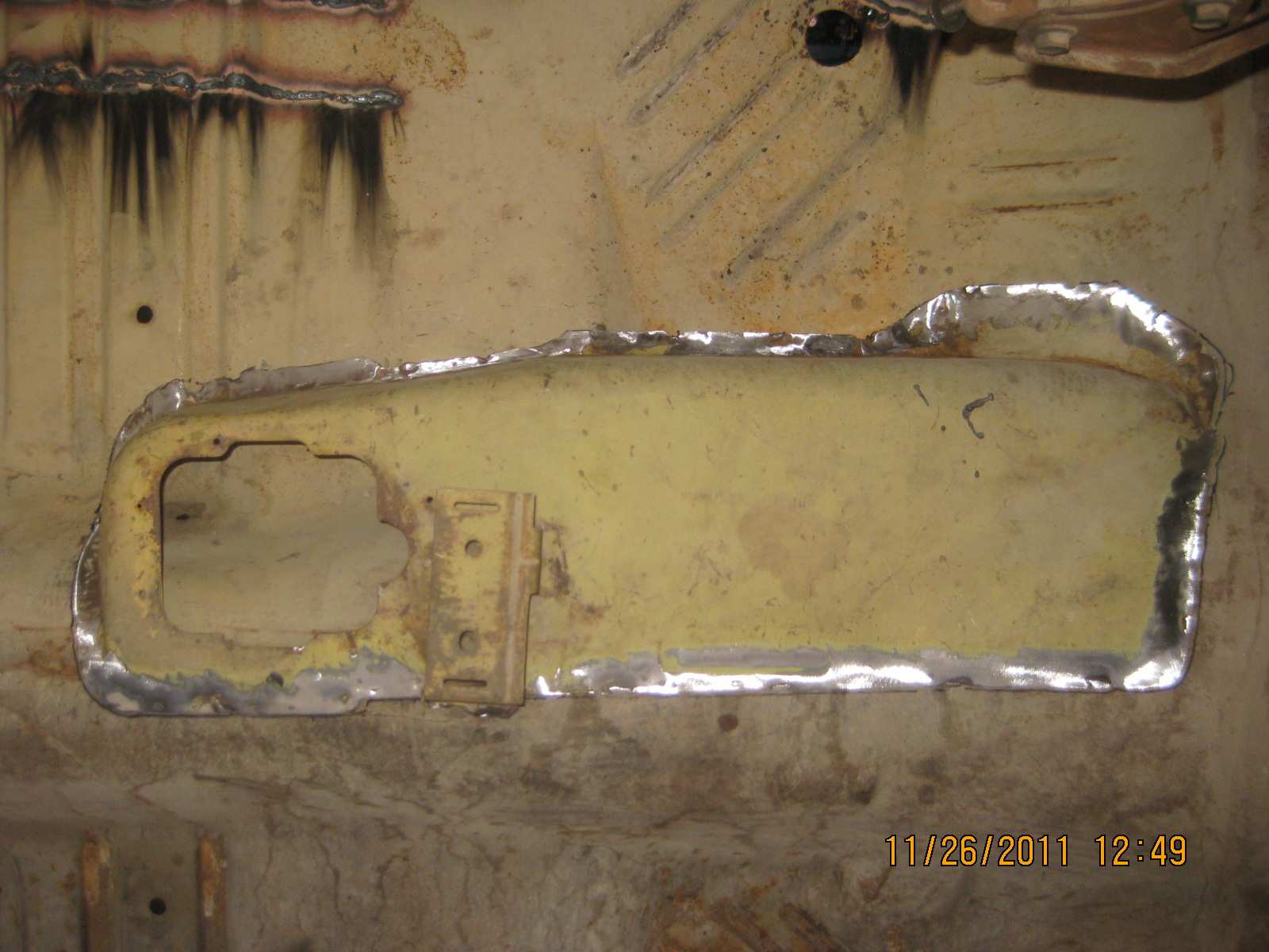

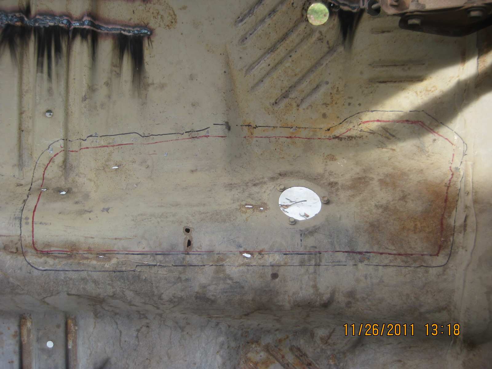

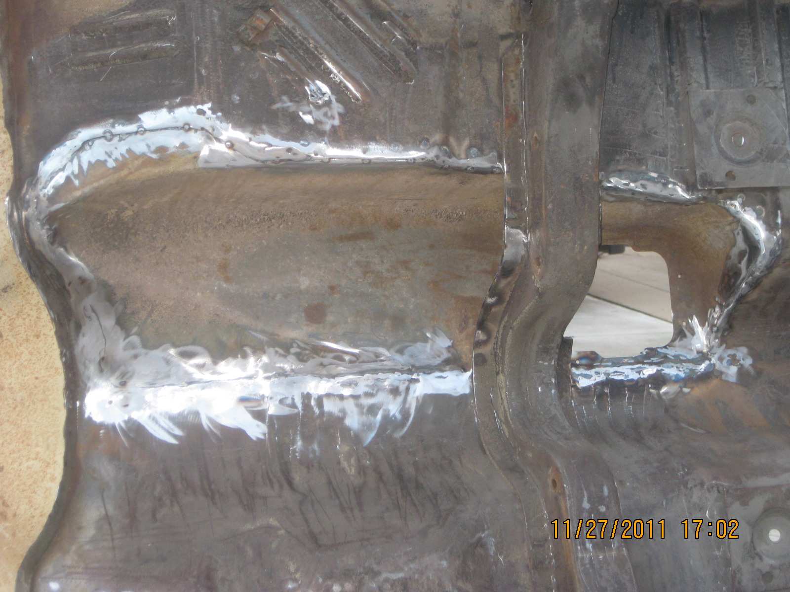

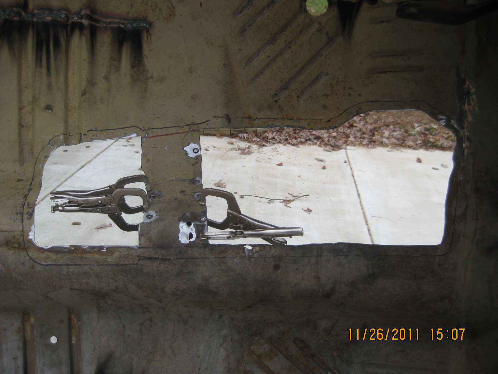

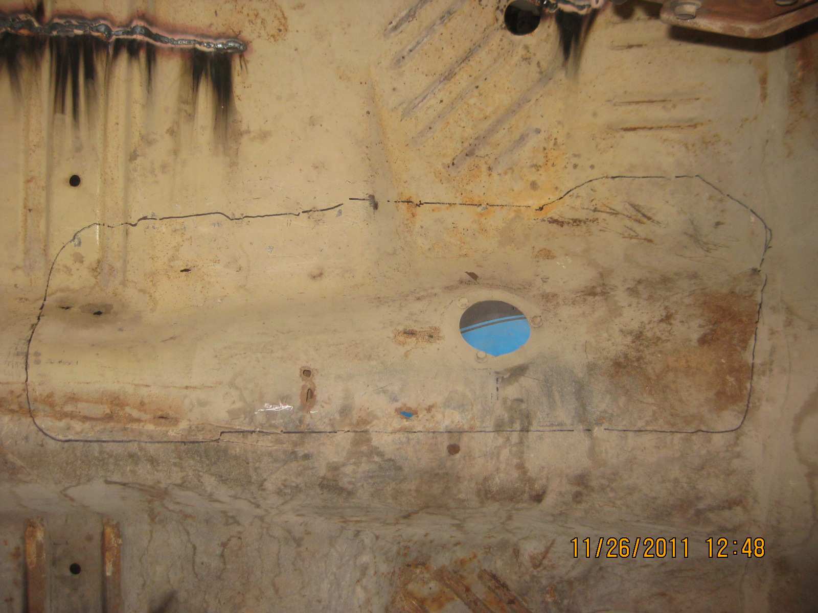

Thanks, so factory was spot-welded and sealed with seam sealer.
Yes
Leave the portion of the original pan in place that covers the cross member piece.
I put the hump on the automatic floor pan and traced the flange. Offset from the tracing using the width of the flange then made my cuts. I made some plug welds in the piece of the original pan to secure it to the cross member.
Attached are some pictures of my long stalled project.

Yes
View attachment 119206View attachment 119207
View attachment 119208View attachment 119209View attachment 119210
I saved your pics from a different thread. Thanks!
