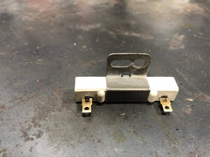

You need a lot more that eight volts at the coil with engine running. Charging at 14.2-14.4, you should have 11-12vdc at coil. Don't freak on what should work, freak on what DOES work. You have the wrong resistor. There's an old saying in motorcycle mechanics: "90 percent of carburetor problems are caused by the ignition system".

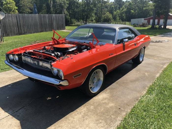

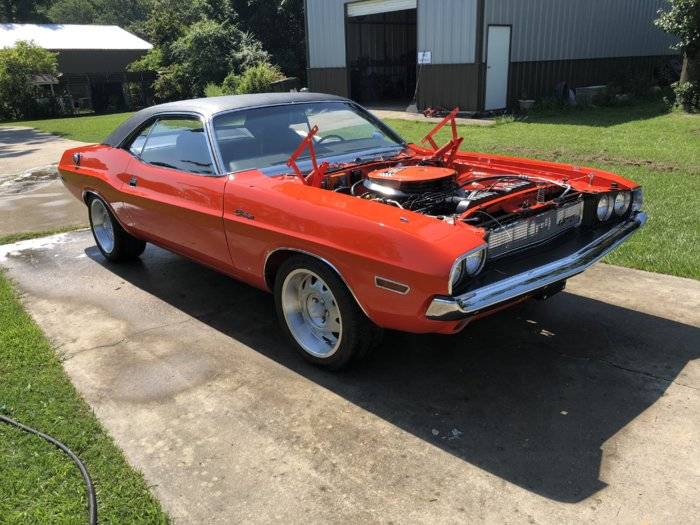

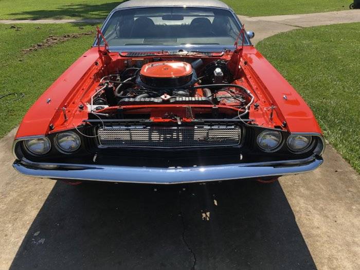

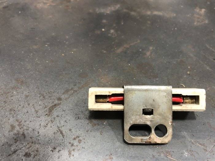

UPDATE!
Well the challenger is running better now at least it doesn’t shut down in 10 minutes. Changed spark plugs to champion J12YC’s installed new FBO ecu and flame thrower coil, bypassed the resistor (see photo). Also tuned carbs some more. The back carb was rich had to adjust the mixture
screws on the bottom. I still don’t think I’ll ever get rid of the gas smell though. Now my new problem is when I give it some gas on the road the motor starts detonating and pinging. I got around 15 degrees initial timing because it has good idle and vacuum there. I guess I’m might have to lock out the mopar electronic distributor with one of those lock plates from FBO. I’ll keep plugging though getting closer to the finish line with this challenger.

I'm gonna go out on a limb here, as I have heard that Mopars ran more ignition lead because of the gear reduction starters, but 15 sounds like a lot of lead. If it's pinging, there's either too much initial lead, or high-compression/fuel octane. Try it at 10-12. The bumped up initial timing may be masking some carb imbalance or vacuum leaks. At least you can now drive it...
