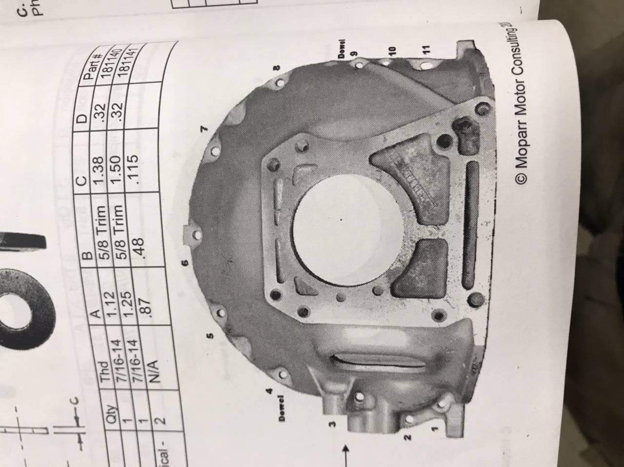

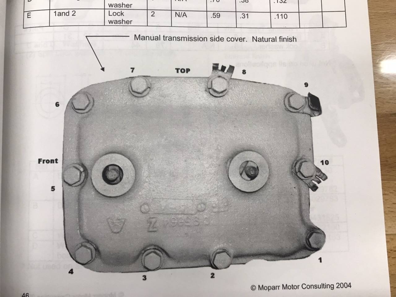

I purchased a new 4spd neutral safety switch wiring harness from M&H-Yearone and I'm missing the three clips to hold the taped wires from flapping in the breeze or interfering in the shift linkage. I'm aware they sell the clips but I am searching for the exact location of these clips on the bellhousing and A833. Can anyone provide a photo of theirs and the proper location of them. This isn't something you see talked about often and I can't find anything in my manuals or the internet.

Pics from the MMC fastener guide. The clip at position #9 on the trans side cover plate is also used on the bellhousing. I believe it goes in position #7 on a small block bell. Not sure about big block.
