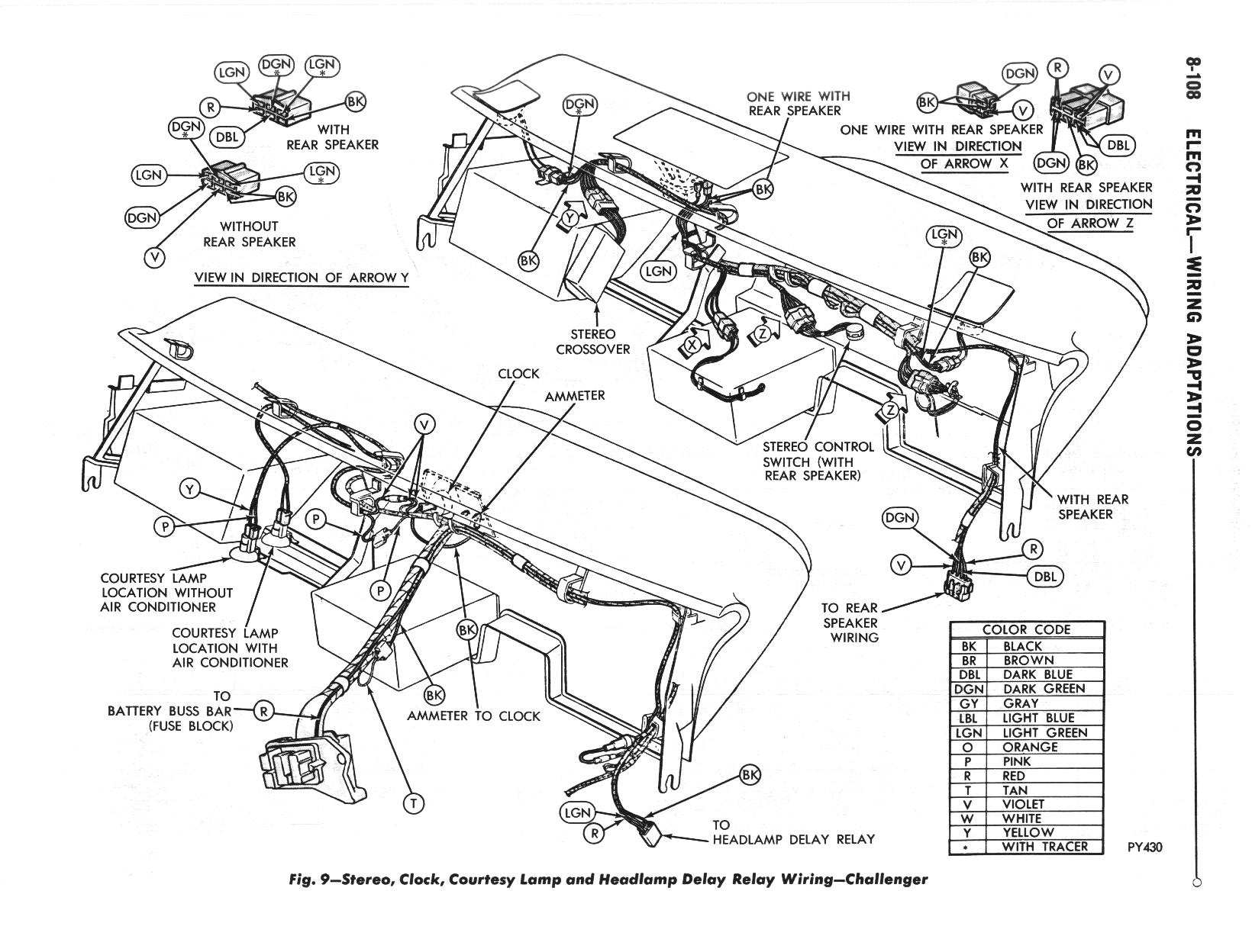

Does this help? I'm guess the knob labeled "SPEAKER" is the fader knob.
