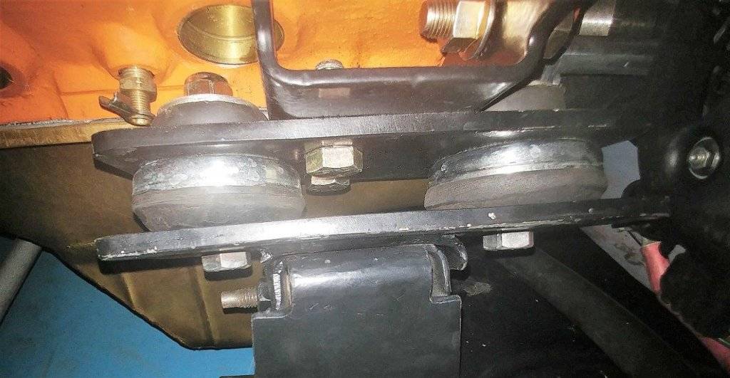

My captured rubber while not pretty seem to be handling the torque for now
Be careful Brian I have heard of blocks being damaged by solid engine mounts so don't make it too stiff, easier to replace a torn mount then a torn engine block.
Absolutely. Next step is motor plate. But I digress. Torque strap of any type is better than nothing. You can go as far as you wish. Your car.
They are actually quite soft good range of movement (OFF the old Lincoln diesel SAE400 amp welders) i have a laser cutter so i was going to try putting longer studs in the 1st & 2nd outside head bolt hole rather than swing any more off the engine mounts
