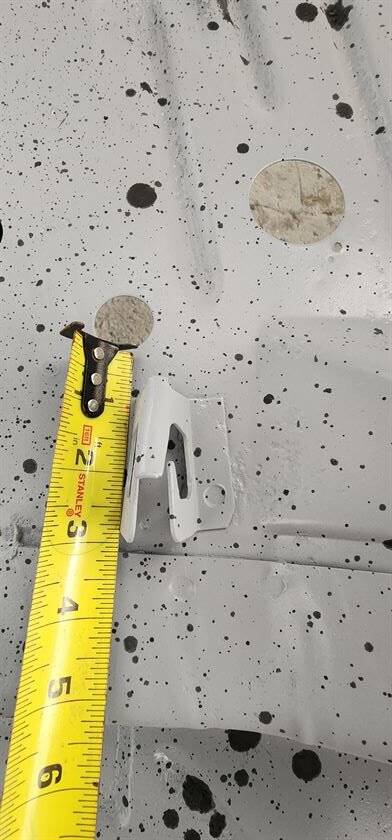

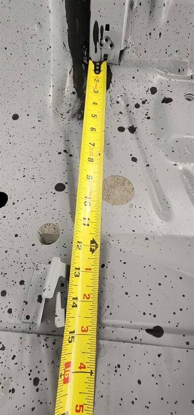

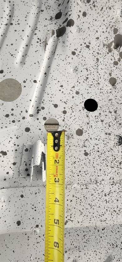

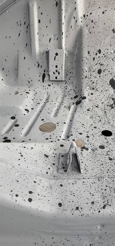

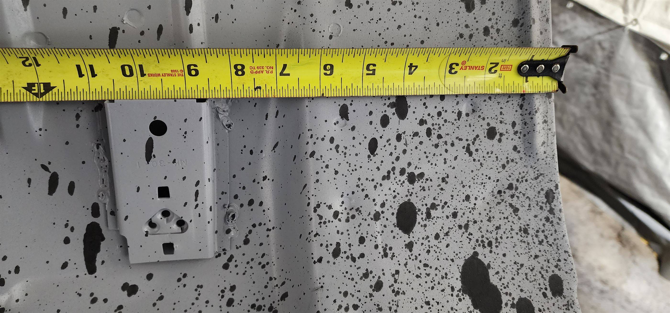

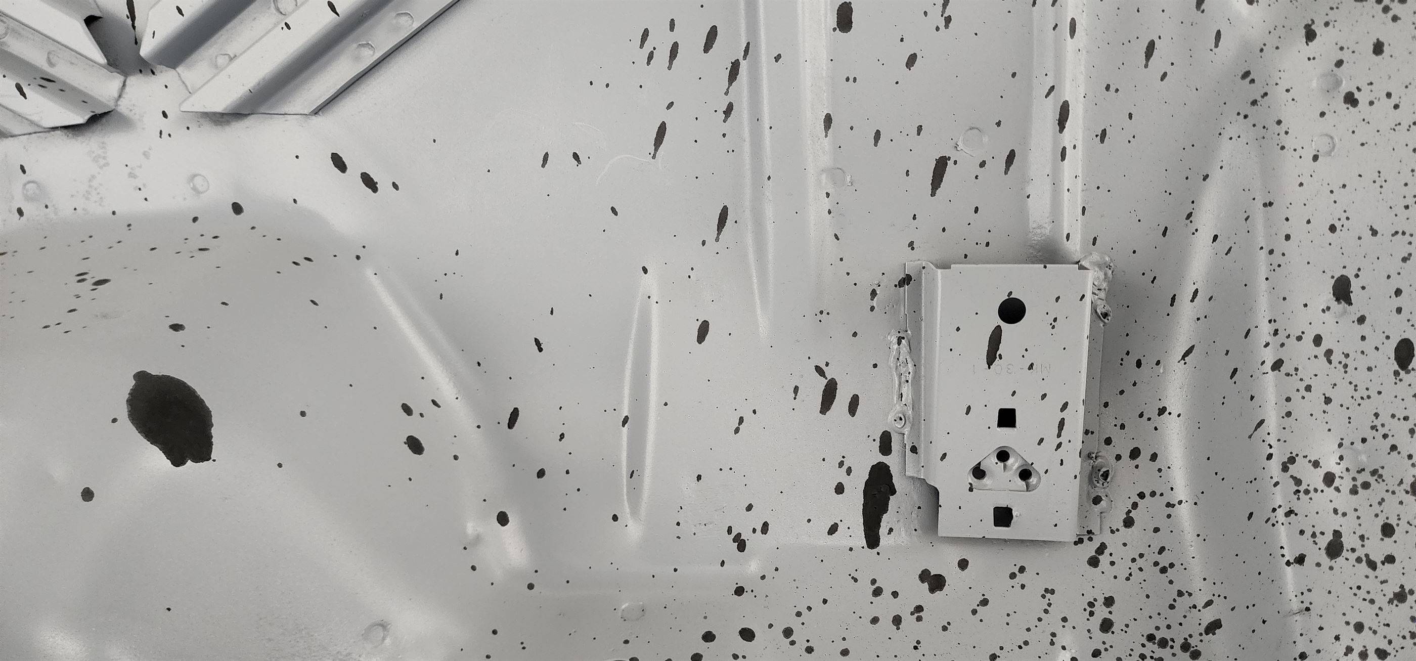

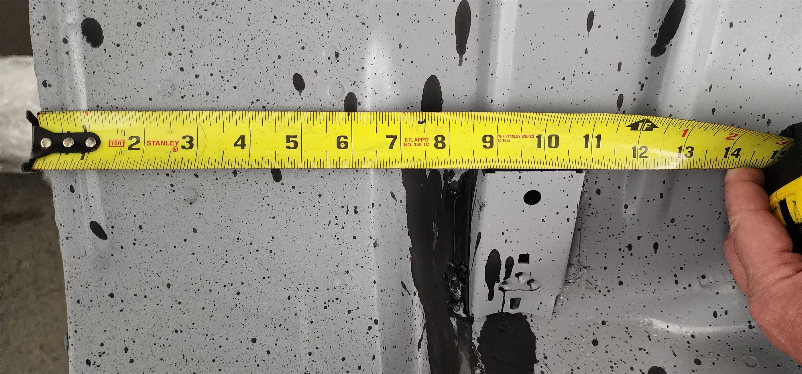

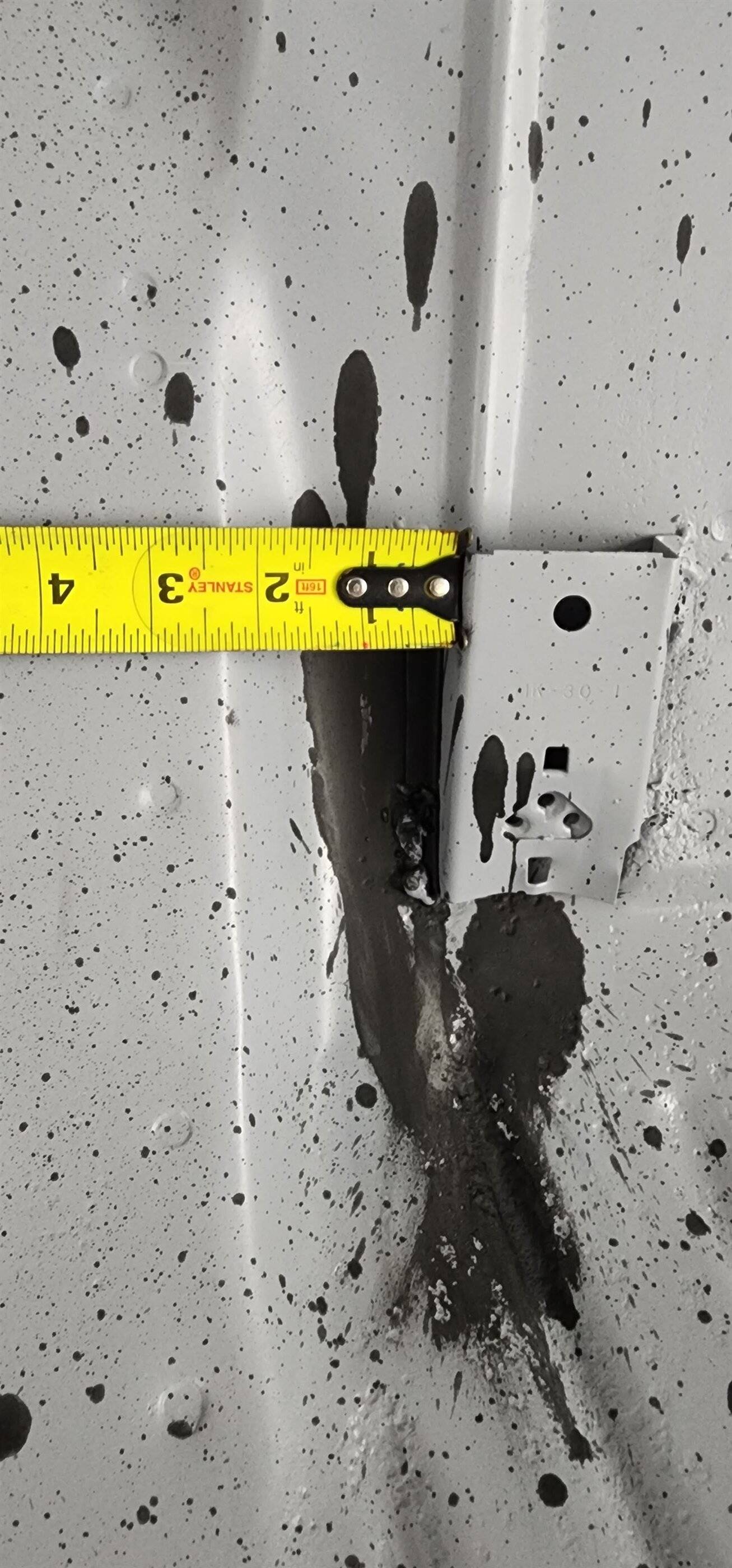

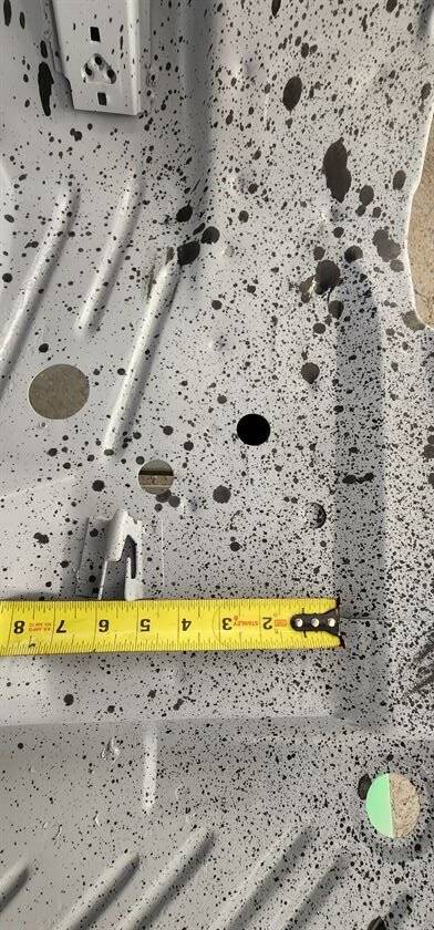

(Disregard the black paint mess from treating the insides of the pillars and frame. The 360 degree paint nozzles make a mess!) These photos are of a '70 'cuda. It looks like the brackets are on 26" centers, and are positioned on a recess adjacent to where the rear frame rails are spot welded on the inside of the rear floor pan. See photos, and let me know if you need anything in addition.

Hey WD, thanks much but obviously I described it wrong, I need the parts that are on the floor pan that the bottom of the back seat hooks into. The photos you sent are very helpful but are the upper back seat mounting tabs. If it is not to much trouble can you send the same info on those? Again, much appreciated.

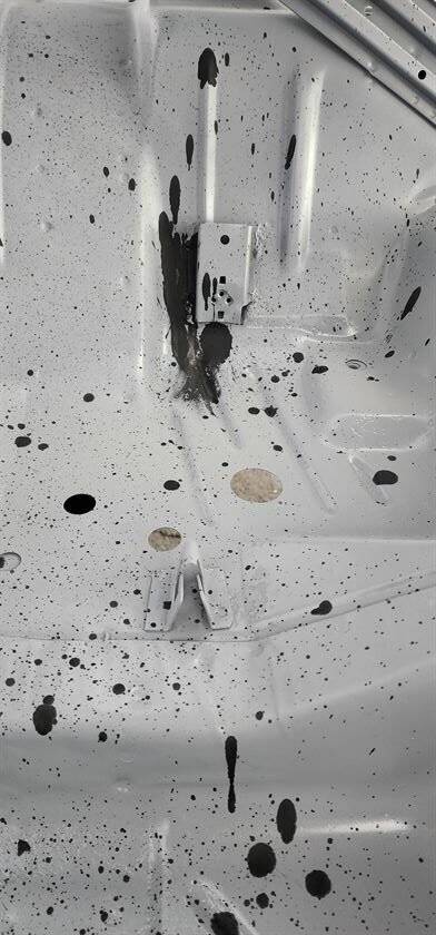

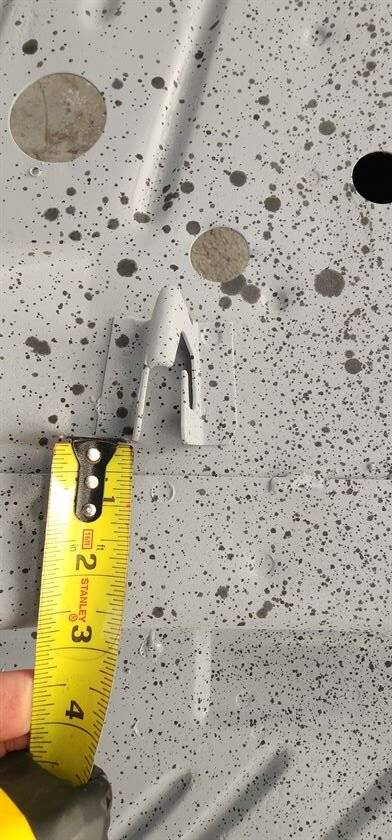

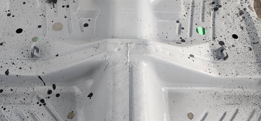

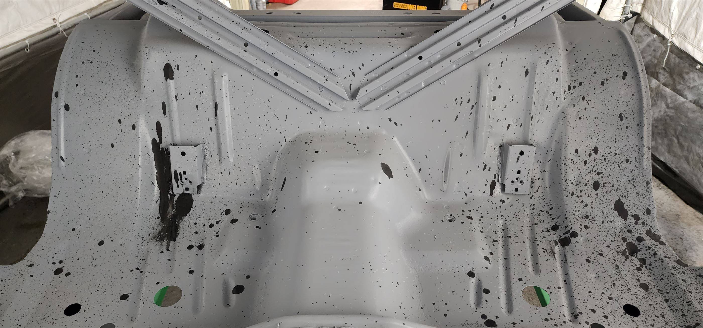

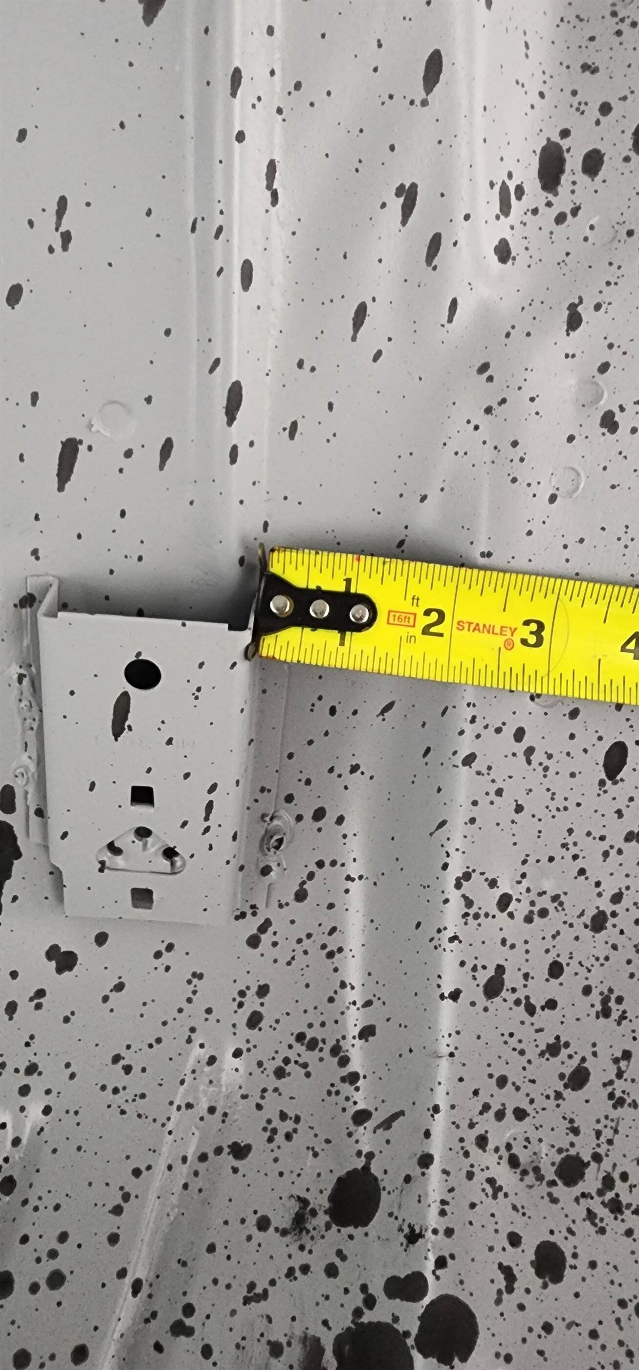

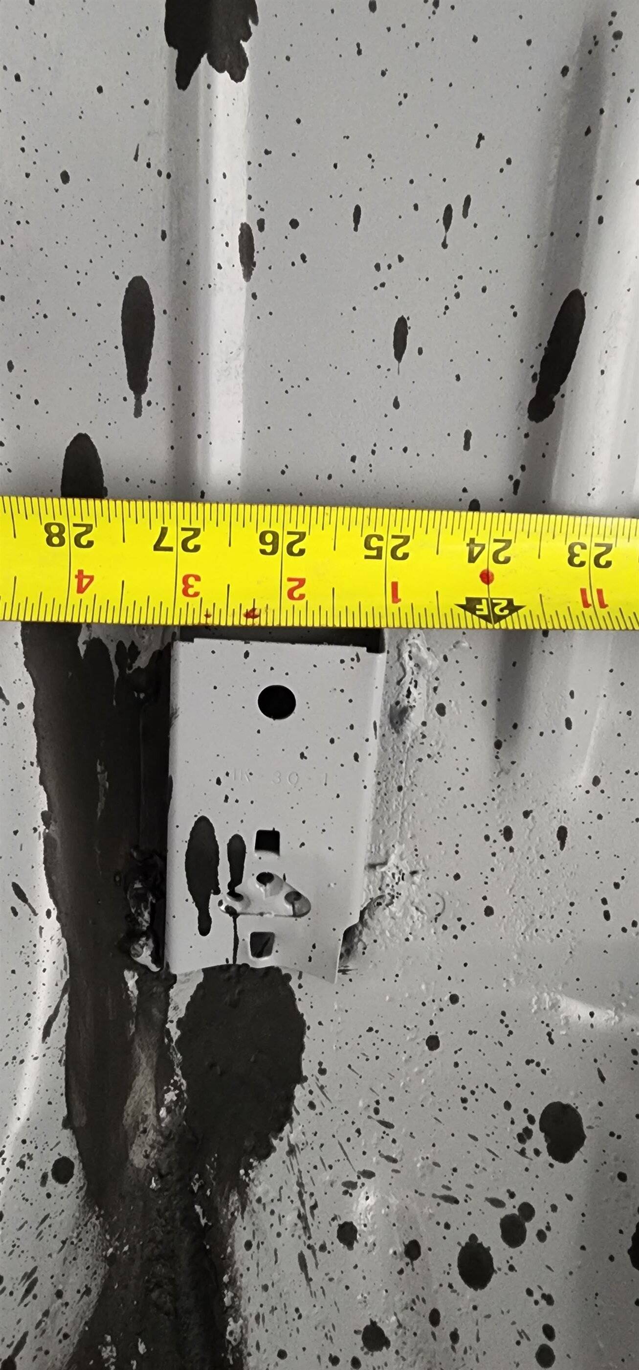

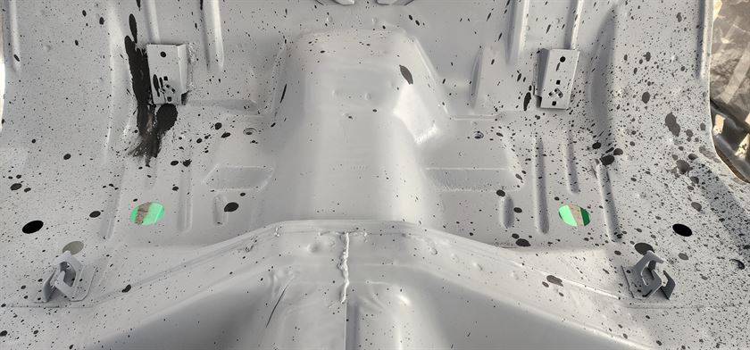

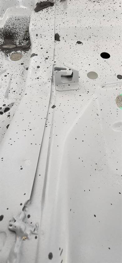

Looks like the hooks are on 28 3/8" centers from one another. I believe as long as you use this centering, you can use the raised ridge stamped into the lower seat floor panel for alignment. See photos, and let me know if you need anything in addition.
