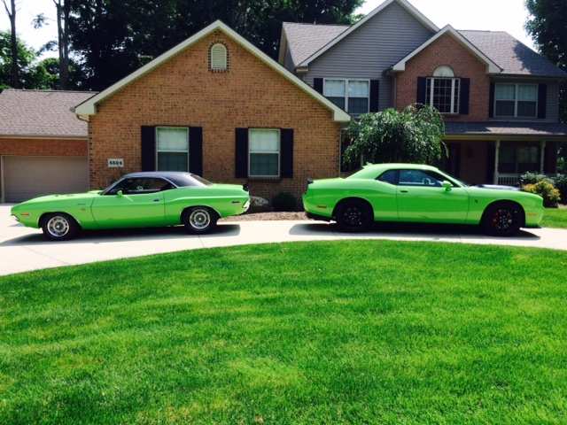

Hi everyone who appreciates E-Body MOPAR. I was influenced by a high school friend who had a 1969 Plymouth GTX with a 440. He would let me ride along when he drag raced people outside of town. I loved the feeling of the torque and have been a Mopar fan ever since. I currently own a 1970 Dodge Challenger and in the middle of building a more powerful engine for it. I purchased the car in 2003 and have enjoyed it for over 20 years now. However the near stock 440 is not very exciting anymore, especially since I purchased the somewhat matching colored Hellcat in 2015. In hopes to increase the joy of driving the 1970 Challenger, I have purchased a set of Trick Flow 240 heads, Comp Cams extreme energy solid lift roller cam 236/242, H beam rods, 10.5:1 pistons, 1-7/8" Headers, MSD ignition, and have a six pack set up for it. Any ideas regarding the horsepower output? Has anyone ever built a similar combination?

Welcome to FEBO from the desert! Nice looking pair of Challengers.
Wild ass guess, assuming everything is right, about 550hp for your 440. Make sure you have good brakes!

Welcome to the site from Michigan!
Very nice "new and old" Challengers. Great color!

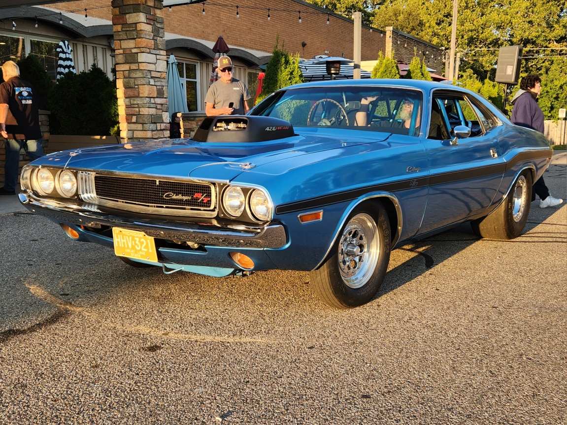

6PKRTSE
Feb 3, 2010
848
447
Nice Challengers. I have a new and old pair also. I was looking for a B5 blue newer Challenger to match my 70 but they always seem to be around 5K more than other colors. However, the 12' Blue Streak Pearl caught my attention.
