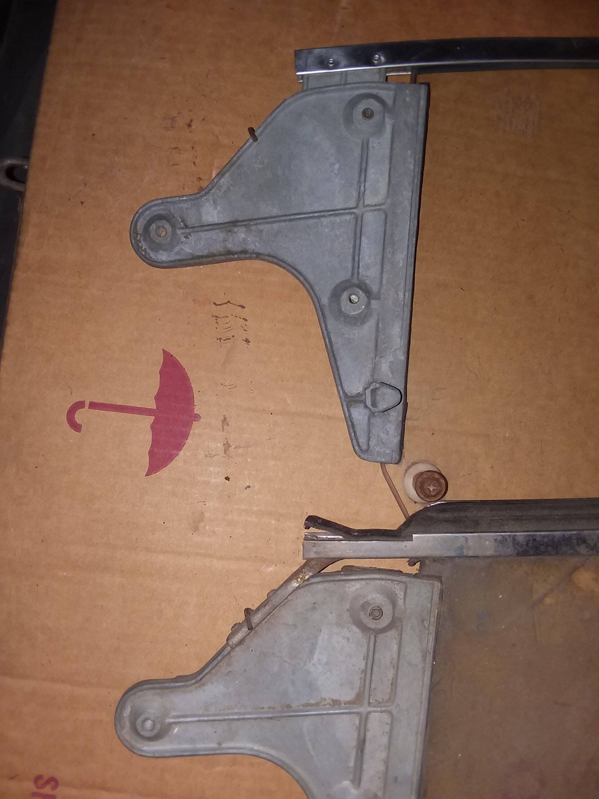

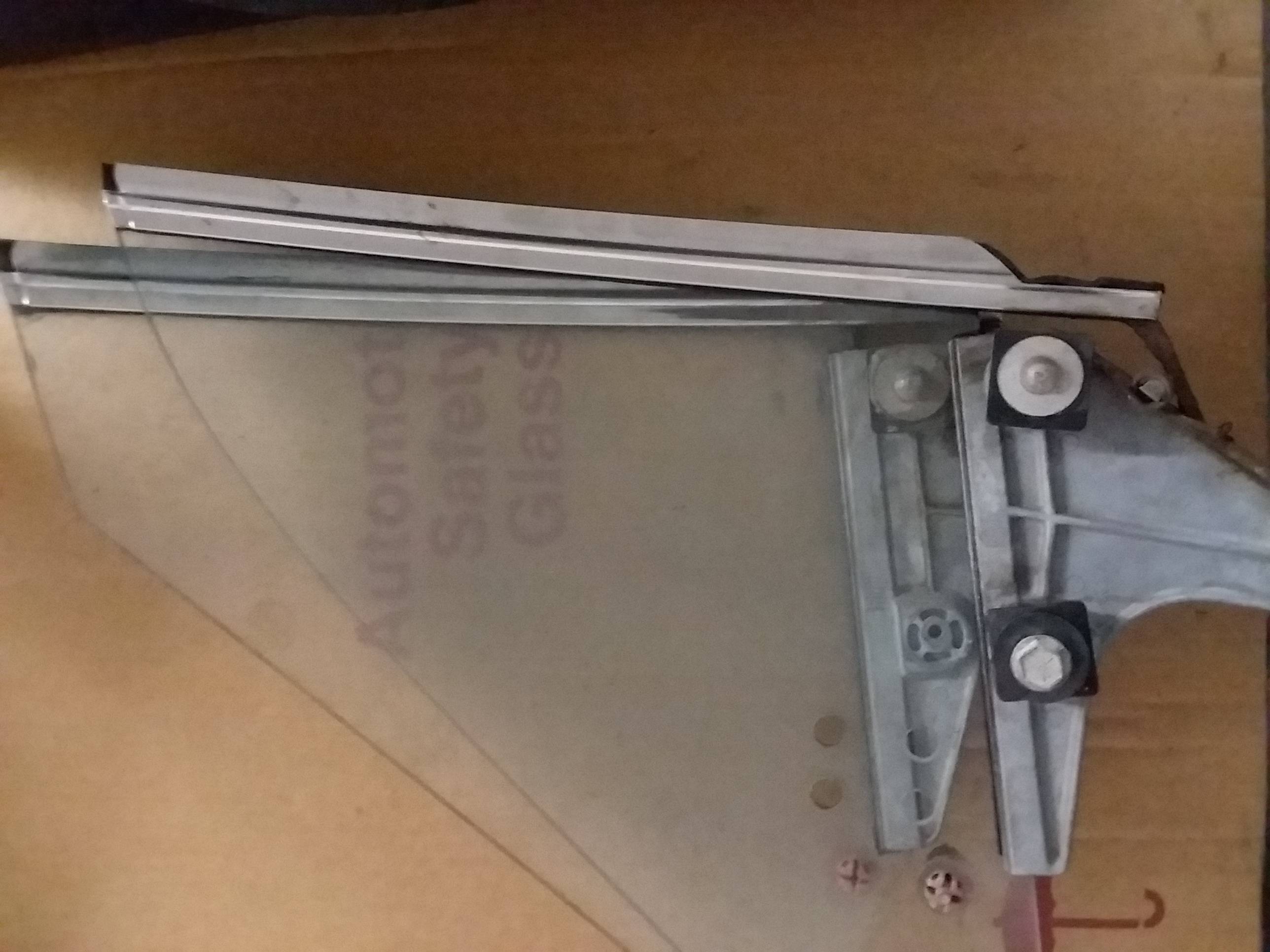

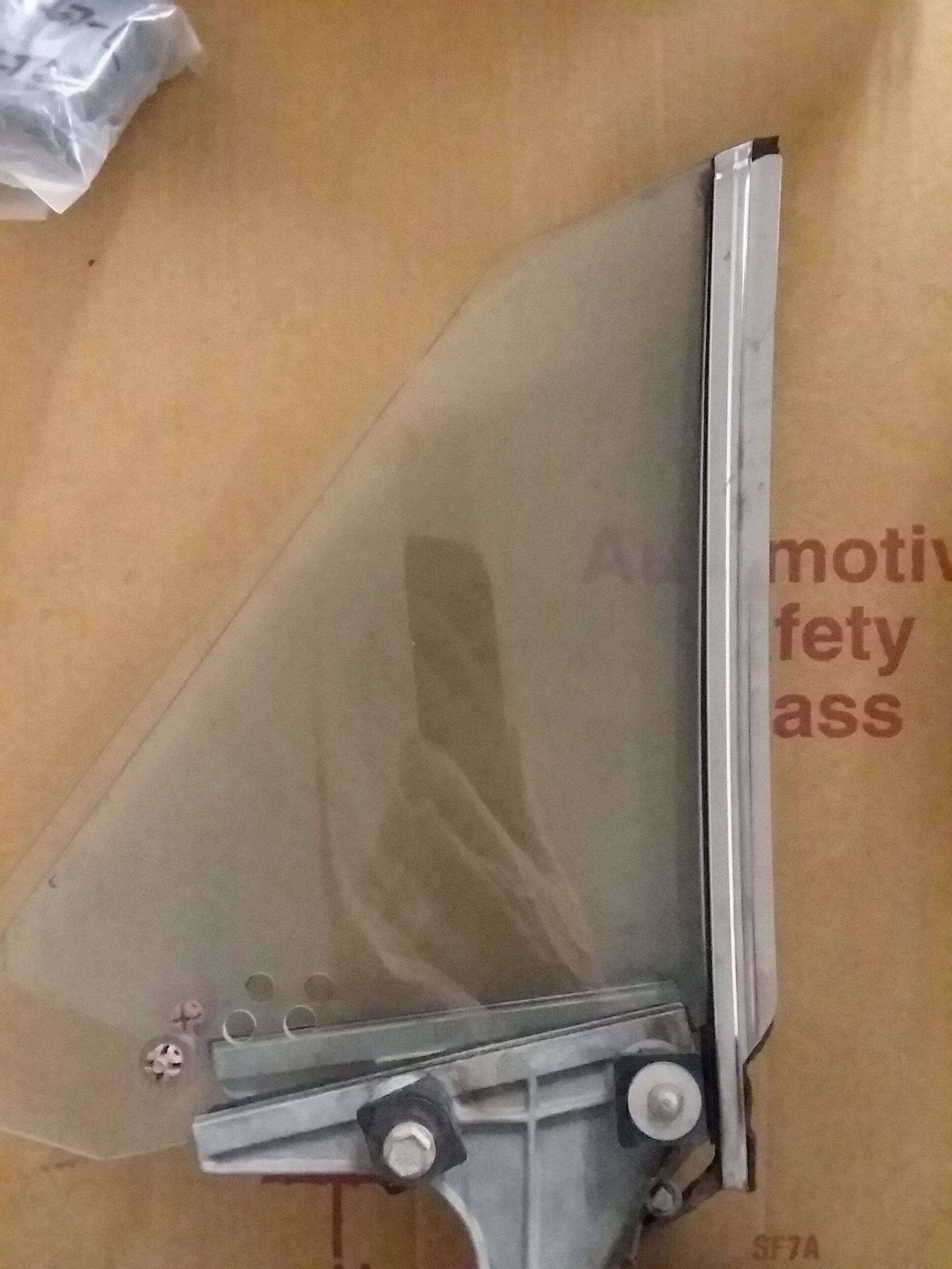

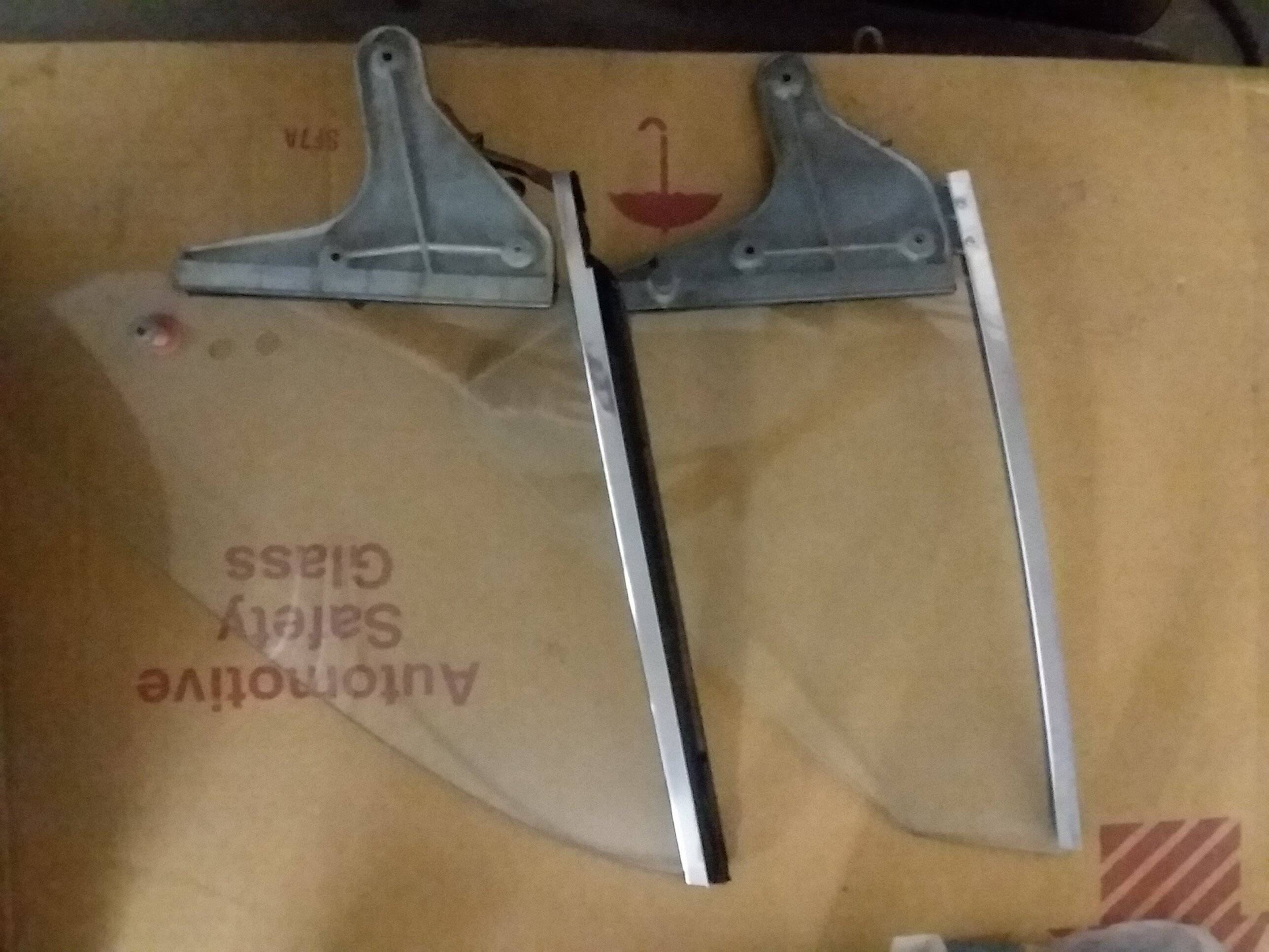

Apr 26, 2023 #1 Pepe70 Well-Known Member Joined Nov 28, 2018 Messages 121 Reaction score 10 Location San diego california Is the 70 challenger and barracuda quarter glass frame and molding the same?
Apr 26, 2023 #2 Mr Cuda Well-Known Member Joined Jan 26, 2022 Messages 227 Reaction score 113 Location North of Seattle No,... different. Angle, chrome length, up stop missing.
Apr 26, 2023 #3 Pepe70 Well-Known Member Joined Nov 28, 2018 Messages 121 Reaction score 10 Location San diego california The one on the left is for 70 challenger (one year only) The one on the right is for 71-74 barracuda. Any way I was thinking that the frame and the vertical molding is the same on 1970 challenger and barracuda.
Apr 26, 2023 #4 Mr Cuda Well-Known Member Joined Jan 26, 2022 Messages 227 Reaction score 113 Location North of Seattle Just for you, i went and got a 70 barra to compare. Now, were you just going to swap the 70 style chrome over to your glass?
Apr 26, 2023 #5 Mr Cuda Well-Known Member Joined Jan 26, 2022 Messages 227 Reaction score 113 Location North of Seattle The 71 up style has extra webbing that could probably be removed, the you could screw the lower attachment on.
