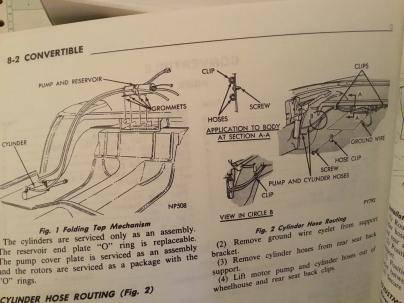

Looking for a little help locating the proper location for the Hyd pump
on my 70 chall conv ( finally going back together after many years apart)
Got more silver in my hair now and the memory seems to have faded with my color
any help appreciated
Thanks

It's located dead center in between the wheelhouses, you should find the 4 holes that line up with mounting points on the motor itself.

there has been some metal work done ... so no Holes
you say dead center ? vertical or horizontal? above the tranny tunnel?
Thanks again for your input

Right like this. Nothing like a factory service manual!
