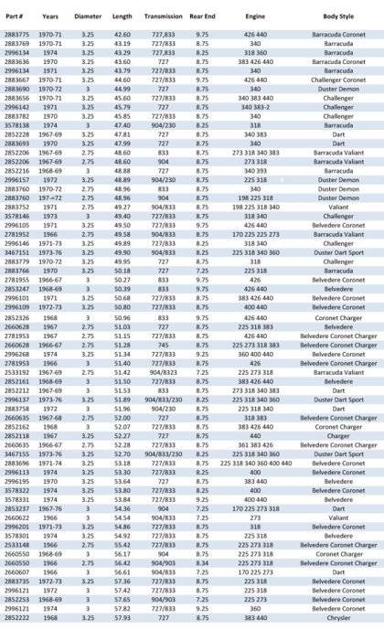

I think the driveshaft I have is a bit on the short side. "clunks" when put into reverse the first time- then smoothly thereafter.
Not coming from the 8.75 rear end and U-joints are relatively new and tight.
Can anyone provide the correct length of the shaft?
I have a 440 with 727 auto.
Thanks
You didn't say what you had, so assuming a Challenger. Here the chart for all stock A-B & E-body shafts
