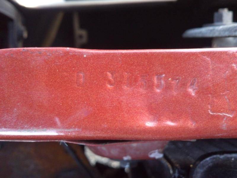

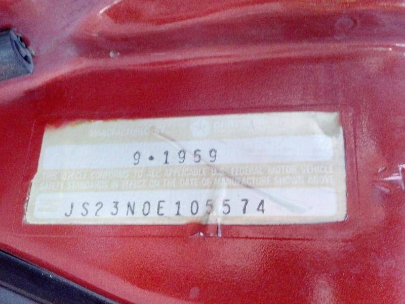

I am looking to buy a 70 Challenger RT and the owner says it’s a number matching car. I inspected the car and the Motor, trans, drivers door sticker, window vin and fender tag all match ( N0E 105574). The cowl and radiator stamp are stamped as E0 315575. This seem as someone found the car with a matching end sequence number and put all of the removable vin number parts on it. Have you ever heard of 2 number not matching the on the body stampings? Is there way I can verify that the body is an RT other than the vin stamps by finds additions body pieces?

They should all match but they're close enough that it could be a factory error. Is there a build sheet with it? Is it a restored car? Unfortunately without any way to really document how and when this happened it doesn't look good for the car.

I will bet this car is correct , firstly not a lot of cars were built out of the E plant in LA no way they got near to 300,000 vin #s in one year secondly a friend has a Cuda built in LA with a similar misstamp on the body
I'm inclined to agree. Swapping everything over from one car to another and then ignoring the "off" numbers just doesn't make any sense to me. It's a lot of work to do what was described, if it was fake, why not go ahead and swap everything?
