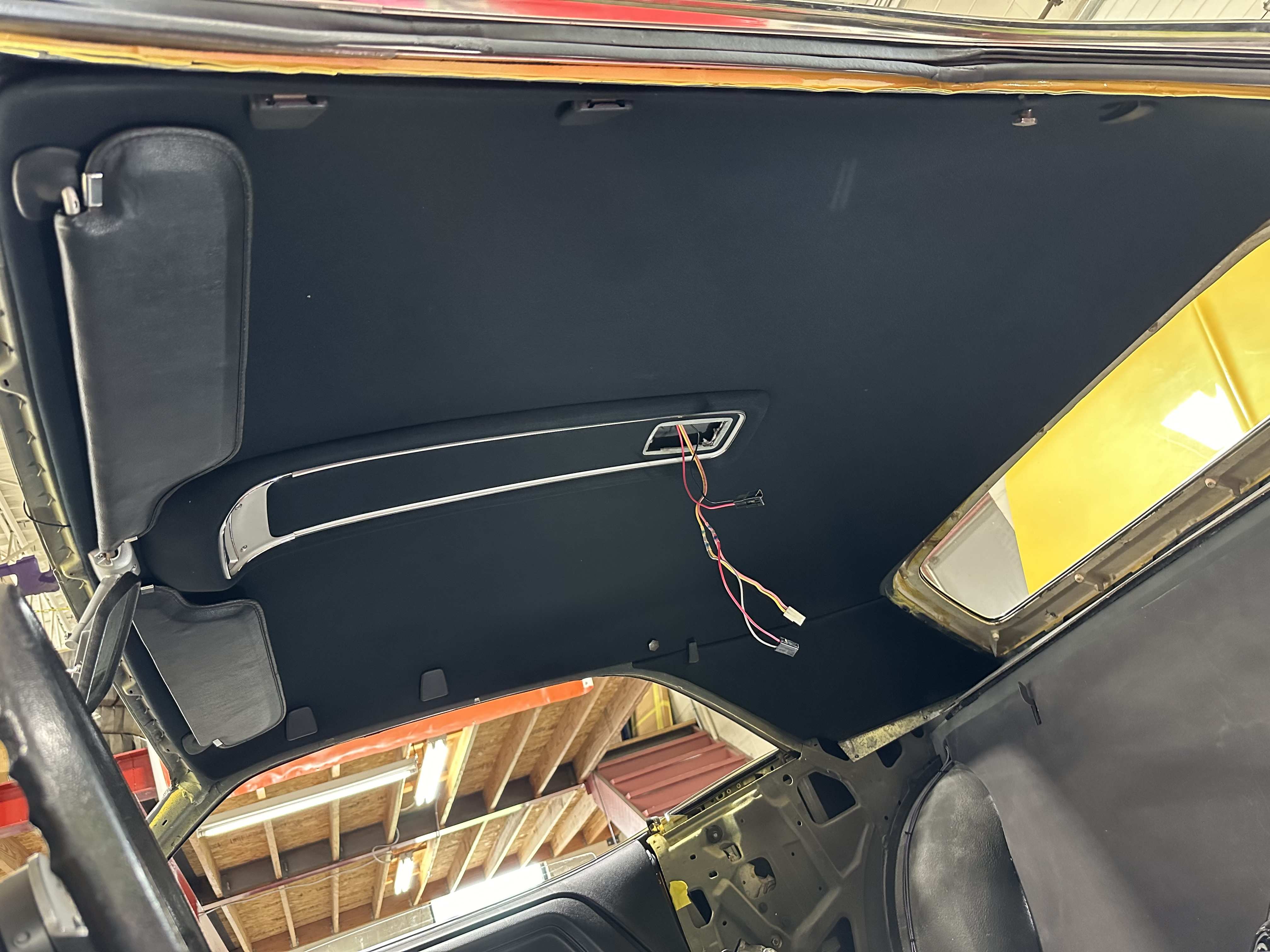

Looking to understand what headliner and bows used in a 70 SE Challenger without a console.
Thanks

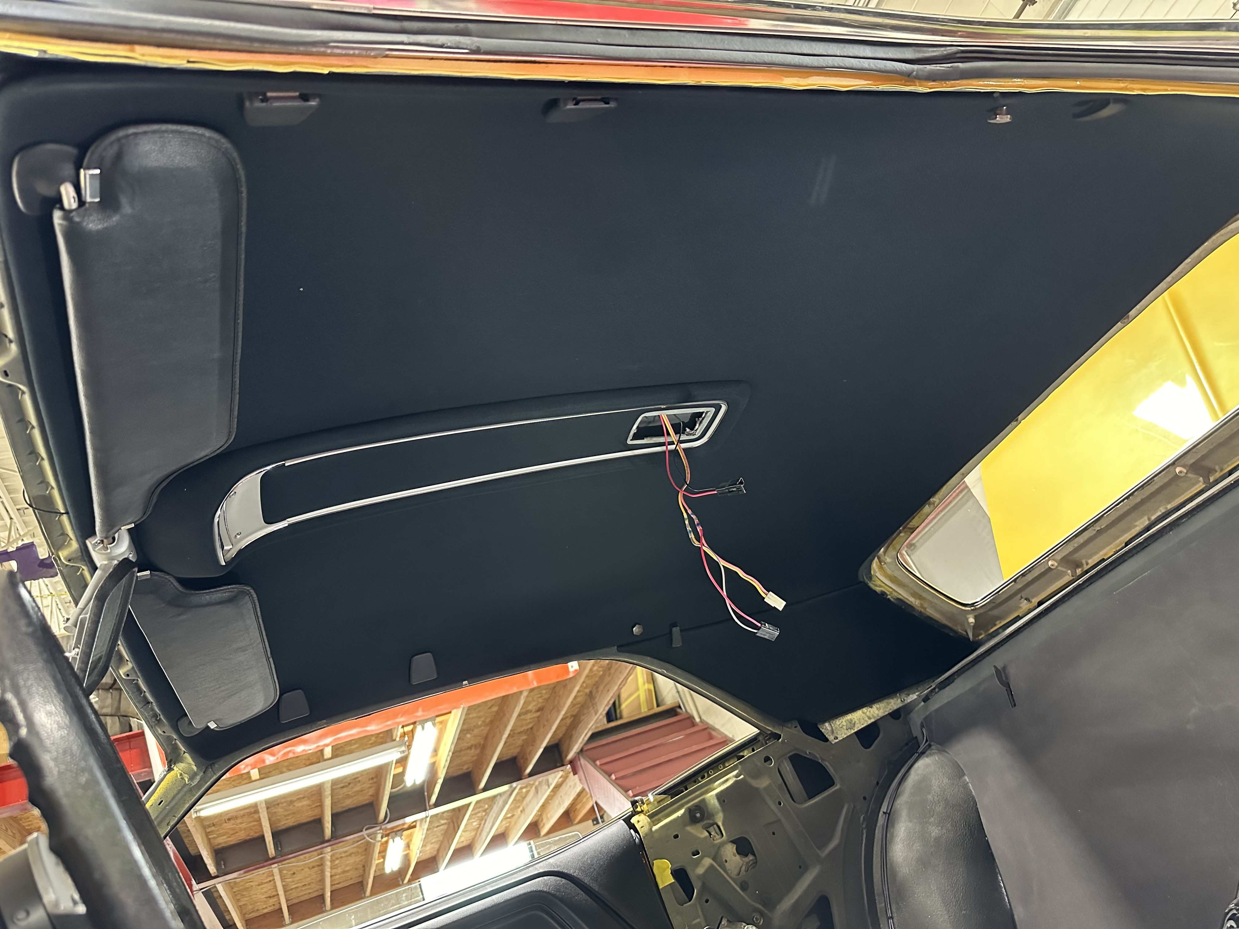

I just had one put in my 70 S.E. It’s a pain to install but I dig those lights.

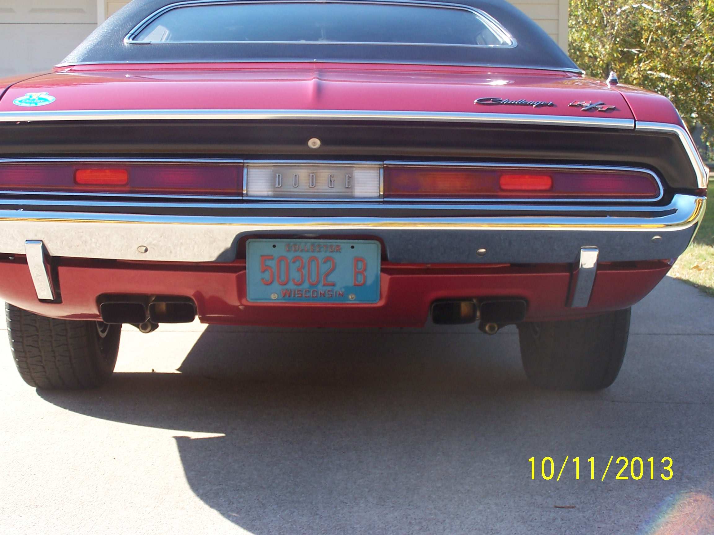

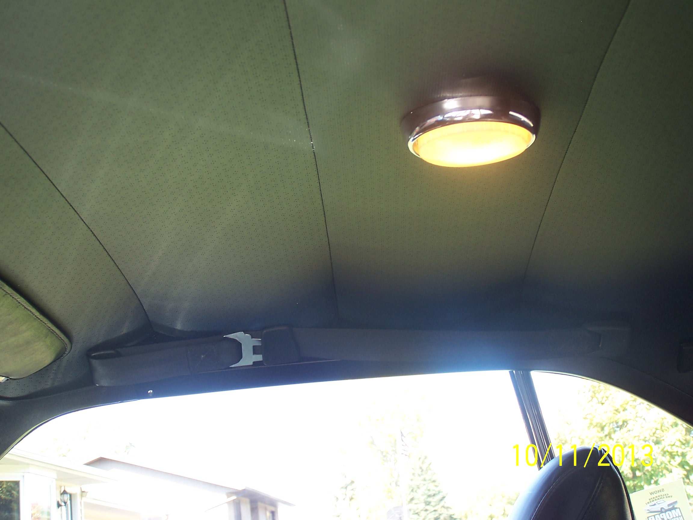

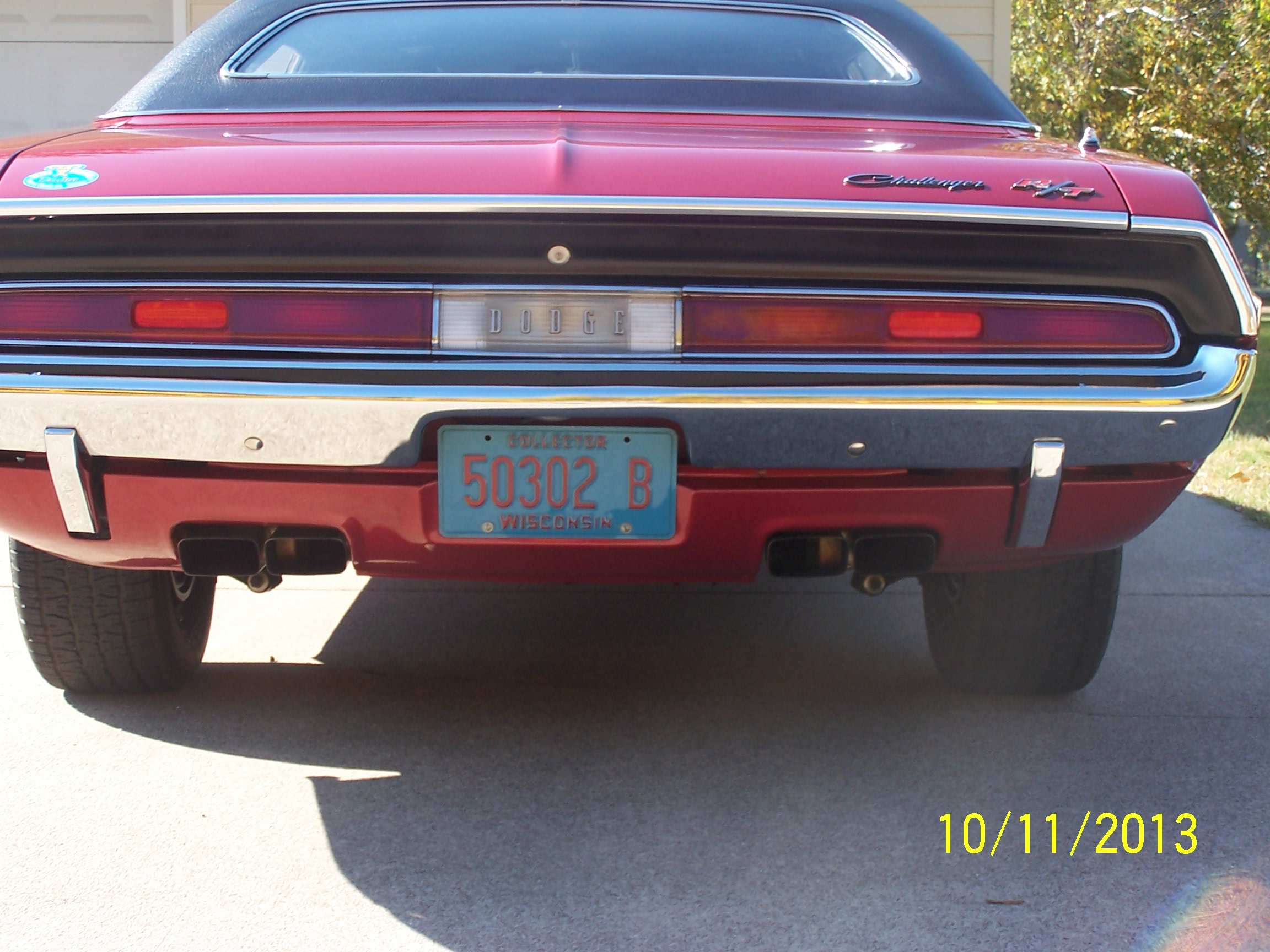

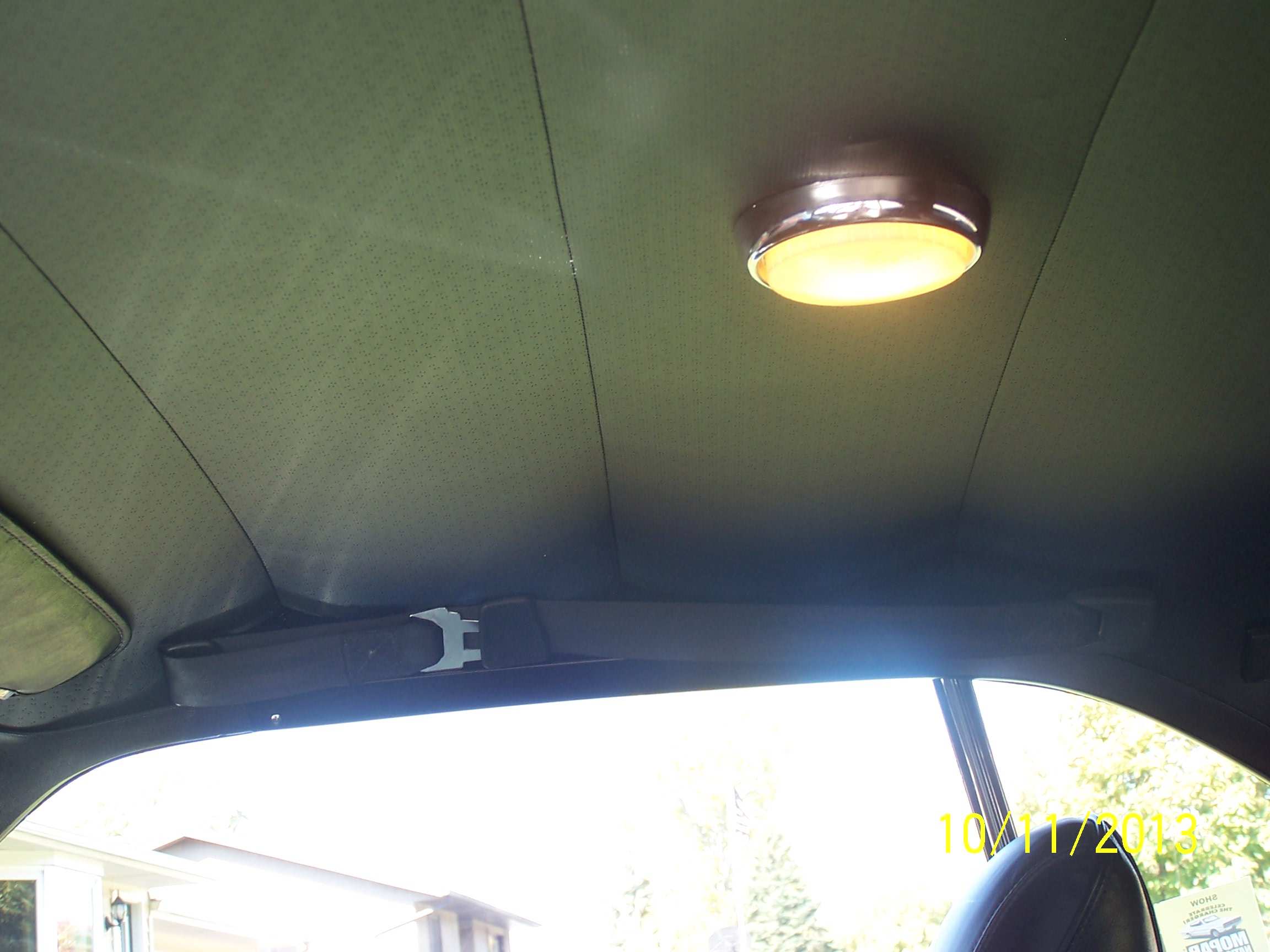

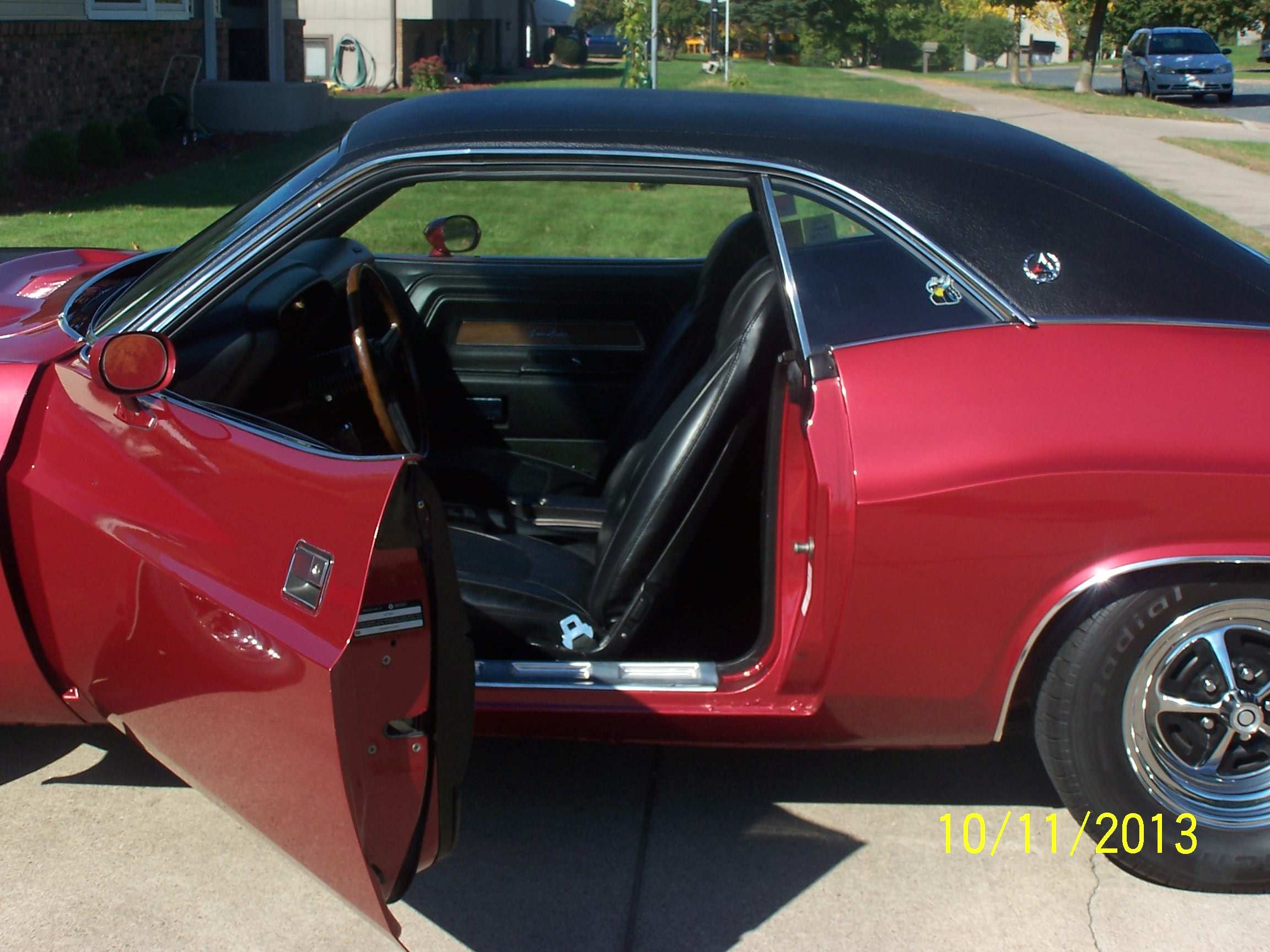

Not so......When I restored my 70 R/T SE Challenger back in 1998, no one had the one piece SE headliner. I had a parts car that had the bowed headliner. I robbed the bows and sail panels from that car and kept my SE window. I sold the car back in 2013 and don't have pictures of how the rear window looked from the inside any longer. I still have the SE sail panel metal retainers so know I didn't use them or the console. Here is the only pic I have of the headliner.

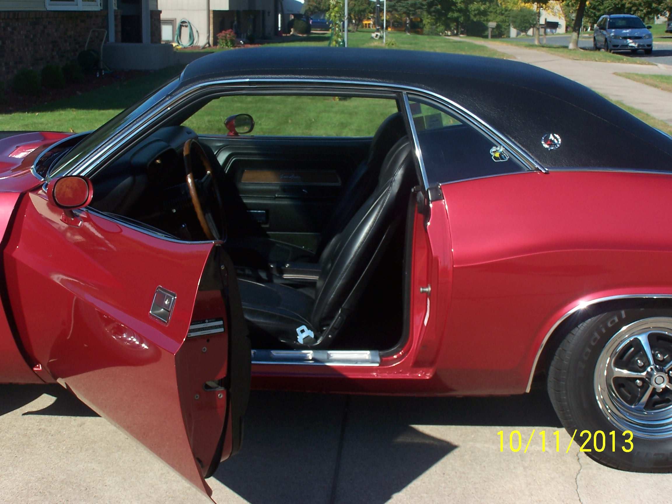

Beautiful Car! My friend has a 70 RT/SE Challenger, but he hates the Vinyl top. Can You still install the small window and seal it without the Vinyl, or should he just put the regular size window in and save the rear window Plug?
Without the vinyl top, why bother with installing the SE window. Although they look neat, they are hard to see out of and it would take a bucket of bondo to fill in the area that is sure to crack and peel. IMO, your friend would be better off swapping his car for one more to his liking. I liked everything about my SE except the small fuel tank and 10 mpg so off to Australia it went.
I appreciate Your Advice. My friend has thought of installing the regular size rear window, but He does not want to destroy the value of the car. The Small back window is one of the main items that make the car an RT/SE. The main issue to Him is not having the vinyl because it is so hot here in Las Vegas, and the Glue will get too hot. Maybe there is someone who can fabricate a metal plug for the small rear window that can be installed without the vinyl.
