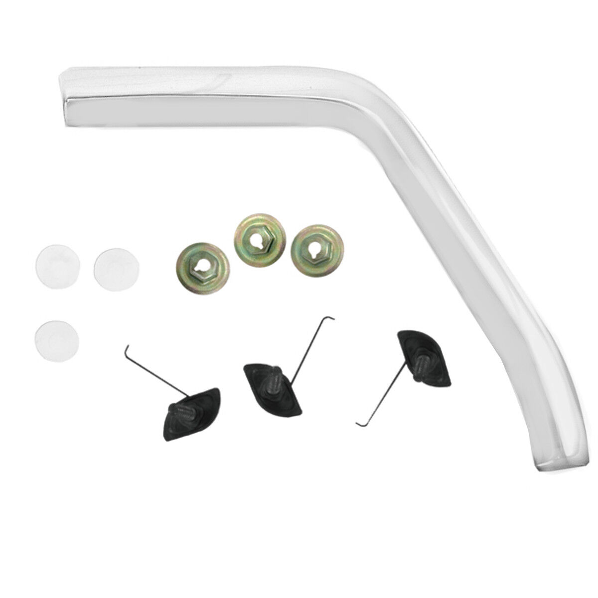

Has anyone tried these aftermarket tail panel extensions for an SE Tail panel? I'm assuming you would have to cut the original section off trying to leave enough metal to underlap so the new piece will hold the rest of the tail panel in place.

I installed these trim pieces on my 73 Chally. Not sure why you say anything about cutting? If you remove the three nuts from inside the trunk, the entire trim piece and attachment studs pop off. Then install the studs on the new trim piece, aligning them to the holes, install the felt washers and nuts. Sorry if I misunderstood your question.
I am not certain if the felt washers went inside next to the nut or between the stud and body? I tried it both ways on a test run and can't remember which way "looked" correct. Someone else can chime in on the correct location.

I guess I should of said 70 SE tail panel trim. It's all one piece. Is the non SE tail panel trim more than one piece?

If your rear panel is that bad you can use them. I have seen it done. You can't cut the whole piece off of the SE panel. You basically cut the quarter moulding that is made into the panel in half. Then you flatten it and solder the new moulding in its place. Before all of that, there are shops that restore the panel. That is the best way to go. Post some pics of yours so we can see if it can be saved without replacing the quarter mouldings.

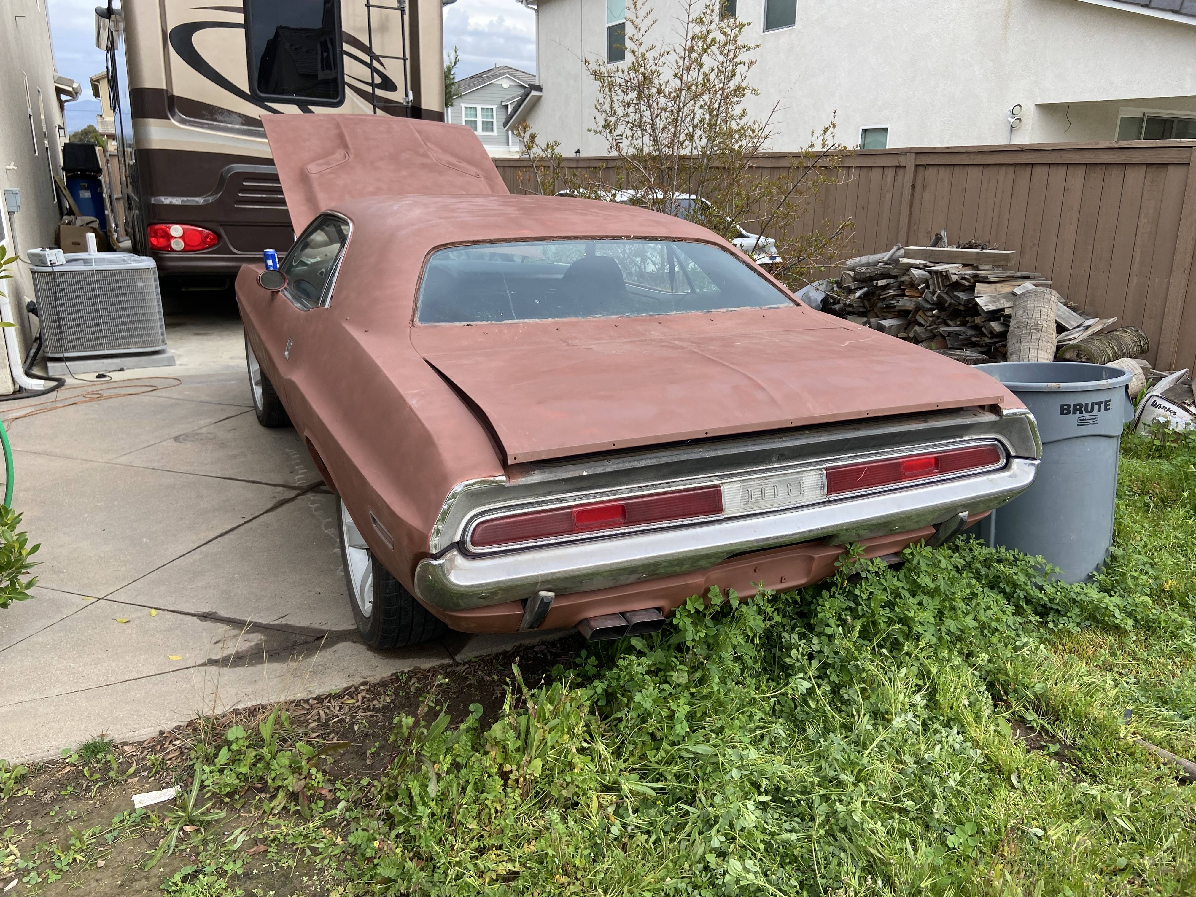

Thank you. I understand what you are saying. They are beat up. You have to wonder how the heck they got so damaged. I'll have to get some more pics up close.

My ends are also crushed, as yours is in the picture.
I also considered just overlapping the new corner pieces.
I did not think (and have confirmed with a few trim restorers) that once that aluminum is crushed it is beyond the point of bringing back.
I found a good one and had it restored, so never went down that path. (I still have the original if anyone wants to work with it)
I think it could be done pretty effectively and unnoticeable until someone gets very close

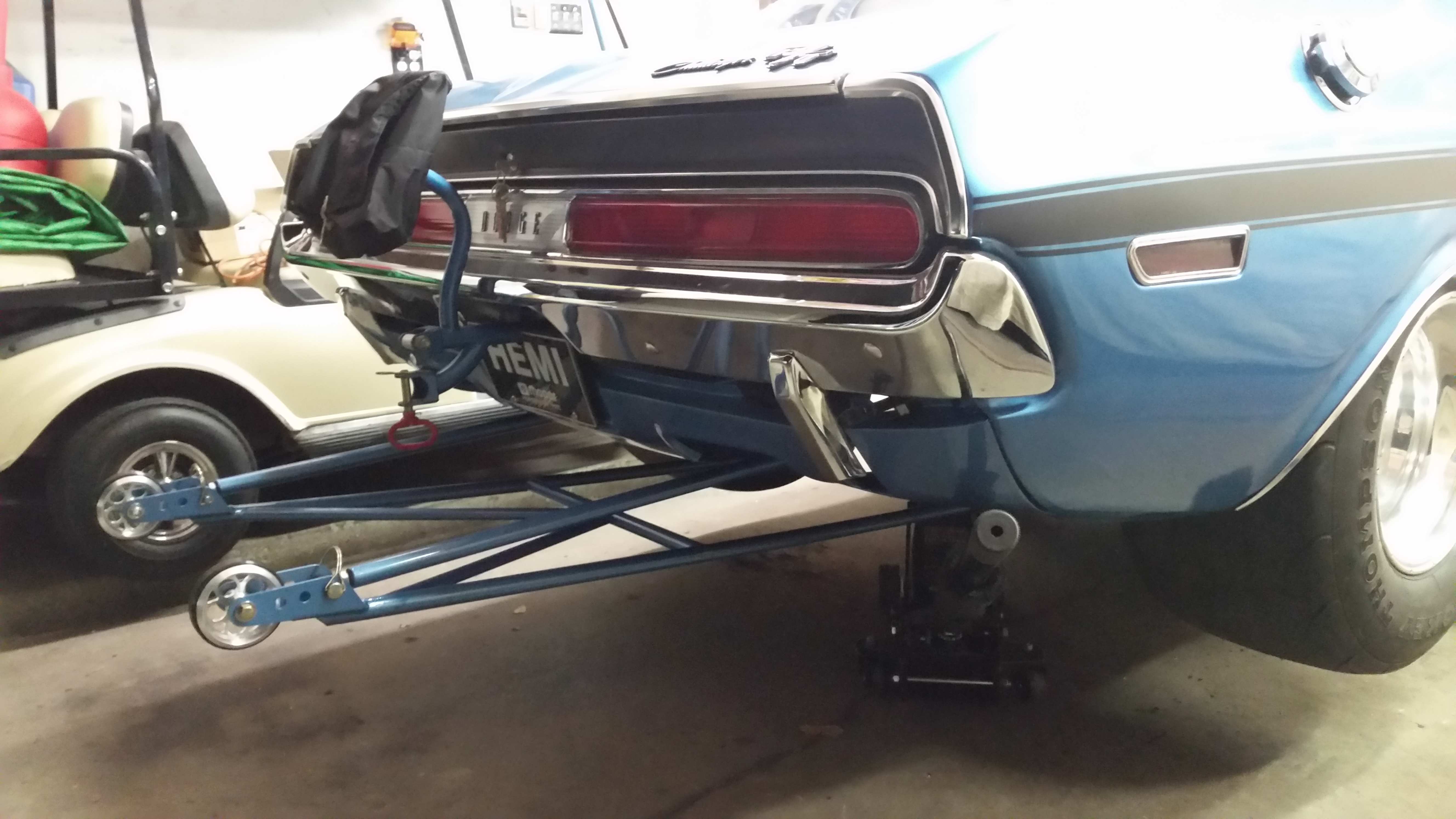

My Challenger came with a satin black painted tail panel like an S.E. panel. However, it does not have the quarter panel extension mouldings integrated into the panel. It has the quarter moulding pieces bolted on separately. It is not just the sheet metal painted satin black.
This is about the best picture I have of it showing that it is screwed on in the trunk edge.

Any chance someone cut the moulding off the panel and then just bolted the new moulding over top?

No signs of being cut. Or someone metal finished it perfectly before being painted and installed
