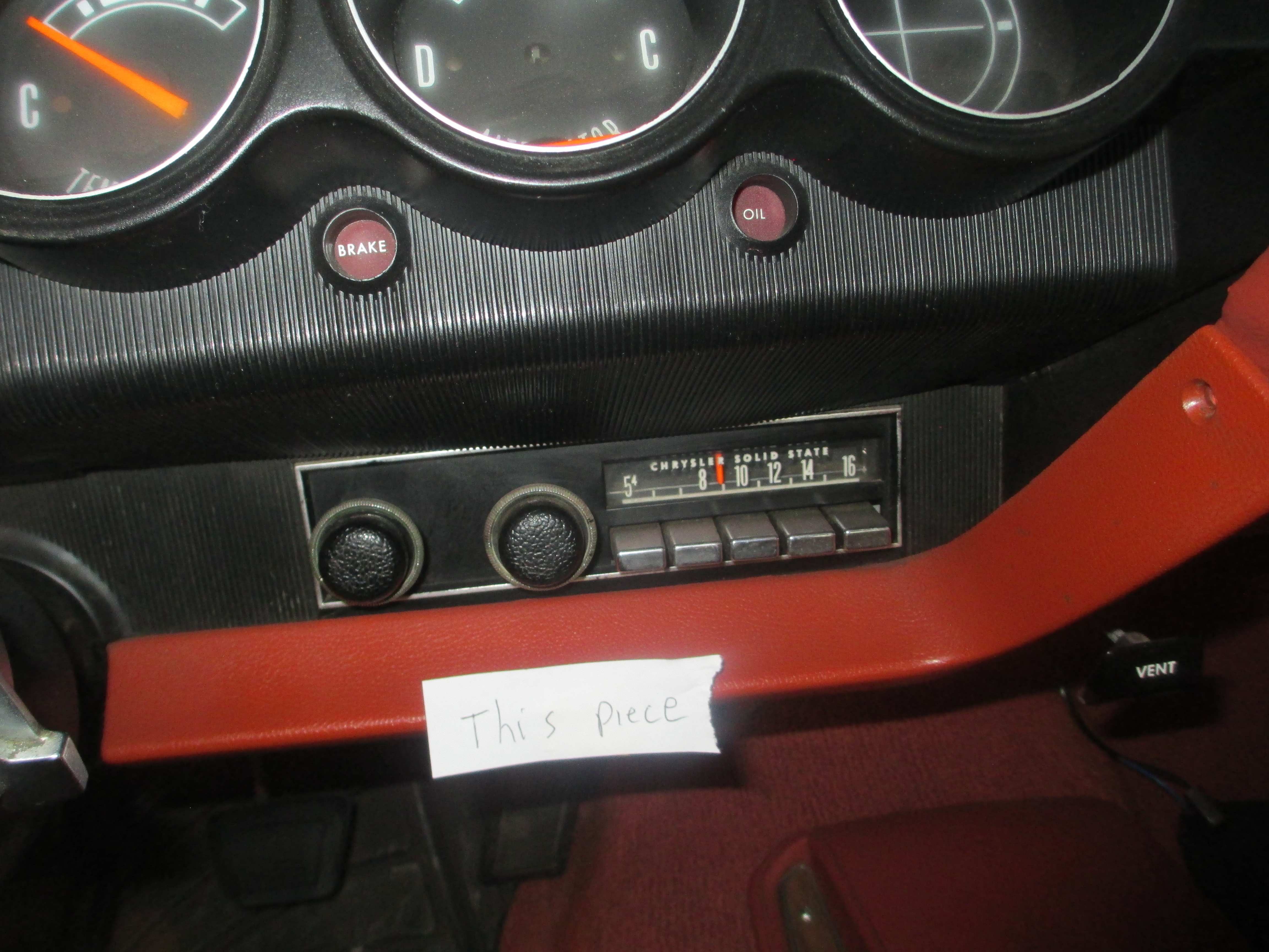

How do I get this piece of trim just under the radio off of my 1970 challenger does the dash cluster have to come out first. I saw the screw on the right and one on the inside on the left but its still on there ?

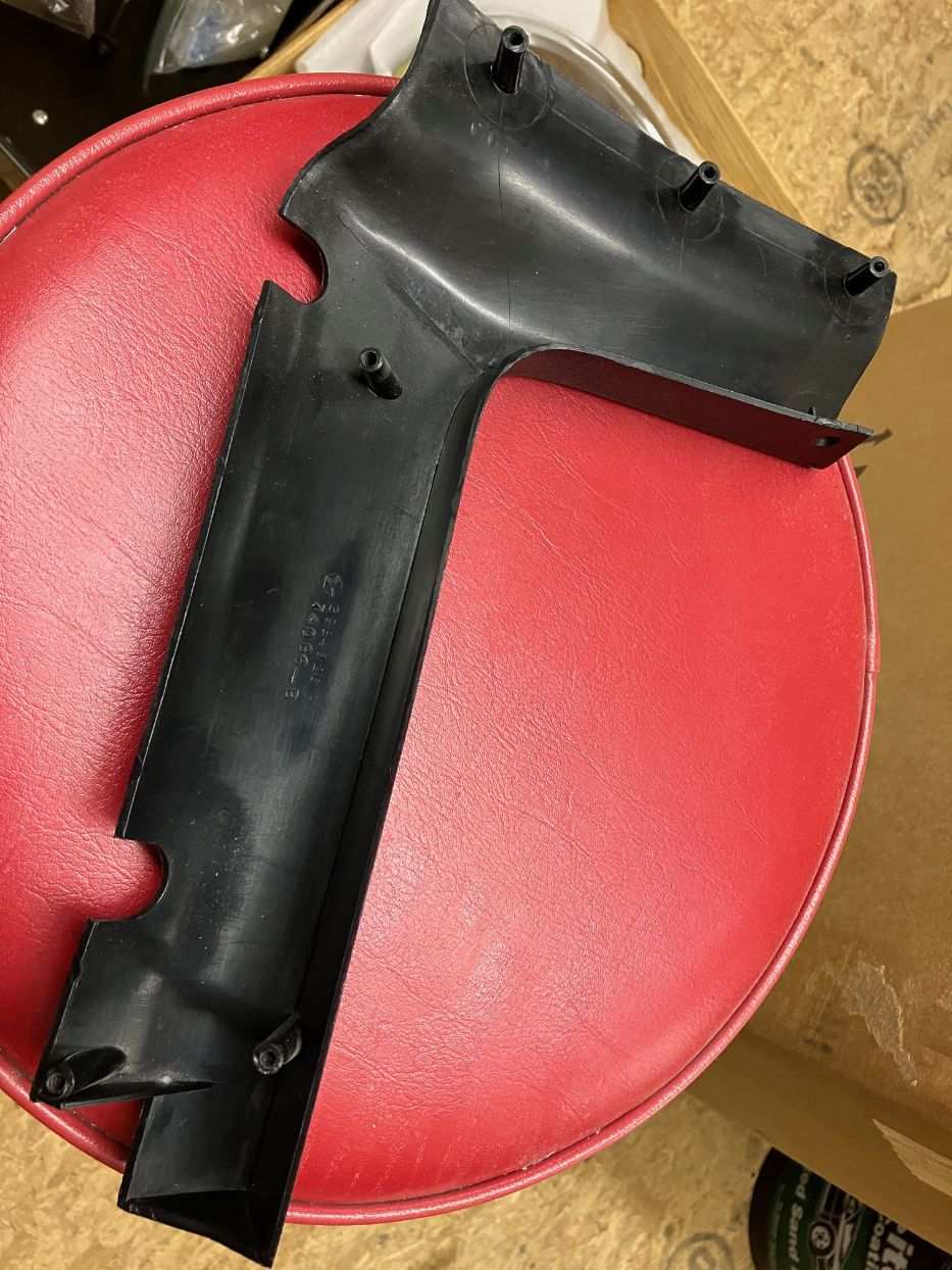

Thankd for the picture its nt gonna be easy all from the back-- when you change the radio bezel does tha tneed to be removed maybe I dont have to remove it anyone know?

Kenny,
It will be a challenge and may take a bit of time, but with the correct length screw driver, you can do it. It is the three vertical screws that will provide you with the challenge. You will be working blind and mainly feeling around with your fingers......You mave to remove others items behind the bezel for clearance. I also notice the needle for your ampmeter gauge has fallen off.....this might be a good time to repair that as well.
