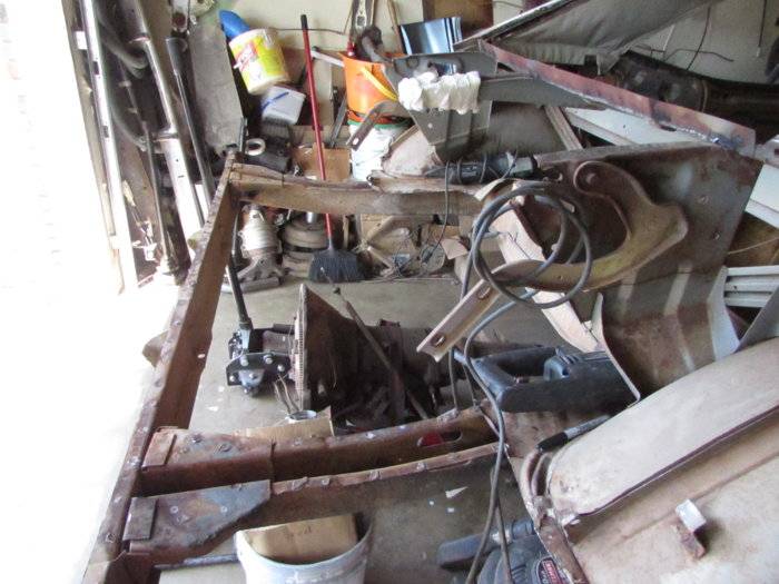

I’m looking for a trunk floor with trunk rails that go around axles, everything is welded
in 1 piece. I can find it at year one but only for a challenger, does anyone know if it is
made for the cuda, I ve ran into dead ends everywhere.
Thanks Bob

I presume what you are referring to as trunk rails are the frame rails, correct?
Bob’s Cuda
Oct 28, 2018
18
Yes, year one has trunk floor frame rails and behind
rear seat pan for a challenger, but I think it is the
same as a cuda.

I think the difference in challenger and cuda is in the rear floorboard area. Challenger is a little longer. I believe the rest is the same between the two.

Thanks for the info,I think you’re right.
Year one says it’s different, but with all my
research I think it will work.
Thanks for the advise.

Cuda and Challenger trunks are different. Cuda gas fillers go out the back, but challenger fillers go out the side through a hole in the trunk floor.

I think that’s the only difference, we are going
to move the holes. The measurements are the
same. I’m going to see if they will make one
with no gas hole. Thanx for your reply.

I don't believe the fuel tube hole is punched out on these, so you might be good either way.
Also, others are right, the challenger is two inches longer in the rear foot well, other that that, they are the same.
Can't wait to see how it goes.
