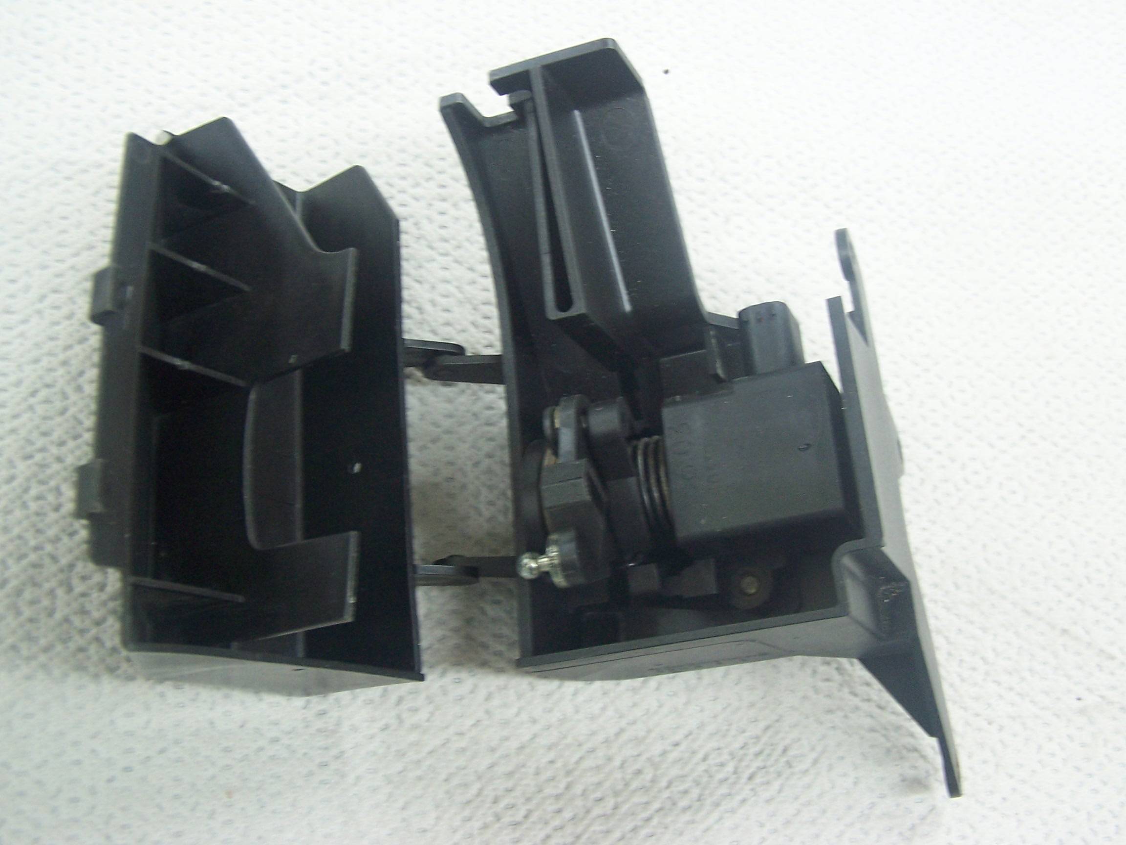

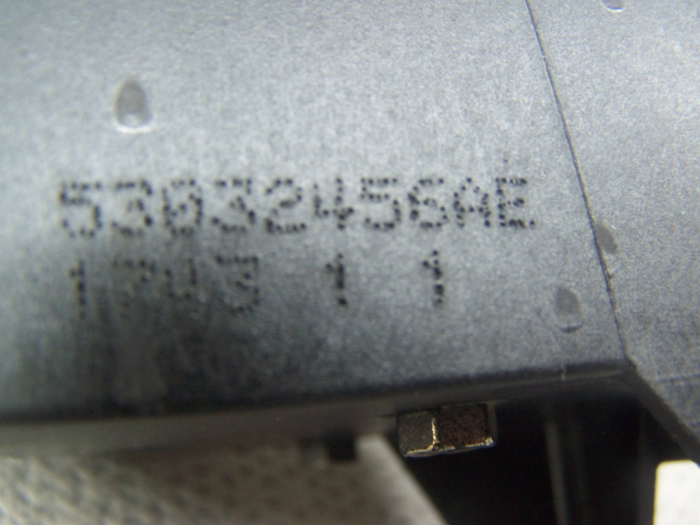

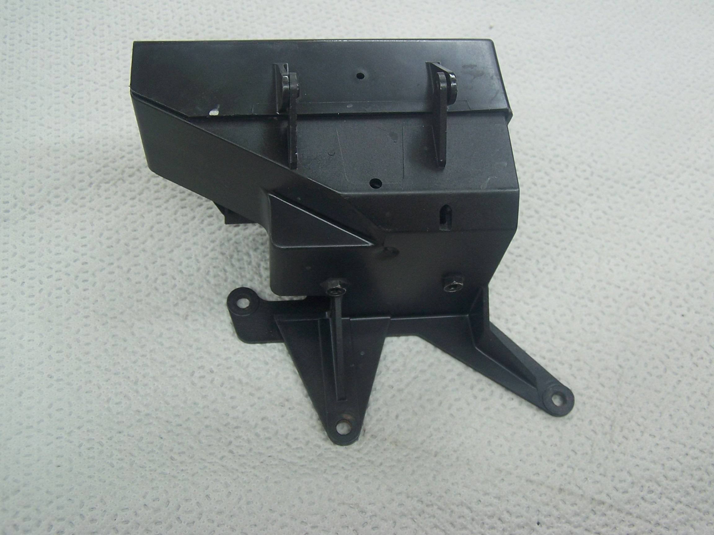

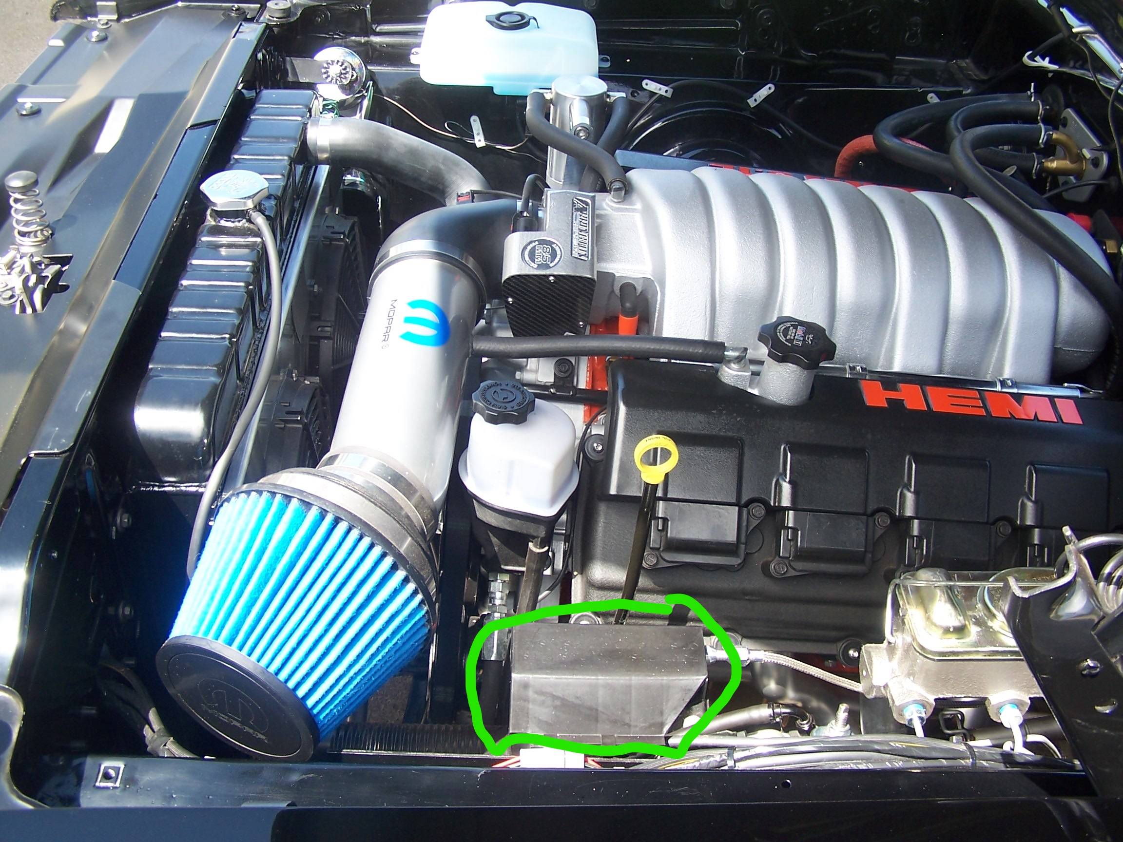

Yup. If you want to use your stock pedal, you will need the 03-04 Hemi Ram Throttle position Bell Crank. It is PN: 53032456AE. They are big bucks new though. Over $400.00. You are better off trying to find one in a salvage yard. If you go this route you will need to have the harness built to locate that drive by wire harness and plug routed to the engine compartment instead of under the dash though. Here are a couple pics of the Bell crank and where I mounted mine.
If you want to go that route and can't find a bell crank, I have an extra I would let go for $100.00
