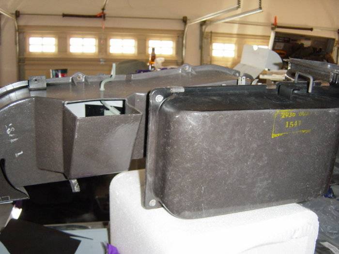

Adam
Dec 25, 2012
1,666
728
Washington
FWIW, my 71, non-ac box.
