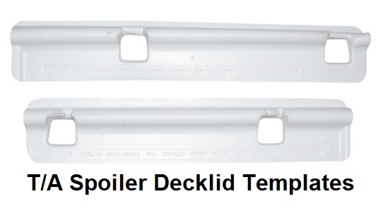

They (Year One, among others) make a template for cutting the inner trunk lining sheet metal to the correct sizes and position for the T/A spoiler.

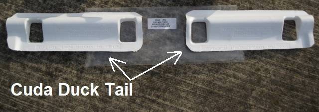

Guessing that Challenger and Cuda would be the same - yes, no? Here's some info for a Challenger.

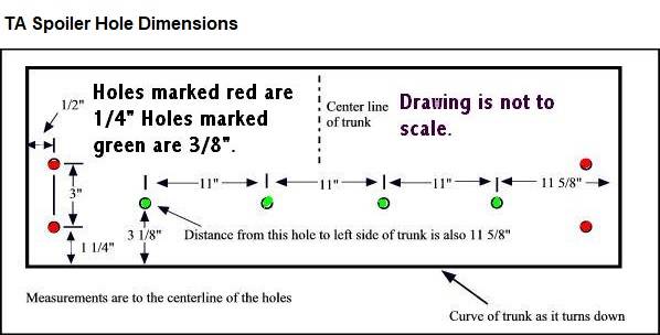

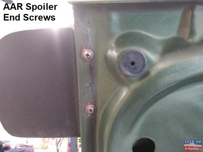

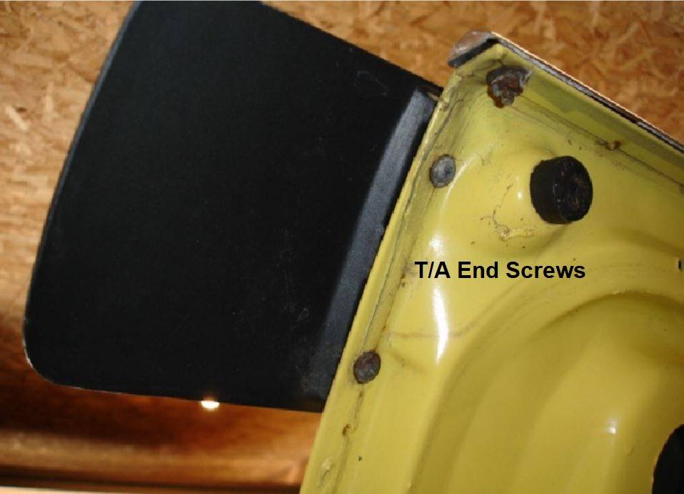

The templates for under decklid cutouts look like this.
