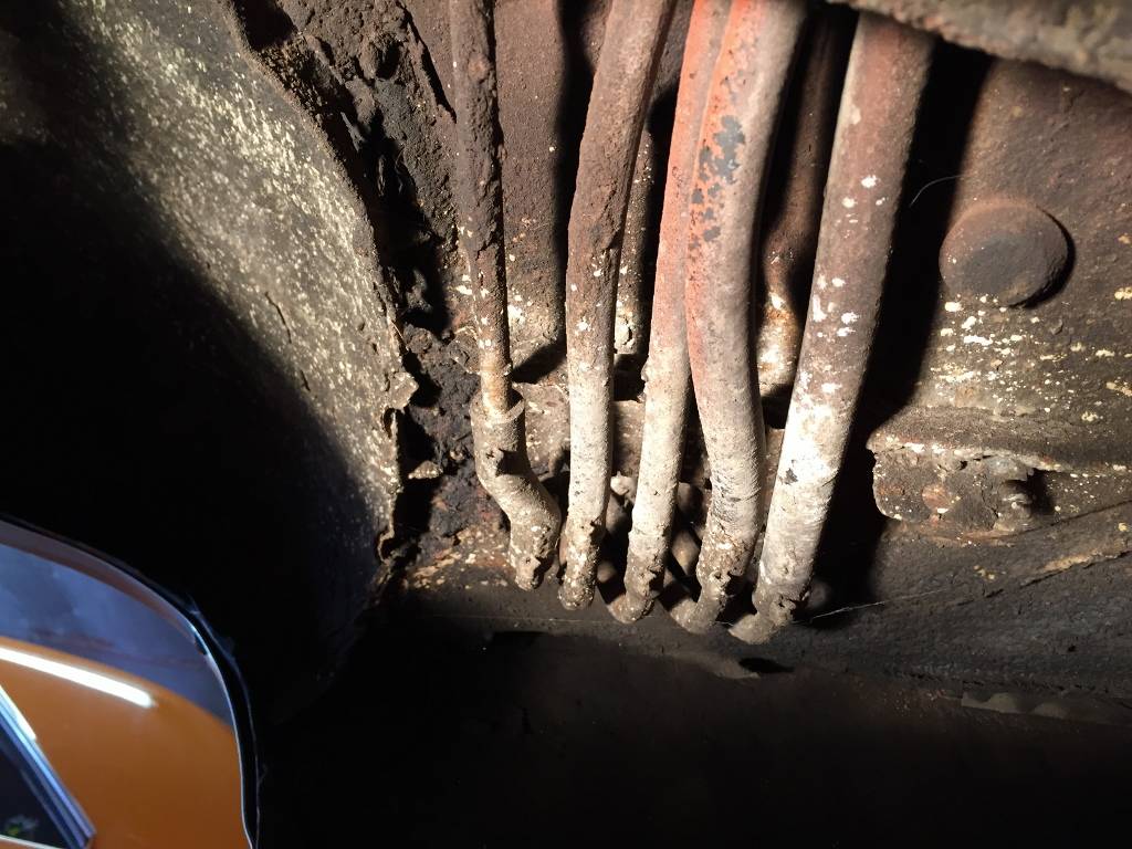

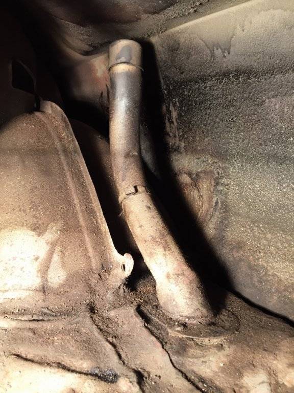

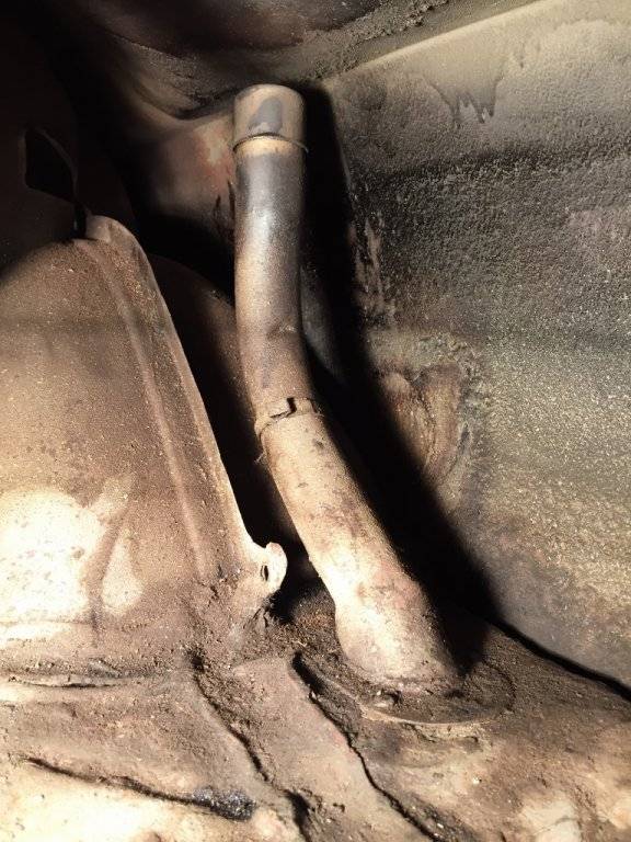

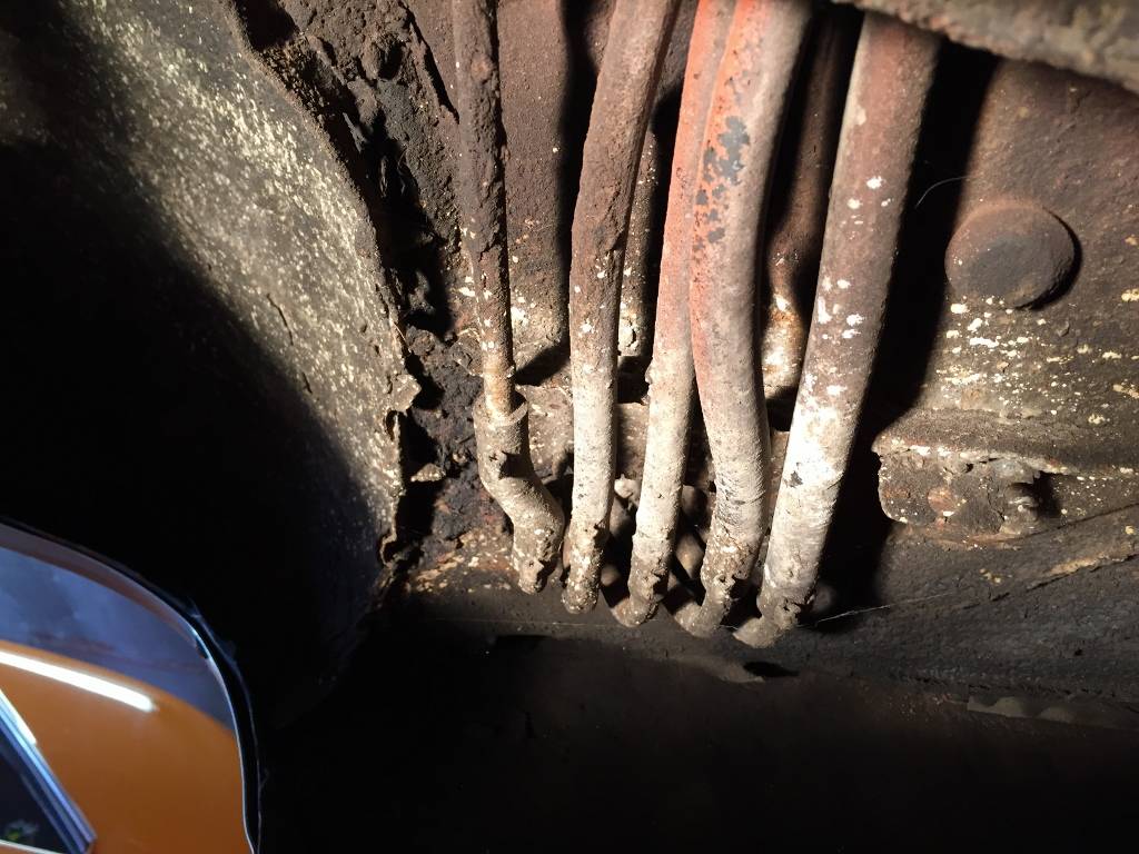

My SPD for my 340 Cuda' is April 30,1971 and I have the 4 lines. Sorry the car hasn't been restored yet.

this is a big help, thank you. do the 4 lines all go to that vent tube in the second picture? my name is Bill, what's yours?
Bill,
I took that picture about a month ago but I'm fairy certain that all four lines go to the vent tube and the fifth line ( Left, hard line) goes to the valve cover breather.

If you have the big tube in your trunk, you should have 4 vent lines.
