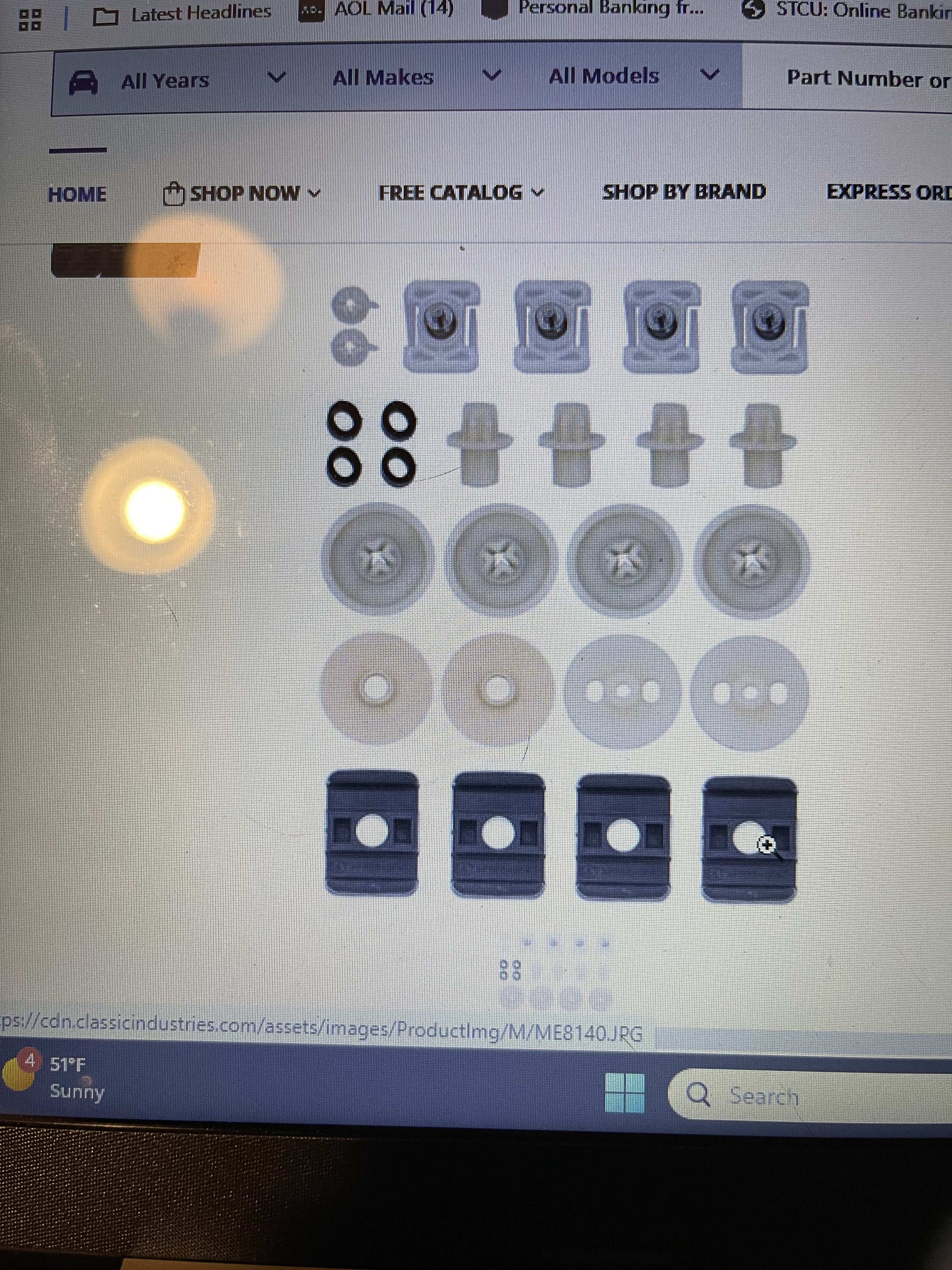

Does anyone have clear photographs or diagrams including all of the new plastic parts for my side windows. I bought the car completely disassembled. I need to know where they all go front and rear

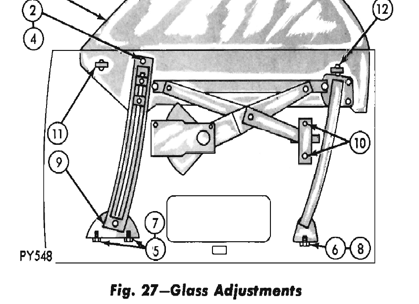

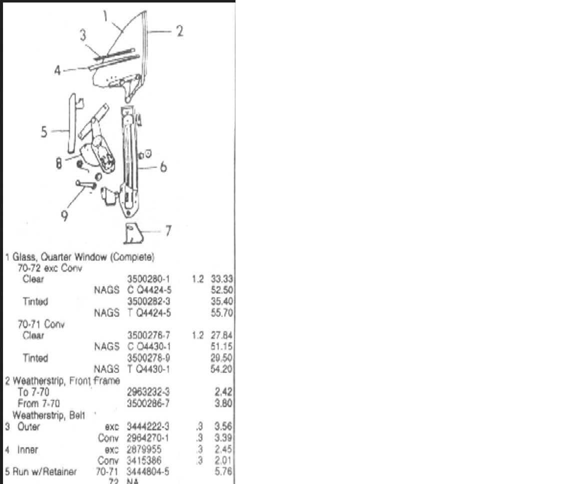

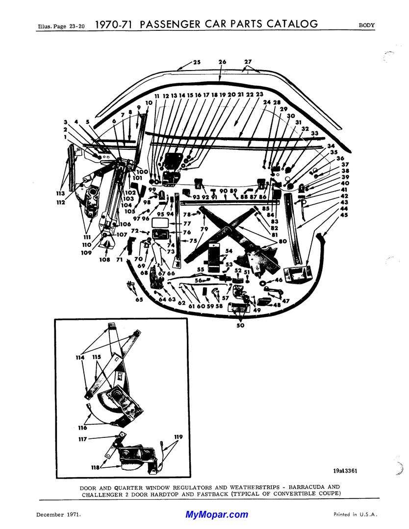

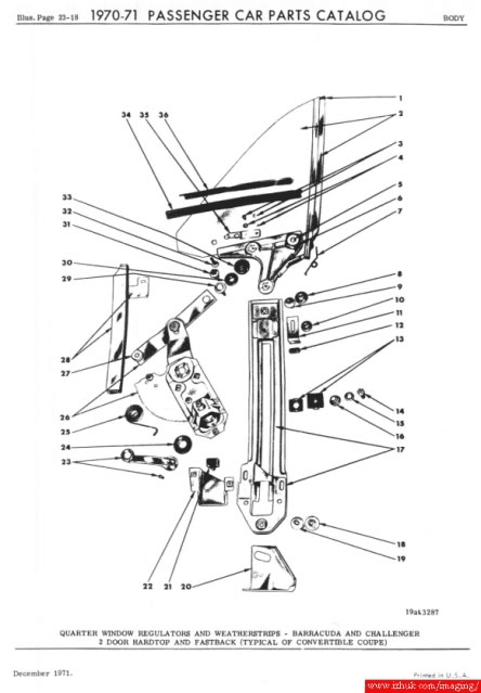

I know this is not what you want. But here is a start.

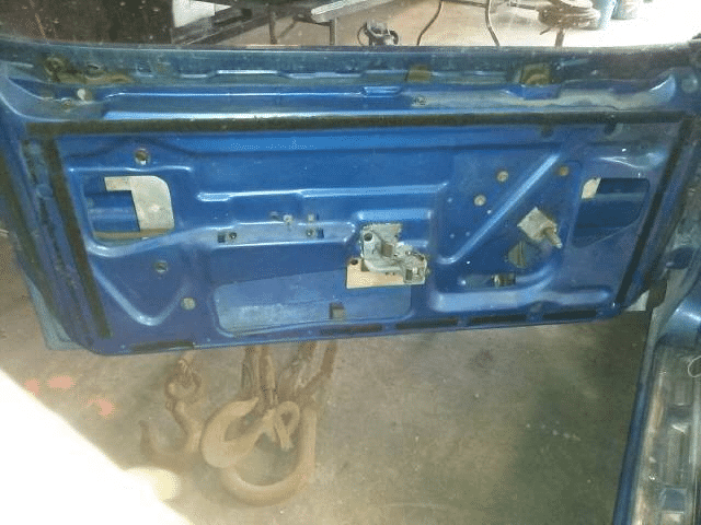

I am in the process of doing the same thing. Took me a couple hours to do one side, ten minutes for the other...
