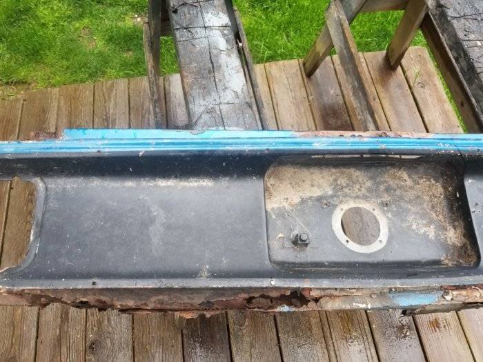

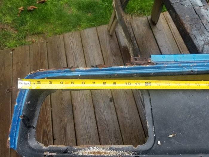

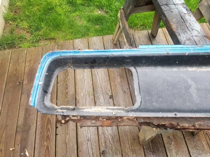

I just took a few pictures. From left to right I measured. The top holes line up with the bottom perf6. The two side holes,one on each side are in the same location just below the half way mark. I took a few pictures

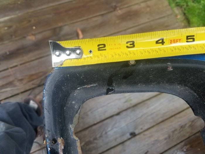

I wrote the numbers down where each hole lands like I said left to right. Take a look at where I started the tape to get an idea. First hole is at
1 1/2"
Then 9"
16"
29"
39 1/2"
49 1/2"
56 1/2"
63"
If you need any more I fo just ask
