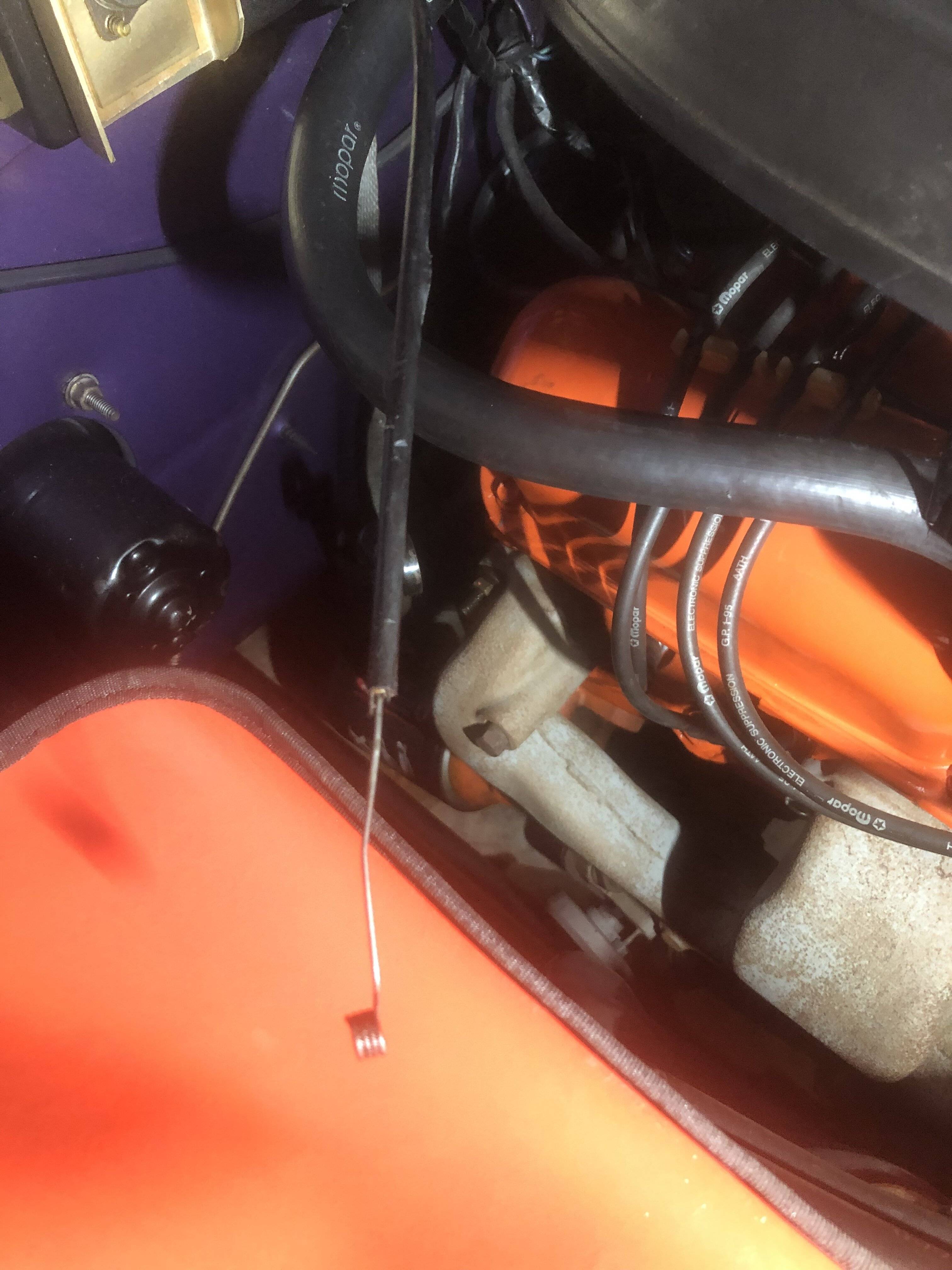

The cable that comes from the shaker hood air way doors does not fit through the shaker housing. Am I to connect the cable to the linkage first on the out side of housing as the bracket that is permanently attached to the cable will not fit through the housing of the shaker. It would be the bottom cable attached in the picture below. If I attache to the bracket first I have to hold the shaker and attach the rest under the hood, something seems incorrect.
This Is my wife's Cuda and I am a B body guy.
Thanks

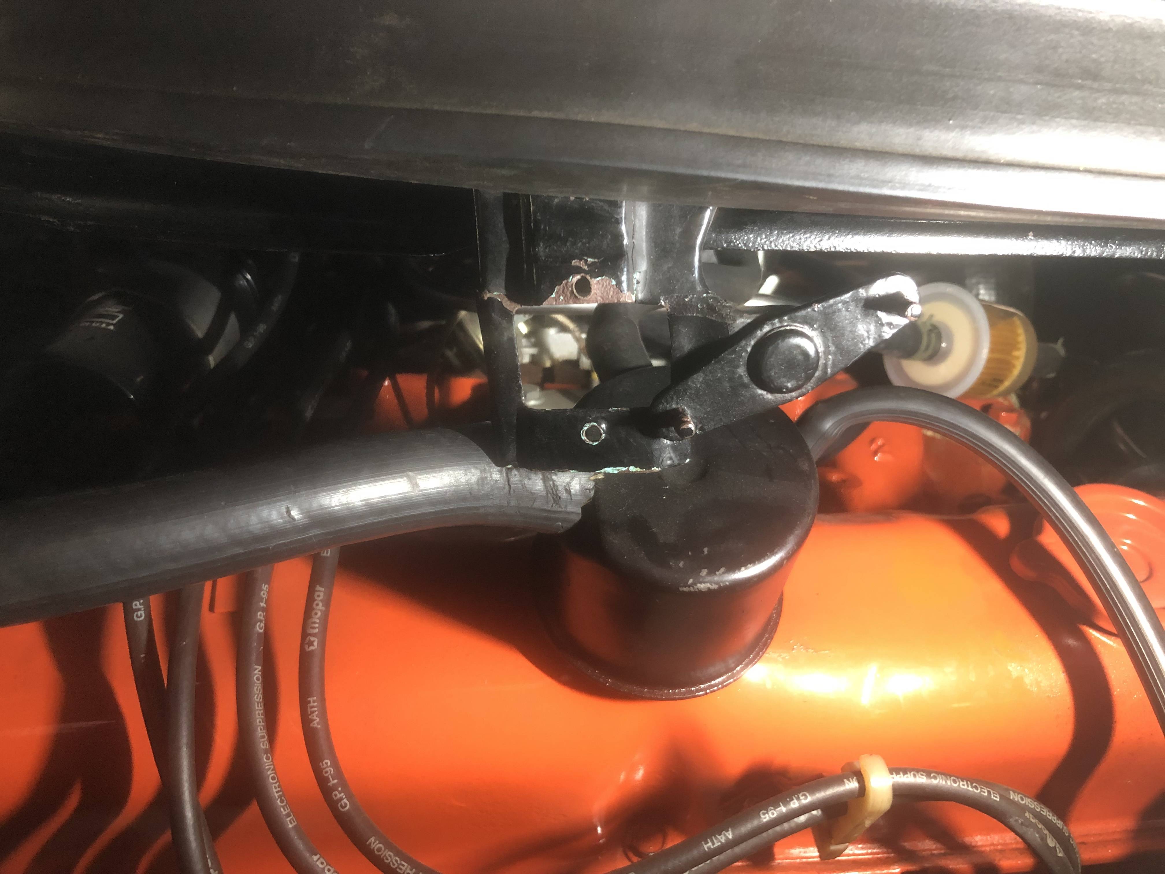

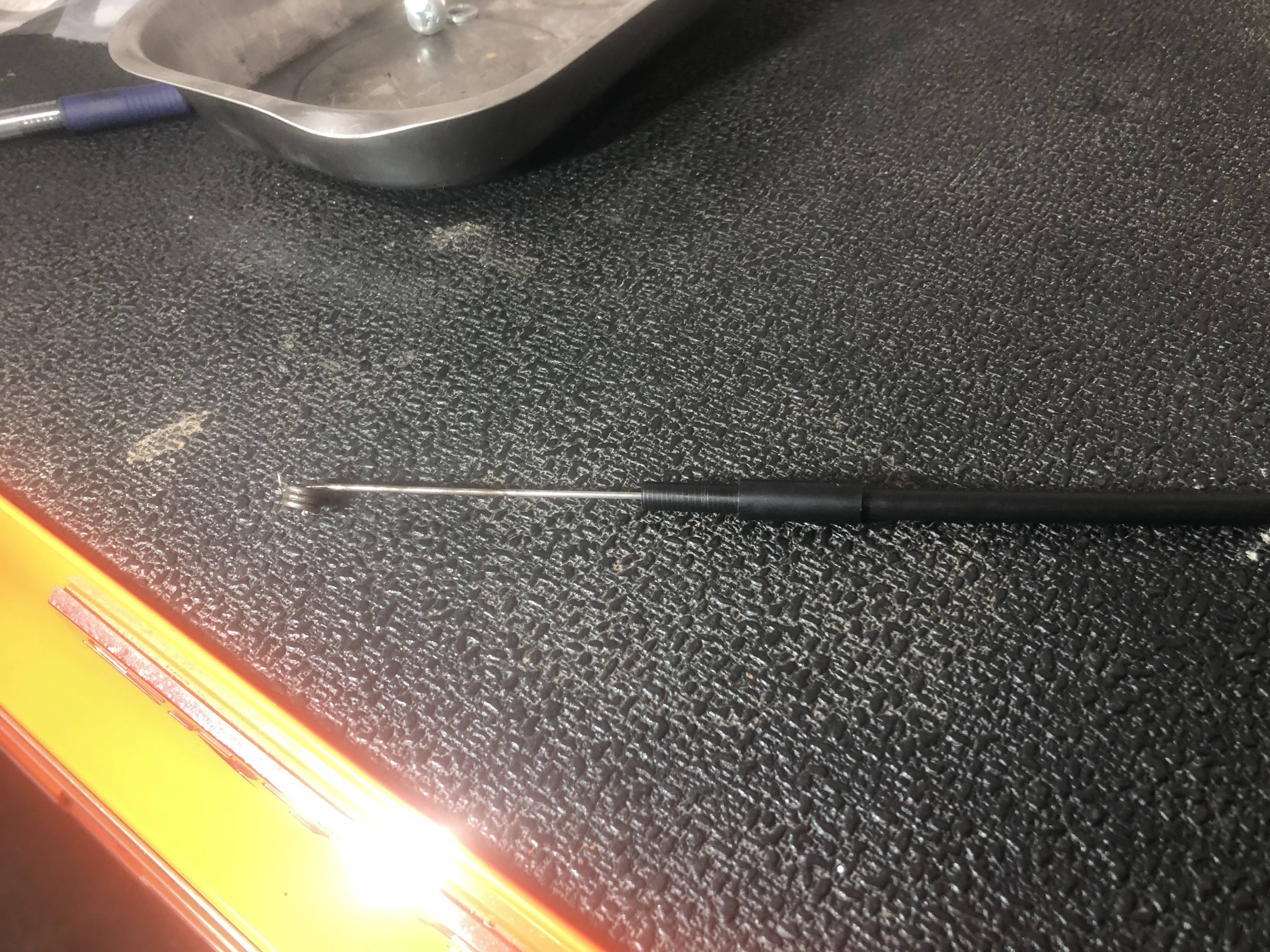

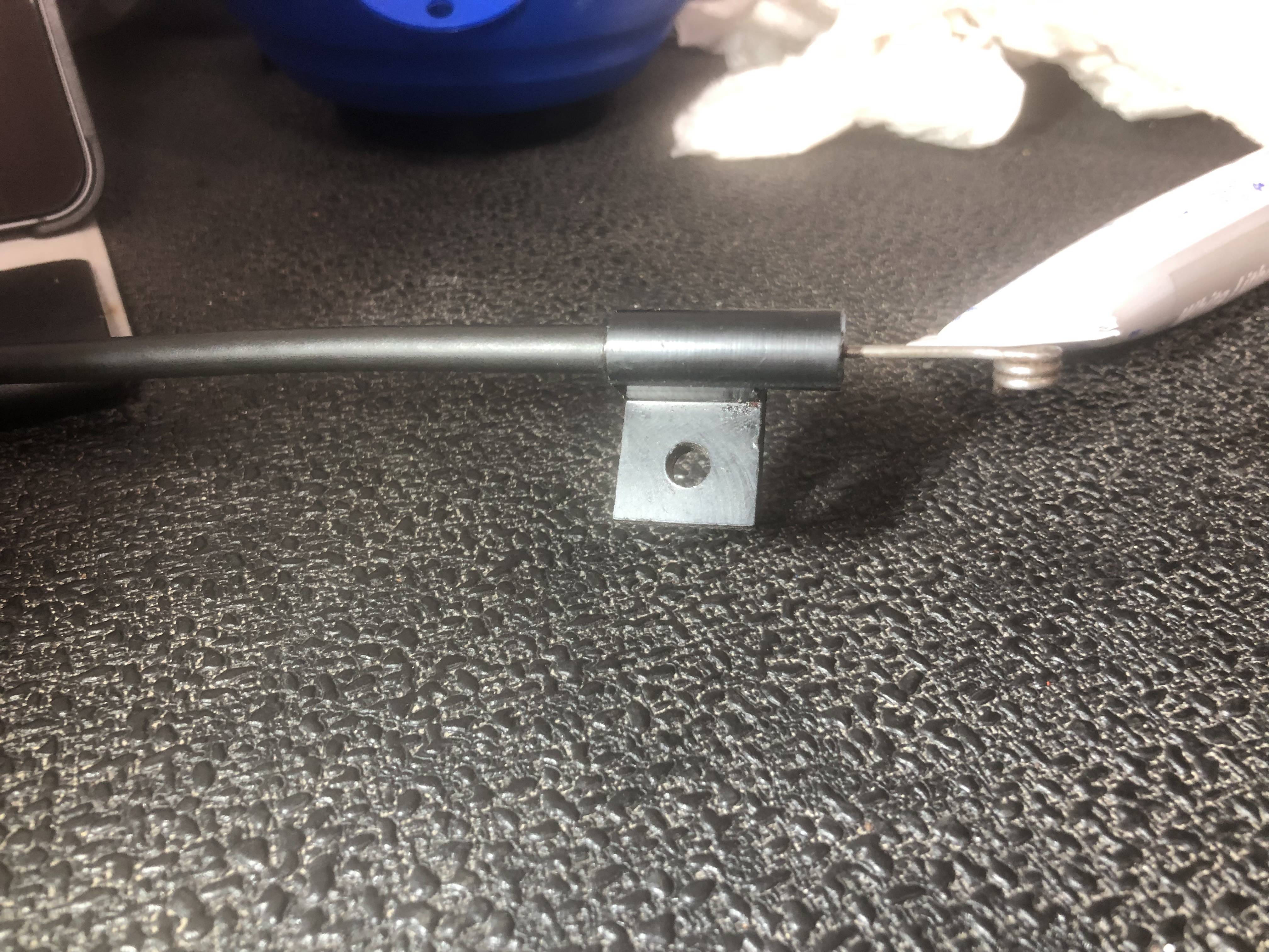

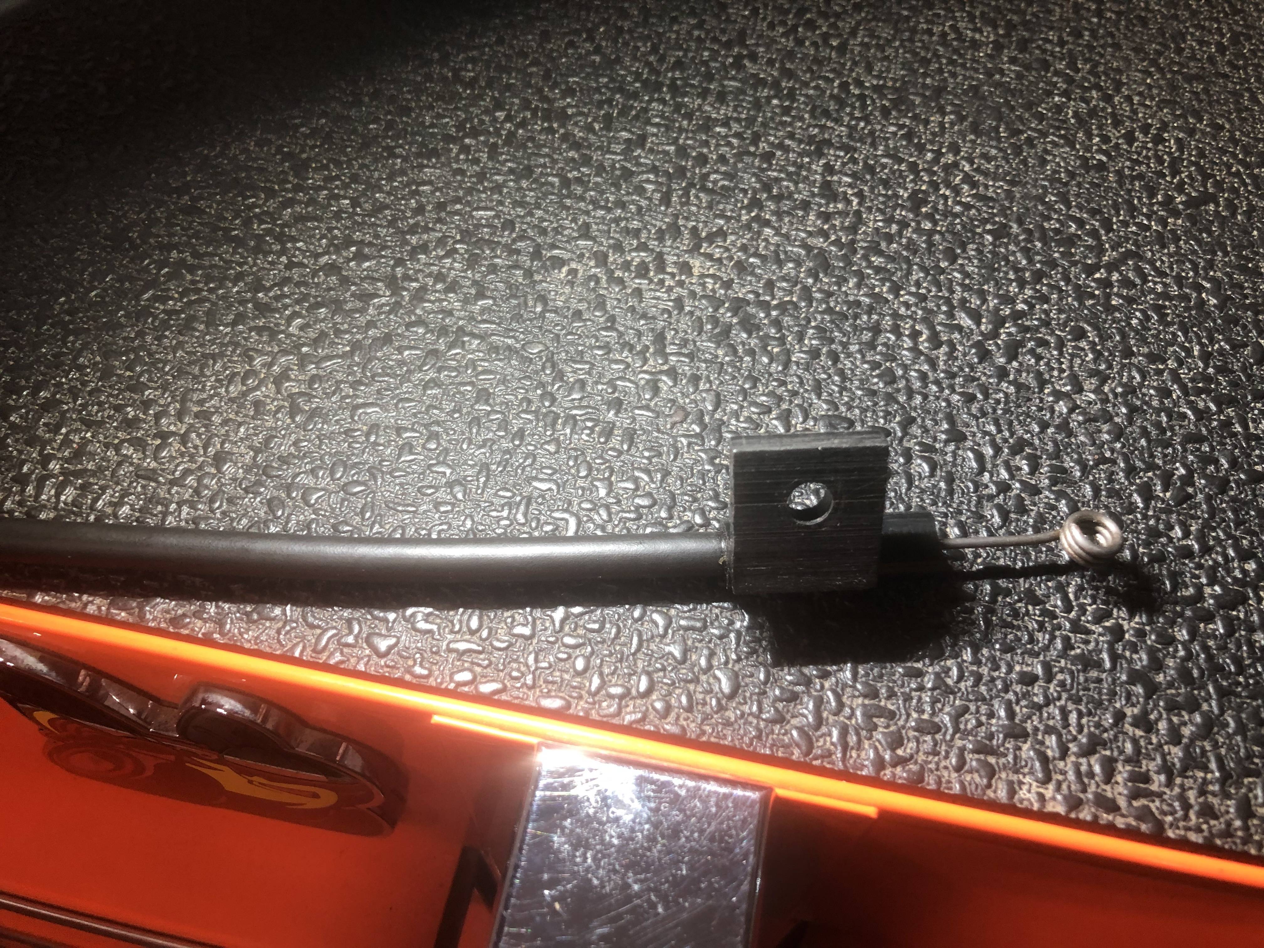

I have these cables below and i am missing the attachments for outside the air housing. I don’t even know if these are the correct cables.
Picture 1. is the attachment I have under the housing.
Picture 2. The cable coming from the firewall.
Picture 3. This is the end coming from the shaker.
Picture 4. This is the end that was attached to the shaker
Picture 5. Another angle of the cable in 3. This is plastic molded on to the cable.
Where can I get all the mounting clips for the cables. Do they look correct.

All the parts you have look correct.
To remove the Shaker you have to first dis-attach the cables from the lever bracket in your first posted pic.
This will allow you to lift off the bubble complete with cable attached to it. The hole in the base is large enough to let the cable end go through.
You can then undo the base fasteners.
