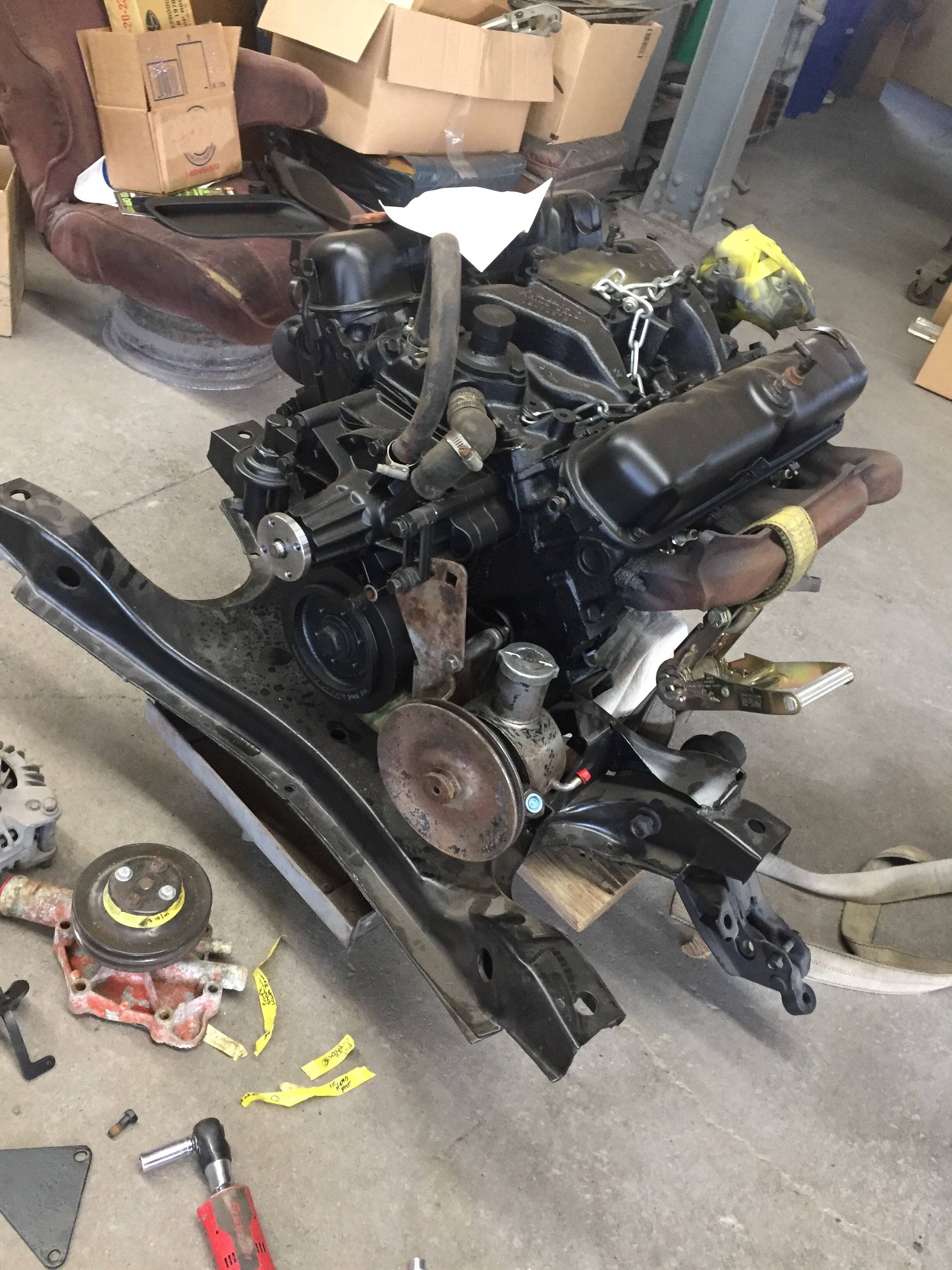

Thank you for allowing me to join your group. My son and I purchased a 72 Challenger Ralleye several years ago as a basket case without a motor & transmission. most of the parts were included. It was a 340 automatic car and we were fortunate enough to find a local owner of a 340 that was willing to sell it to us. Our dilemma is that we don't have any information of how the pulleys and belts are located on the front of the engine. We do have a power steering pump and brackets but that's about it. This is an AC car and we have found some images of some locations of alternator, compressor and so forth but none of the brackets and locations. Any help would be appreciated. Thanks again for any help you make supply and again for letting me join the group.

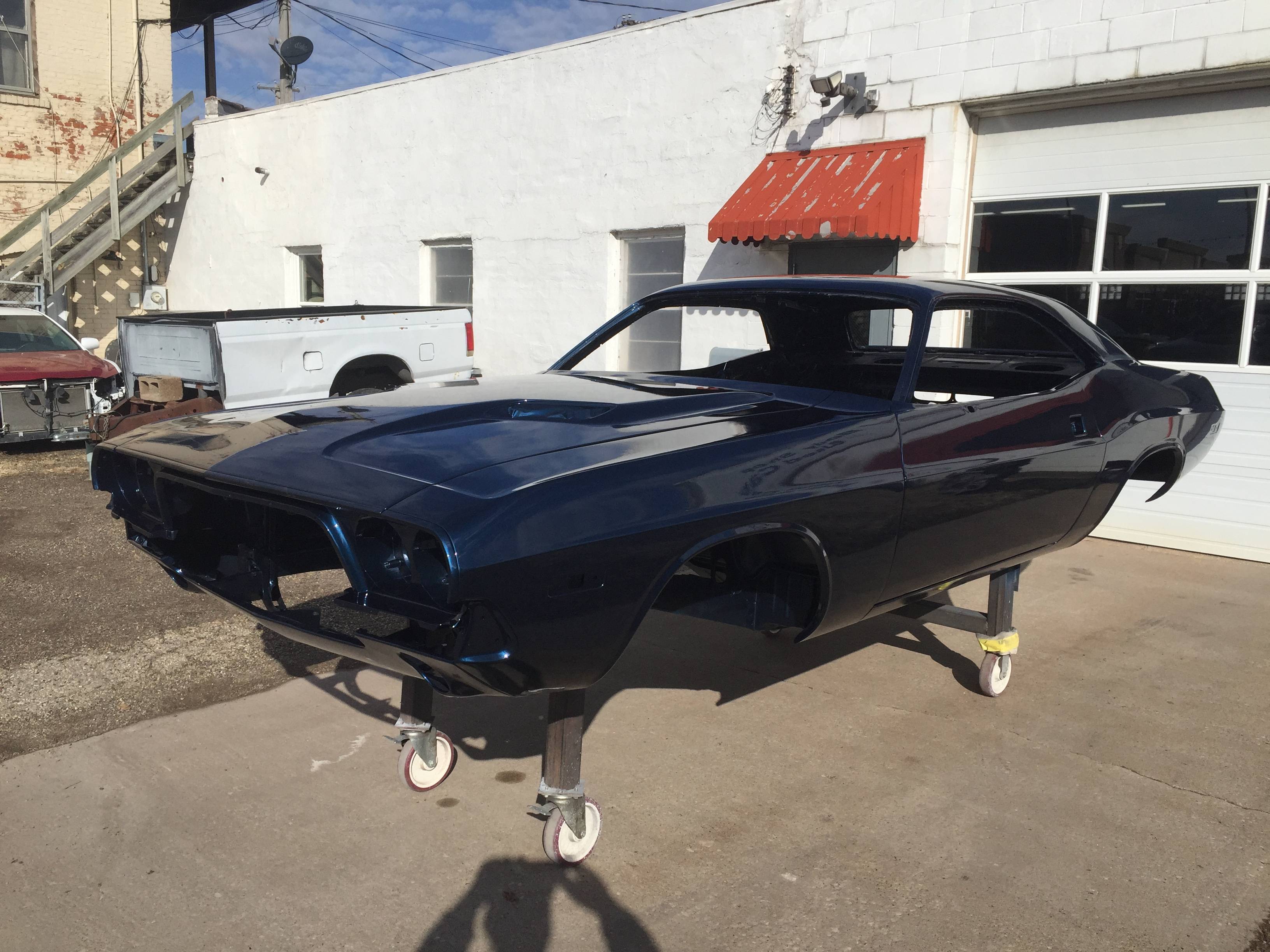

Welcome to the site !
I love the blue color on the body !

Welcome to the site from Arkansas! The body look great from here.

I want to know what that color is!! Looks awesome!!]
