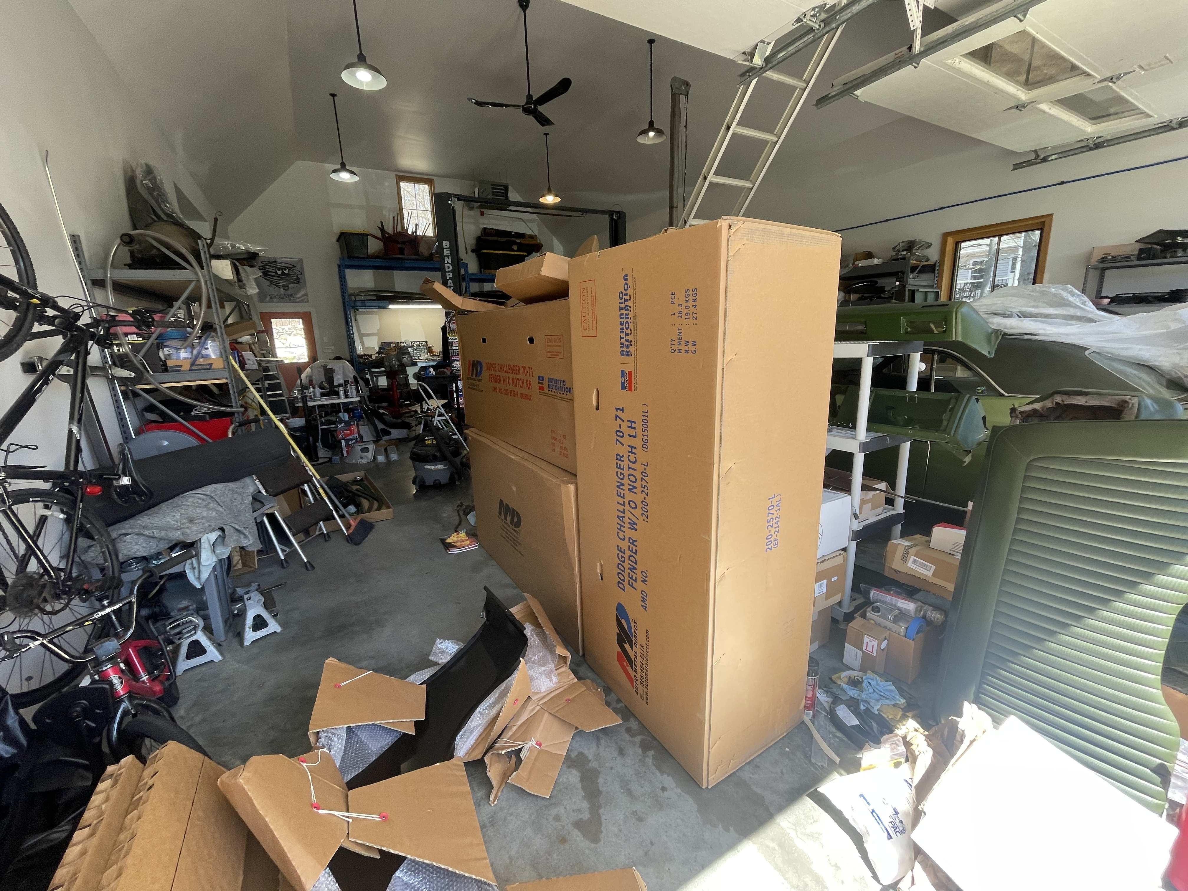

AMD panel shipment from last week. I've since put the parts in my storage spot and cleaned up the garage. The LH quarter was damaged in shipping but AMD took care of it and has another one on the way. Great people to deal with.

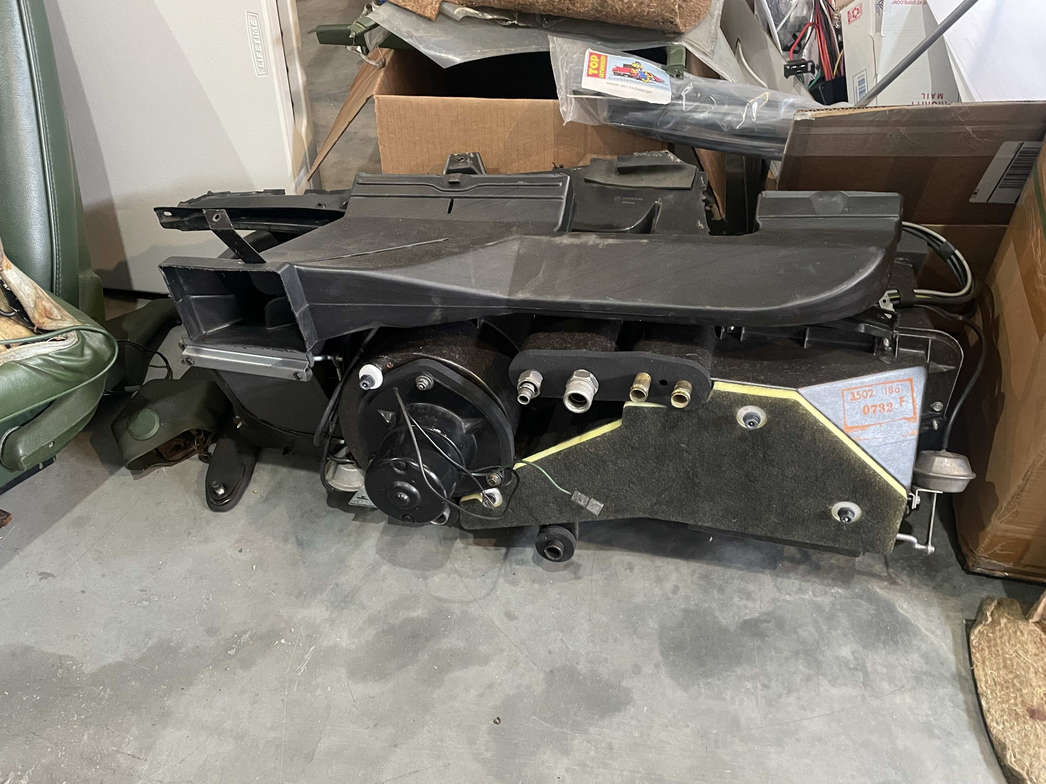

Restored a/c heater box using a DMT kit. Good stuff.

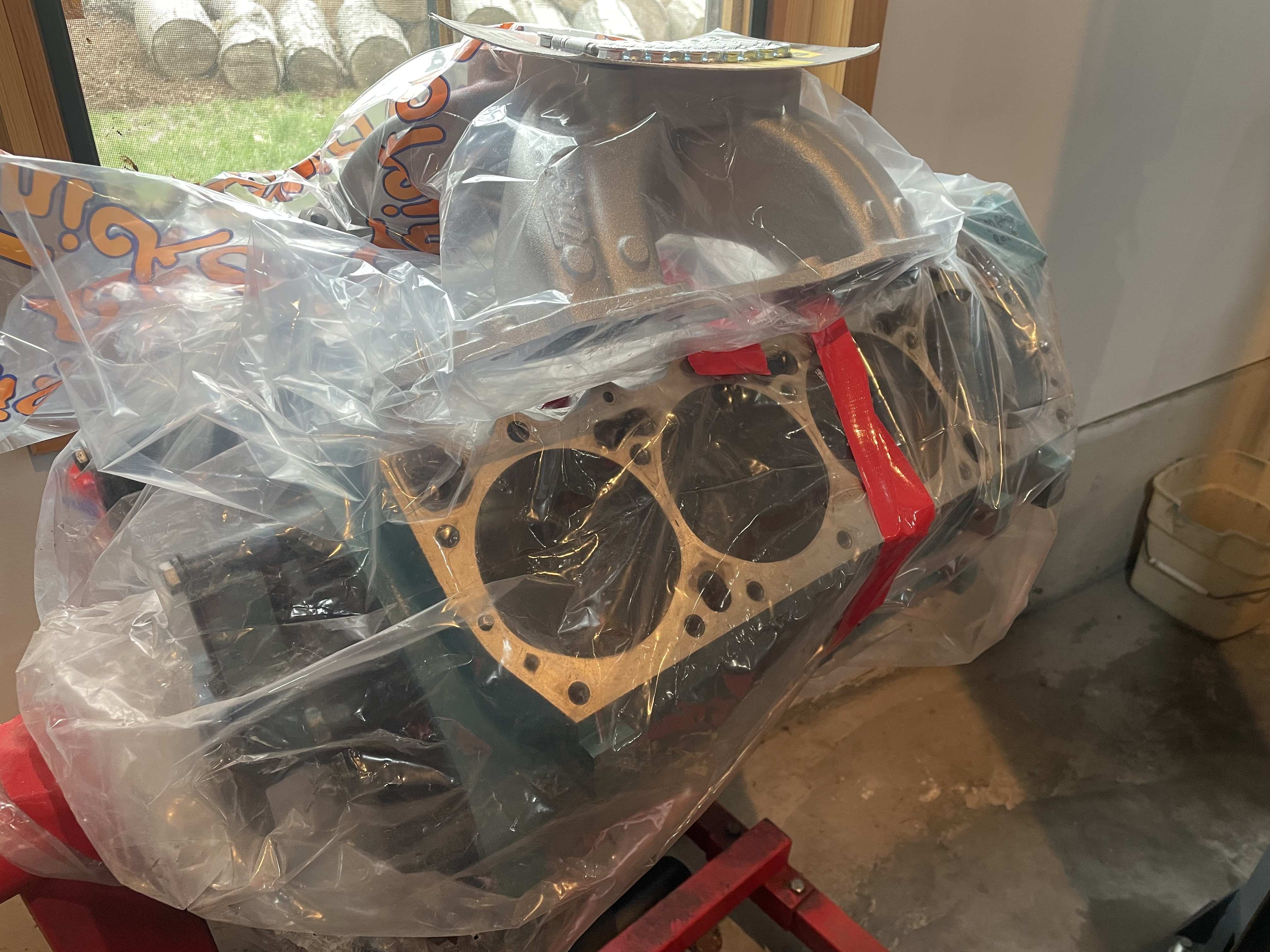

Here's the low deck 470" stroker waiting in the wings. Has a Scat ultralight crank and 10:1 Diamond pistons. Will be getting Trick Flow 240 heads.
