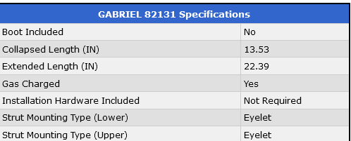

The spring have an arch and carry the weight.The shocks are not designed to. Hence shock.Rockauto screen shot.

If the shocks only have 1" of upward travel then the shocks you have are too long , as above measure the extended & collapsed distance & find a shock that has that range .
